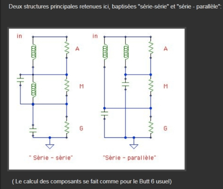

That's true with the 2nd, 3rd and 4rd crossovers, but not with the 1st order, according to V. Dickason's "Loudspeaker CookBook". And my Serial-// planned crossover belongs to that category, at least by its calculations :

The series-series is generally referred to as a "LINKED" series 3way, and the series-parallel is referred to as "CASCADED", however, yours is the first I've seen where the midrange cap goes straight to ground instead of the bridge line between the mid and woofer.That's true with the 2nd, 3rd and 4rd crossovers, but not with the 1st order, according to V. Dickason's "Loudspeaker CookBook". And my Serial-// planned crossover belongs to that category, at least by its calculations :

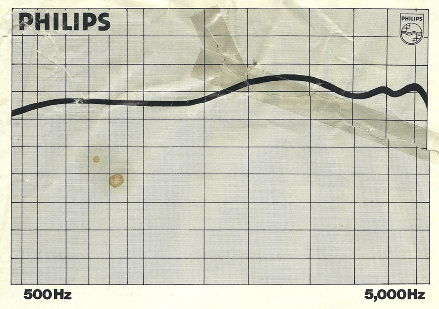

@Mister Audio The Philips mid domes are very good. The ITT models were similar. They sounded very detailed and capable of higher end performance used by some well known companies.
I have a pair of 4 ohm Philips felt domes and a pair of the AD Philips tweeters. I plan on an OLD 3way at some point...
I love those old Philips mid domes. Somewhere l have the Philips book on their drivers and how to build loudspeakers

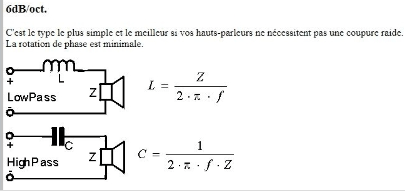

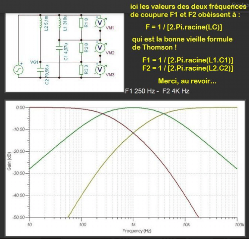

I call it 612SP - why not ? 😉 - hence 6dB to 12dB/Oct. Serie-Parallel. There's not much accessible litterature on such crossovers, though... I know several, well-documented but written in French, and this one, very interesting, in English : https://sound-au.com/parallel-series.htm

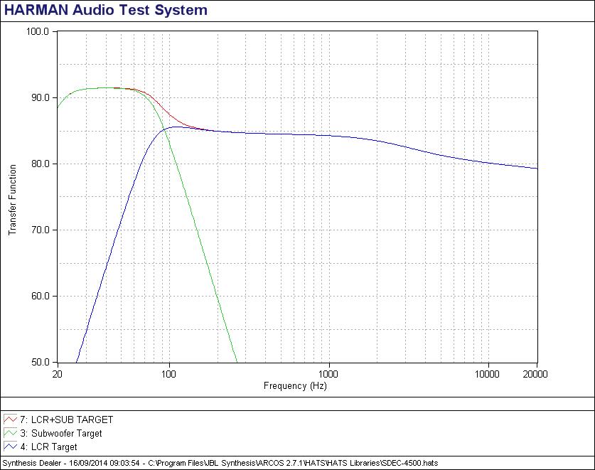

The Harman curve doesn't sound right in many instances, specifically from 1k on up.

Harman uses dome midranges at/above 100Hz?! 😳
