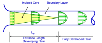

(my preferred one, even if I can only explain it in very simple words, as I am absoultely no expert in the complex aerodynamics/fluid flow field)in most papers and articles there are aerodynamic references to "fluid flow through circular tubes" and related concepts of laminar flow reynold number limit and flow/pressure development and related losses in tubes.
just for reference, here is an image from "aerodynamics for students", this is not related to bass reflex ports:
it shows the concept of fluid flow through a tube.
the medium is being pushed through the tube by pressure on the left tube entry side.
the boundary layer is occupying the whole tube surface after the entrance length. big velocity/pressure differences related to boundary layer are one (or the) main reason for turbulent flow. thick boundary layer leads to big turbulences.
there are three main and very substancial issues I have with the reference of helmholtz ports to fluid flow in tubes:
- the somewhat intuitive assumption that the driver pushes air out through the vent, similar to blowing air throuh a pipe (as shown above) is only true for frequencies substancially below helmholtz resonance, in the frequency range where driver and port output cancel eachother. I found this "intuitive assumption" even in quite scientific articles.
- the oscillating air flow in the resonator port is not induced by a static presssure from outside the port. the resonance does not need much energy from "outside" (or inside the box). The air in the port will even continue to oscillate (resonate) for a few cycles after the excitation has stopped. there is no "entrance lenght" and I suspect the boundary layer is very thin and may eventually even be "lubricated" by microscopic turbulence.
- at the peak output frequency (helmholtz frequency) the air flow in the port is COUNTERACTING the pressure in the enclosure. for an ideal lossles bass reflex speaker the force induced by the oscillating air in the port via the compliance of the box volume air would be so strong to counteract the driver diaphragm from moving at all. taking the image above as reference, the "inviscid core" would be inverted or rather fill the entire port.
[salvatti/devantier/button 2002][...] the Reynolds number can be much higher if the pipe has flared ends or smooth walls, [...] A practical upper limit for the Reynolds numer obtainable in loudspeaker ports is on the order of 100 000.
But still the laminar/turbulent flow principle, while perfectly reasonable for static fluid flow in a tube seems to be applied to the minimum diameter dimensioning and used as explanation for losses in ports.
It shouldn't!

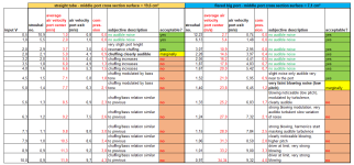

I just remembered that I did a test regarding losses due to boundary layer at port surface, see post #498.
I made two test ports with identical "throat" and "mouth" cross section surfaces.
One is round, thus has the least port wall boundary layer contact surface (middle area with 20 mm diameter; port called "small 3d printed port").
The other one is rectangular with a very thin and wide cross section (6*53 mm in the middle area), thus very big boundary layer contact surface ("flat port with flanged height").
considering the "fluid flow through a pipe" concept and the potential losses at the port wall surfaces the round port would clearly be much less lossy than the wide rectangular port. But in fact it's even the other way around!
this seems to confirm the very thin boundary layer and related losses.
(please note that the tube port had a small roundover at the interior end as well, but it's not shown here in the plan)
here are the results in the adapted table, now with middle section air velocities and compression:
and, to better relate the compression to middle section air velocities, a coparison graph showing compression vs. middle section air velocity:
while the increased air velocity is of course related to compression, there is no direct relation for the middle section air velocities of tube port and flange port.
the flanged port does not compress up to middle air velocities of 11 m/s, the tube port starts compressing at 3,7 m/s middle section air velocity.
It seems obvious to me that the compression is NOT related directly to the middle section airspeed, otherwise the two graphs would be near eachother.
instead it is mostly dependent on the transistion between velocity air movement to air pressurization. that is: at the port terminations.
of course it will most likely still be relevant to keep the middle section air velocities low, but the main focus of port development should remain at the terminations.
