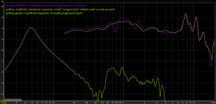

Port frequency responses - port resonance/enclosure resonance transmission behaviour
These graphs include a gated midfield (25 cm distance from driver) and a port nearfield response measurement.please keep in mind that for the front mounted ports there is some driver output bleeding into the port nearfield measurement!
I also included a midfield sealed enclosure (all ports closed) measurement in the first and 6th image, and in most other graphs the tube port measurement, as reference.
for the big port (which is the one I will use, due to the best chuffing/compression behaviour) I tried out several mounting versions.
here is an overview:
please note that the "mass loaded TL" version is just a crude and dirty quick trial setup. This would of course require simulation, adapting the line shape and driver/port positioning for reducing the line length resonance!
1) tube port mounted on the front baffle (see post #466 for a plan showing two ports, one of which was closed for the measurement) and sealed enclodsure:
the midrange is strongly disturbed by port resonance and transmission of internal enclosure resonances.
the tube has a highly resonant diameter/length relation (5 cm/19 cm) and geometry and a big constant diameter transmitting internal resonance peaks.
this behaviour led to this whole thread!
2) small port on the front baffle:
nearly no resonance peaks.
the small central port cross section seems to restrict transmission of enclosure resonances.
the very small lenght (net 4,2 cm) also compared to central diameter (2 cm) reduces the port resonance tendency. the resonance would happen somewhere below 4 kHz, there is barely anything there.
the only massive downside is the bad compression and flor separation behaviour, unfortunately!
3) medium port on the front baffle:
there is a 1,6 kHz peak around 12-14 dB below driver output, which corresponds to enclosure width AND effective port lenght, disturbing the combined output.
this peak is not as strong as the tube port resonance, of course!
4) big port on the front baffle:
again, a 1,6 kHz peak corresponding to enclosure width AND effective port lenght, is slightly disturbing the combined output.

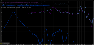

5) big port on the top back side:
there is less output bleeding from driver to port, therefore the internal height resonance with it's pressure peak at the top is now clearly visible.
it's still not entirelly clear to me why this peak seems to be non-existent at the front mounted port.
EDIT: it might have to do with the driver-port exit distance. that is 30 cm with the back top mounted port!
the resonance peak however is nearly 20 dB below driver output and because it's mounted on the back does not interfere much with the driver output, thus it seemed quite acceptable, so here is the comparison to the sealed version:
