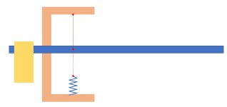

Hi everyone here. I just found this thread and was impressed by all the hard work you did. I must admit I haven't read all 1500+ posts, and maybe my question has been already answered, but I'll ask it anyway: Why all the effort of dealing with magnets? The role of the attracting magnets is to keep a vertical fishing line under tension. Why can't this be achieved using a spring???
Because magnets are much more charming!
Your drawing is very good because it shows all problems arising from this idea.
Lack of precise positioning, an own resonant frequency...
I have made for myself a clone of the Original TA and I do not have all the mentioned problems such as lack of precise positioning, own resonants frequency. Regarding the resonant frequency, every TA has its own depending on the material of the TA s wand and type of construction as well. I would dare to say that magnets work in a pretty different way comparing to the AM system with spring and is not a matter of charming at all.

In fact I think the magnets solution was preferred not because their charm, but because it allows the magnet end of the string rotate freely, thus helping the anti-skating function of the string. A wire rigidly mounted at both ends (the spring can ultimately be removed altogether) makes the wire much stiffer in terms of torsion.
Unipivot, yes. Repelling, no. The TA is suspended by attraction to the top magnet and attracted by a bottom magnet just as much as needed to maintain a correct azimuth. It's genius idea. No friction, no bearing chatter, just free movement! I had a close look at the few YT movies covering this TA and I think the anti-skating is also magnetic, although in one of the movies one dealer claimed anti-skating is done by the audio cables, which is laughable for a $20K TA

My dear, I understand your concern and theoretically, at least, you are absolutely correct. BUT! In real life, engineering design in general, and tonearm design specifically, is an endless chain of approximations and tradeoffs, the most obvious being the huge 2.5 degrees tracking error of the pivoted tonearms.The tonearm rolls on the upper bearing when vertically moving.
Not good.
My engineering background doesn't allow me to buy into hypes, no matter if positive or negative, before crunching the numbers.
And here are the numbers. The roll you mentioned is a mere 0.05mm. Please keep in mind that the width of our hair is more than double at 0.12mm!
And to be honest, I doubt that even a high end turntable setup by trained professionals using the manufacturer's protractor could attain such precision of the spindle-pivot distance in the first place!
Of course the drawing is not to scale and hugely exaggerated in order to make that roll visible.
