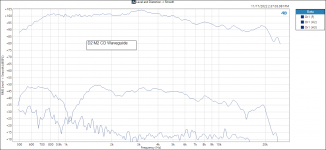

Real data.
See the attached plots for data a 1 foot distance from driver both at calibrated 100dB. This is about 90dB at 8 feet away from the speaker, kinda a medium loud listening level.
JBL2123H in 0.67 cubic foot test enclosure.
CD is JBL D2 as used in M2 speaker
WG is JBL for speaker STX825 (Progressive Transition 90 x 50)
https://reconingspeakers.com/products-page/jbl-horn-lens-5006815-stx825/
Note that the cone driver and CD/WG have different ratios of 2nd to 3rd HD's.

But correct me if I am wrong: we have quite similar THD levels, lower 3rd in CD, which is better.
And you need a HF driver (with its own distortions) for JBL. (And crossover in sensitive region)
In M2 WG it's a chance for even better results for CD?

You asked what Cd was being used with the JBL 2123.
I showed you the D2 plots in reply.
The D2 is a special case with 2 diaphragms, not a good example of classic CD Compression distortion.
The M2 is huge, too large to use with the JBL 2123. In my thoughts.
See attached plots for the D2/M2.

4th order electrical high pass at 500hz is good?Just for fun this the Faital Pro HF108r STH100 CD/WG.
Thanks DT
View attachment 1110620View attachment 1110621
Looks like you reposted the D2 M2 plots or vice versa no?Just for fun this the Faital Pro HF108r STH100 CD/WG.
