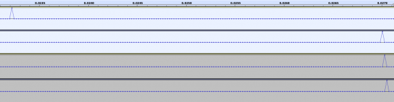

I tried the delay now and don't see any problem.@HenrikEnquist:
I think I've stumbled upon an unintended limitation. The step size on delay settings appears to be 0.1 ms, which unfortunately is too course. I discovered this because whenever I made small increments from 3.80 ms to 3.84 ms nothing would change in the REW impulse measurements, but when I changed it to 3.85 ms, REW suddenly showed a change from 3.80 ms to 3.90 ms. This limitation sadly means that I cannot time align my speaker drivers to the degree that I need.
Since 0.1 ms corresponds to a rather large offset distance of 3.4 cm, a step size of 0.01 ms is needed to allow for proper time alignment. I noticed that MiniDSP also allows for this granularity.
I used a mono signal with a single spike, and used a mixer to get 4 channels. Then I left one channel untouched, and delayed the others with 3.80, 3.82 and 3.84 ms.
All three delayed channels end up where they should:
Zooming in:
This was done at 44.1kHz, so the steps of 0.02 ms corresponds to a about one sample. The spike is delayed as expected.
