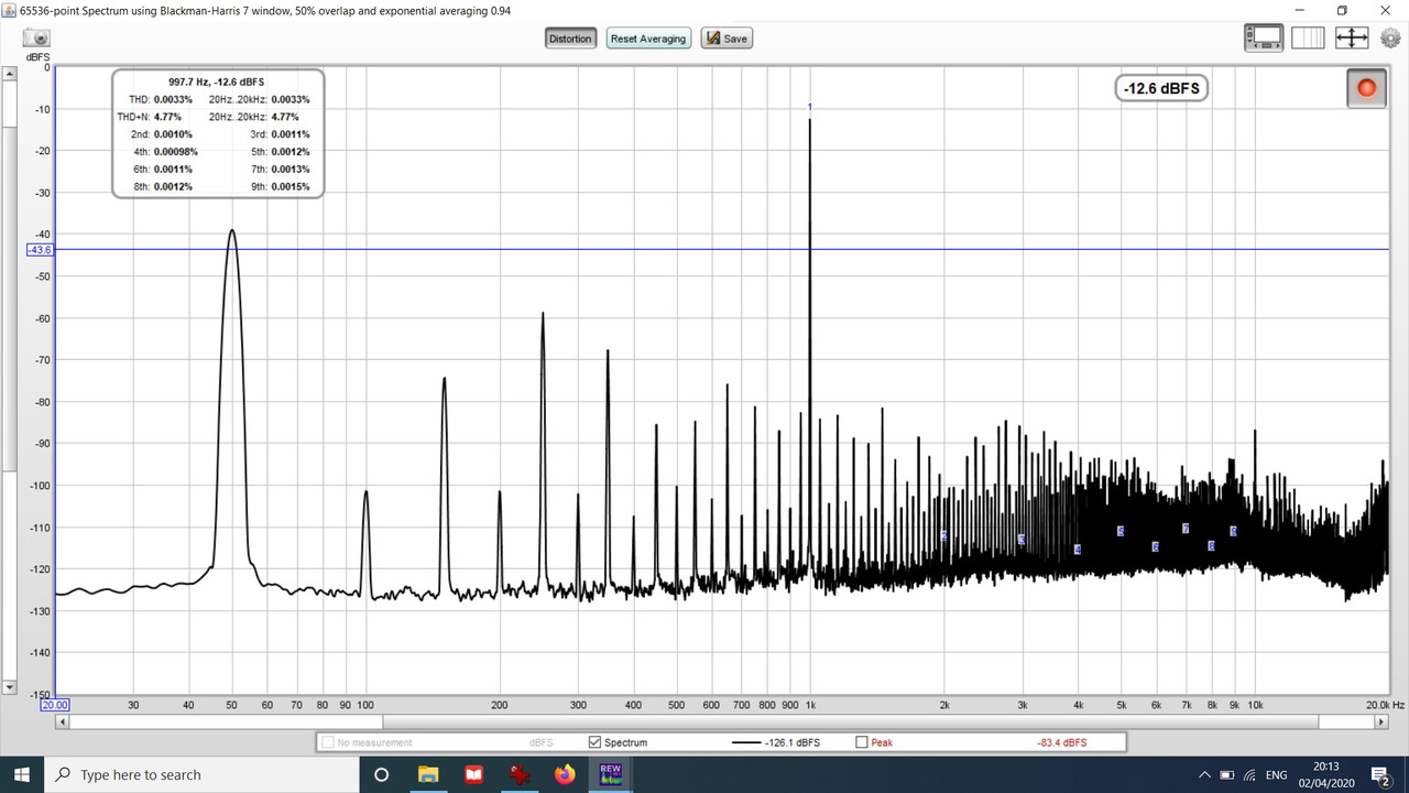

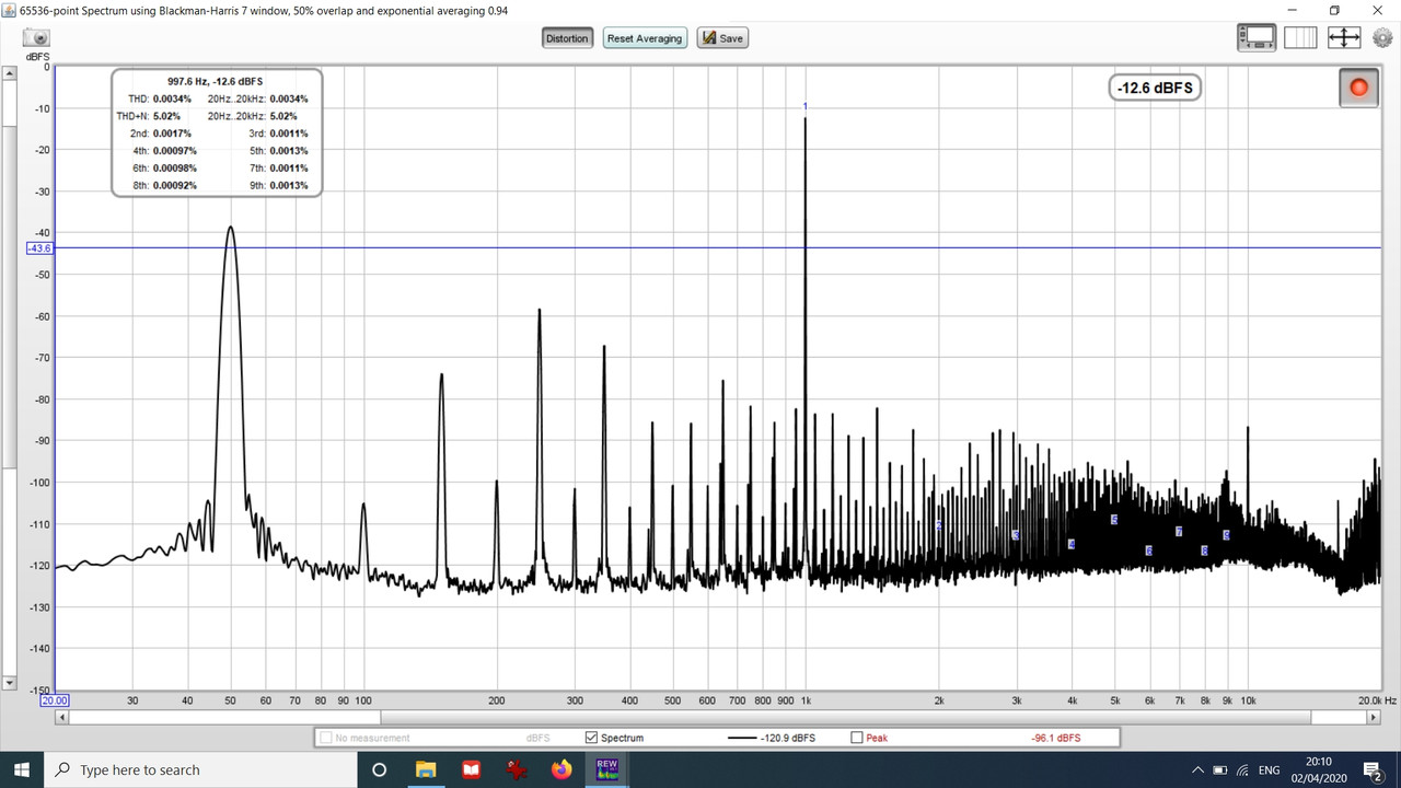

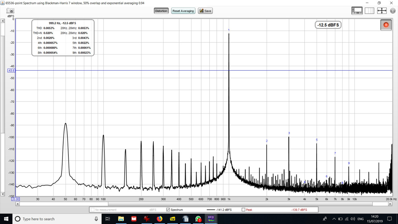

As promised:- THD + N for the TGM8 at 2.9V into 10R. Left and right channels:
For comparison here are the plots for my Mooly amp (which is a similar design):
I reckon that the high levels of power supply noise are because of the shared 0V connection for the power transformer centre tap and the speaker 0V.
