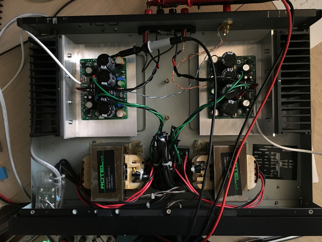

Finally got my TGM8 build restarted.
Not sure if anyone else had this issue... but just a warning for others:
It is IMPERATIVE that you use an insulating washer on the pcb top side for the power transistor screws. Otherwise you could have the problem I had. In my case the screw shorted to the VBE multipler and shorted the node R13/R17 to the heatsink (you can see a bit of exposed copper on the track where this happened).
I guess I was lucky that it didn't short the rail(s) to heatsink, although my current limited bench supply would have prevented any pyrotechnics!
Ayway, the boards are more or less done now. Iq stablity is very good, offset stability (with temp) is decent. I'll do some AC and disstortion testing soon.

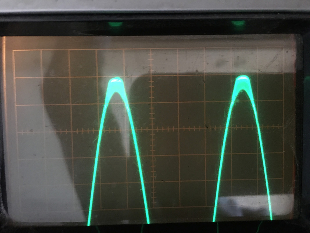

After a brief diversion to mend the power supply for my signal generator, I have now started testing the TGM8.
With my rail voltages I think the "helpers" are hindering!...
No load rail voltage is 40.9V.
With a 10R load I can see obvious clipping (and some hf oscillation on the positive peaks) at 20.7 VRMS. Which is about 29V pk @ 2.9A. The negative side clips at a bit higher voltage - which I suspect is due to the bootstrap current source.
20.7V RMS is 42W RMS into 10R.
With a 5R load I can see obvious clipping (and some hf oscillation on the positive peaks) at 17.7 VRMS. Which is about 25V pk @ 5A. The negative side clips at a bit higher voltage - which I suspect is due to the bootstrap current source.
17.7V RMS is 62W RMS into 5R. A bit feeble!
So where's all the rail efficiency being lost??
If we take the 5R case:
The 2SA1943 needs about 0.9V Vbe to do 5A. It also needs about 63mA of base current = 0.63V across R24.
So that means 1.5V across R20 which leads to 2.25V across R21.
At 5A the .33R resistor drops 1.65V.
Therefore we are losing about 5.5V (VCEsat of Q6 estimated at 0.1V).
My rail measurements were 33.3V on the + rail with about 1V of ripple at the conditions above. So at 25V peak we are losing about 8V... somewhat more than my calculation. I suspect this is due to the RMS measurements when converted to peak are in error due to the clipping.
I guess there is only about 2.25V more voltage swing available by removing the FETs and shorting R21. However I'm not convinced the FETs are doing much... with a gate voltage of 3.75V and a gate threshold (measured) of ~3.5V. I wonder if they are just starting to turn on at the peaks and are responsible for the oscillations?
My lowish supply rails and easy to drive speakers mean that the FETs are most likely redundant in my amp.
On a more positive note:
The amp is perfectly stable into all the capacitive loads I tried from 0.1u to 2.2u (even without parallel R)
Bias stability and output offset stability are fine.
Measured gain is 27.32.
Offset protection appears to work.
I've had it running at 10W into 10R for a while. Should be ready to listen soon
