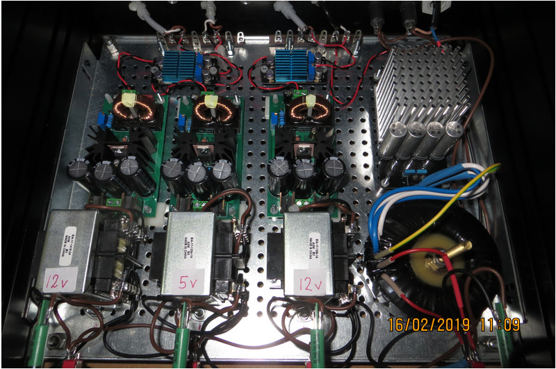

Hi.
Just finished my build, I have regulator on my Switch, 2 Dacs and my PC.
I have been listening on it for one week, and I can say the LT3045 regulators make a huge difference in my setup. Before I was quite happy with my LD1084V but the LT3045 is just way way better.
Now I can easily justify the price, as it brings so much more pleasure listening to my Dacs. I have a Topping D50 and a Chord 2Qute both perform way better with these Lt3045.
Best Regards
Michael
Best Regards
Michael

Very nice build. Thanks for the reaffirmation that the (Stammheim) LT3045 regulator boards are excellent. Should be so given the much better noise and PSRR figures of the LT3045 vs the LD1084, especially since the 1084 tops out quickly above 10kHz or so.
What are the various pieces in your build?
Den
Den
3 Times split bobbin Trafos + 3 Times LD1084V + a lot of mpaudio LT3045.. Best improvement on my Digital Setup ever.
So you added a large format HPLUN for the new toroid trafo, and added 2 small format HPLUN to the back of two LD1084 rails?
Yes, I'm powering my Switch (12v/4.7 watt), my amp Dac1 (5v/4.2 watt), my Dac2 (12v/6.8watt) from the two small HPLUN.
The PC is toroid and large 5 amp 12 volt HPLUN.
Playing right now, and I'm so happy with the sound. It really gave me a great step up in sound quality on both my Dac's.
The expensive investment in LT3045 is really worth it.
My suggestion is if you're on a tighter budget and would like to try them out, do a good LPS and try the smaller 1.5 amp HPLUN and decide yourself..
Best Regards Michael
