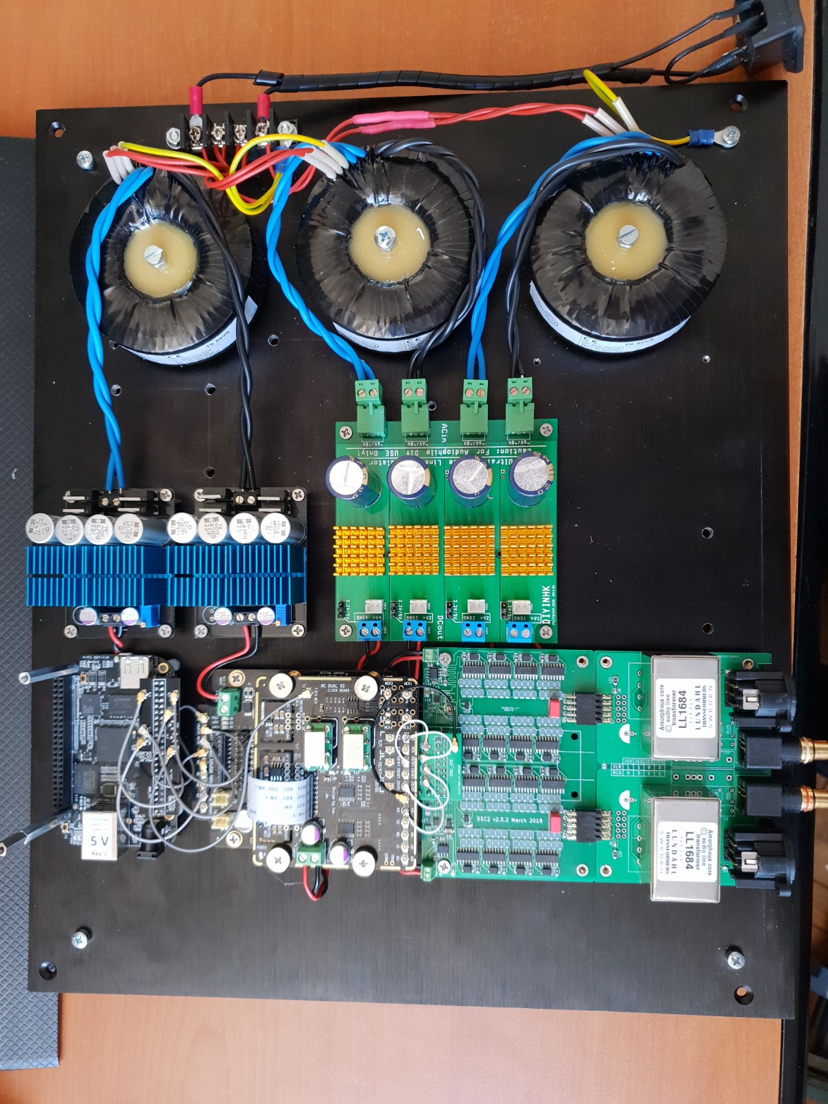

I bought two HPULN PSUs , which I use in my new DSD DAC. Sources have brought great improvement and I'm very pleased with the result. I plan to buy another source for the router🙂 Thank you , Michael .
Hi Vitalica,
Those inter connects between boards which look like they have snap ins look interesting, could you post source of supply?
Nice build by the way!

My first thought was: Wow, 250VA for a circuit that needs few hundreds mA only.
My second was: Were that exactly the same transformers with different power rate only or were there other aspects, that could give you an improved perception using that oversized transformer?
What I also thought about is, that most of commercial AVR's have a power rate twice of your preamp. But for supplying up to 11 amplifiers. That's also not a cut in your direction.
But hey, honestly:
We hear differences between several capacitors (that is NOT a cut on the previous topic!!!), no matter if they are in a signal path or in a power supply. Or differences between power or speaker cables. So why not using the 250VA transformer for a preamp for an improved perception.
Best regards
Stammheim
