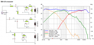

I have a hypothesis that the high frequency problem with this speaker may be due to the very low crossover frequency, which is also low sloped.
A 1-inch dome without a waveguide can not be connected to a 6-inch mid so that there is no difference in directivity, no matter how low you want to cross, but in this direction you can easily reach the limits of the tweeter's capabilities, which is not surprisingly their lower end, where the non-linearities are high without exception, producing harmonic and other distortions.
Maybe you can hear that too, plus an usual lower treble bloom in the power response due to low directivity of the tweeter in this region.
The Satori mid is good to 3kHz, so I think the crossing point would be much better between say 2.5-3kHz.
I write this without hearing this speaker, so treat this comment in this way.
Denes
I'd like to see those measurements, gated if possible. Also, i'd like to see measurements to at least 60 degrees off axis in 10 degree increments just to make sure the problem is diffraction. If that's the problem* it'll disappear off axis.
*Problem that is diffraction related with tweeters mounted on the flat baffle is usually dip on axis, not peak.
TG's simulation shows that obviously baffle effect and directivity of midrange have not been compensated - look at mid's response. In result, even on-axis response drops down just above 1kHz. Timing is propably ok because of tilted baffle.
Sadly I don't know how to fix that in a passive xo, but I guess that just smaller serial L3 value first, then different shunt?

I just analyzed this design using PCD ( I captured FRD and ZMA from Troels measurements) and there are two problems with this crossover:
1. 1600Hz is too low for the total (acoustical+electrical) transfer function
2. Even those this is a high bandwidth tweeter, the output must taper much more rapidly on the leading edge or distortion will rise dramatically (audible)
Therefore I agree with you, ~2,500 is great place to start and that is what I have been working on: 1st order electrical on the woofer, 3 order electrical on the tweeter.

I agree on general rules that you talk about...
BUT you have missed some important "details".
First SATORI TW29RN is not a 1" dome as first denibeni states but slightly bigger ring radiator.
Secondly it is almost 10db attenuated in crossover to mach the rest of drivers. So it never goes to its limits.
Third this crossover is not simple low order slope it is almost third order as notch filter makes slope steeper than its already second order.
Both JB and TG crossed it at similar point, so... :)

The problem with tonal balance might be that I think TG is quite optimistic about the tuned/published 87dB/2.83V.
Here is a third-party measurement of SB29NRX75-6. It is clear that the maximum sensitivity does not exceed 88dB anywhere on endless wall.
SB Acoustics measurements are not made on a proper endless wall, so there may be deviations from the data sheet.
So we can say that Troels calculated 1dB baffle-step compensation, which is not very realistic, even with a speaker of this size.
Or simply call this data room or placement dependent in this case.

Let's scrutinize that measurements to see where we're at.
If you look at 200Hz level and lower it's about 2dB hotter than 400Hz-1200Hz. In return, 400-1200Hz is also about 2dB hotter than 1200 and beyond.
What does this means ?
Since lower in frequency we go, we get less directivity untill the sound becomes omni, this means that the level of lower frequencies doesn't fall off axis as fast as it happens to higher frequencies. This makes 200Hz and lower to remain loud and becomes louder in regard to higher frequencies as you go off axis. That's where so much bass comes from. Midrange directivity is not constant also and it also falls off slower at lower frequencies in regard to higher. Same applies for the tweeter. All this leads to bass heavy, dark sound.
Now, you'd think that TG doesn't know what he's doing, right ? Wrong. It's not what he does but more where he does it. In Scandinavia wooden houses are quite usual, while in East Europe they are almost exclusively made out of brick and/or cinder block.
This kind of voicing is usual for lossy wooden walls that flex and absorb much of that energy down low or for a very large listening room. Put this speaker in a classic British or East Europen house/apartment made out of hard materials and add few walls in close proximity to the speakers and it will be mayhem with bass.
For frequency response that suites smaller rooms (under 30 sqm) made out of hard materials one should turn to Kef voicing. Not letting the woofer dig much lower than 35Hz is preferable. If you have really good listening room or just can afford to place the loudspeaker where ever you want in the room, then full 6dB baffle step design is the most you can afford to do, usually it gets to about 4dB. Troels did 8dB baffle step here and it shows on measurements and in listening also.
Looking at this measurement i could bet that Troels listened and tweaked this speakers in house with drywalls or wooden walls.
