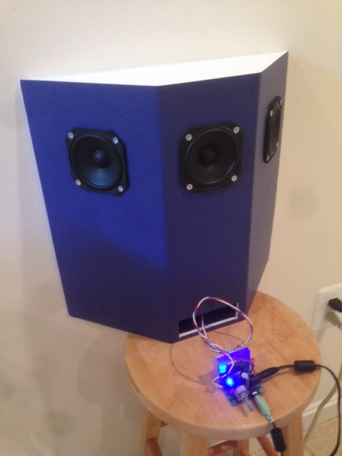

Mini Karlsonator (0.53X) with Dual TC9FDs
Karlsonator is a great kitchen speaker. For mono use a TDA8932 monoblock amp and take a Sanwu BT module stereo output and sum it with a poor man's summing junction: two 4k7 carbon resistors in a "Y". Take common from Y as input to monoblock amp. Works like a charm.
This will also play songs from micro SD or USB stick.

Yes xrk971, that's the kind of the setup I was thinking of. I wasn't happy with the sound of The TDA 8932 in my living room, but it might work in the kitchen. My ear prefers Class AB to D it seems. Wish there was a mono ver of TDA7297. Crazy that the BT module w/o amp costs more than the ones with built in amps. I'm still locked out of my aliexpress account after one order and can't figure how to get back in. I've chatted with them three times and it was always excruciating. After 30 minutes of dumb questions they'd tell me it was being forwarded up the chain and marked extremely important and would be fixed within 24 hours; then I'd never hear from them again. Awful. Luckily Sanwu has that exact board (HF36) on their site for less - $7. But it says BT 2.1. I'm going to keep looking. At least I get the idea now how to sum both channels.

I just tried out the "Stereo with a Single Speaker" topology from Elias using a pair of the 0.4x Karlsonators and a Nautaloss II for the center channel. I have to say I am very impressed by the sound quality and stereo imaging from "one speaker". For a quick proof of concept I thought using three existing small speakers arranged next to each other will let me know if this is worth pursuing with a dedicated box. Well it is... I am thinking of a large Karlsonator with 4 Vifa's: 2 front facing and two mounted side firing, all sharing a common driver chamber so there should be lots of bass.

It is a really quick experiment because all you need to do is hook up the speakers like the simple diagram and connect to a class A/B amp. Do not use a class D as they do not have a "common" for return line and you will short your class D amp's outputs.

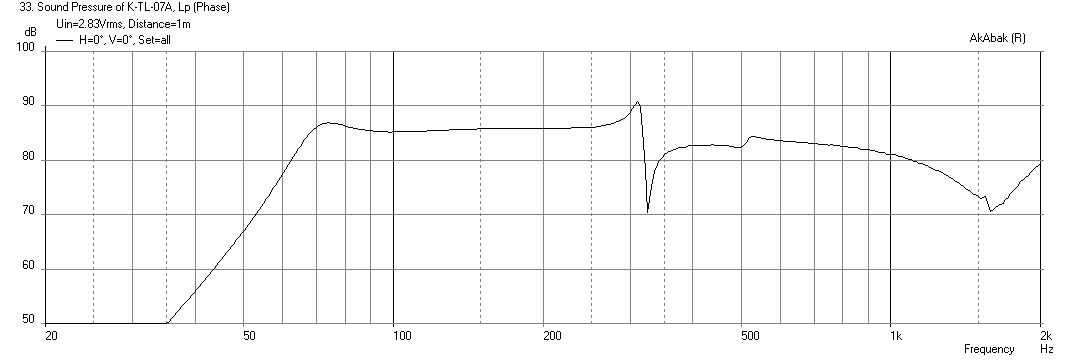

The sims show that a PS95-8 will work perfectly in an 0.40x scale Karlsonator if you have a single driver. If you want to try doubling up, put two in parallel drive in 0.53x Karlsonator.
XRK have you ever modeled a Fountek FE87? Parts Express has had this on "Buy Out" for a long time for $7.99. I put one in medium sized thick card board box with some Polly-Fill thrown in (totally guessing on everything) and it sounded pretty decent. Wondering if it would be a candidate for one of the mini-Karlsonators? I already have some foam board!

Thanks for confirming Jwarch. Did I run a simulation for you at some point or did you you just try it and it worked?
Edit: I did sim it over 2 years ago in post 1318. Forgot all about it.
474523d1427651730-mini-karlsonator-0-53x-dual-tc9fds-0.40x-karslonator-ps95-8-freq-1m.png
X, I know I saw your old sim when I read through the thread a while back. I had also seen other designs using the PS95's so I figured I'd give it a try. I'm powering them with a $9 TA2024 amp off fleabay. The imaging is great and they easily fill our living room. My wife was sad that I took them to work. 😉
