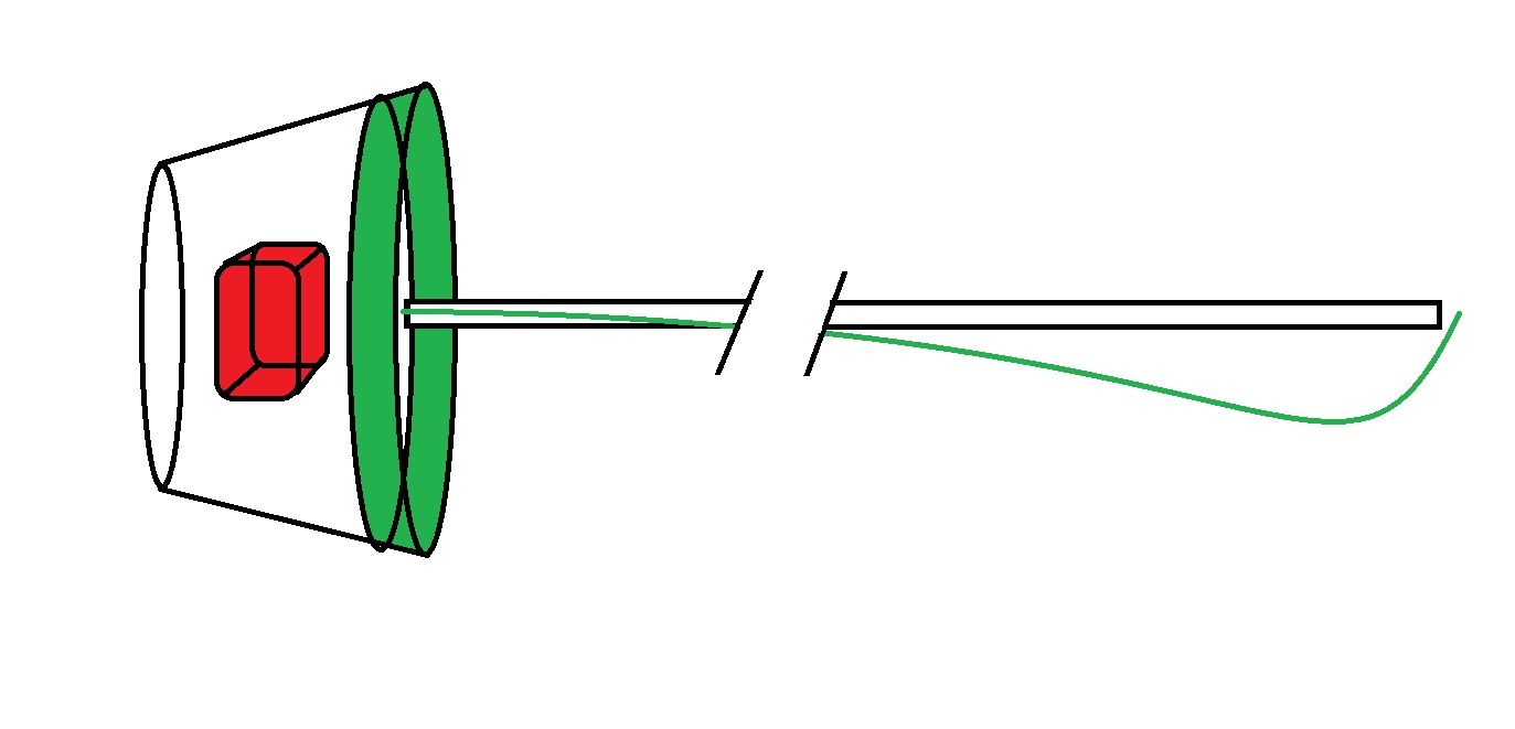

Here’s my idea for the horn plug (conceptual drawing).
This thing would be constructed out of 5052-H32 aluminum, or 304L stainless sheet. It’s basically a cone that I’d feed into the horn (deep towards the throat), using the reach-rod (aka 1” Schedule 40 steel pipe). Then using a hand air-pump, I’d inflate the "properly sized" tire tube (shown in green), via 1/4" air hose. This would “seal” the horn against the elements. The package in red would be desiccant – to adsorb any residual moisture in the throat – protecting the paper drivers from our obscenely wet western Washington State winters. I’d probably put some mini casters on the plug – so that I may roll it in easy.
In my backyard I’ve got birds, mice, rats (big rats thanks to people in my neighborhood not locking up their stupid animal feed. . . .) squirrels, raccoons, bobcat, cougar, deer, and black bear – and those are just the ones I’ve seen. (the bear I actually caught on my security camera. . . .)
My biggest fear (in addition to moisture damage) are animals nesting in my horns and chewing on my drivers - which I’m absolutely confident will happen if I don’t properly seal them off with a non-chewable metallic FME (Foreign Material Exclusion) plug. . . ..
Thoughts???
Yea. If it was my project, heat wouldn't concern me.I’m not necessarily worried about overheating drivers in my particular application. My question was intended to be more of a conceptual one.
As a welder, you could over-engineer the boxes by borrowing ideas from computer cooling - heat pipes connecting the drivers to massive finned heatsinks in the cabinets. Complete overkill, and probably 99% cosmetic, but since you enjoy engineering “art”*, it may appeal for visual reasons alone.

That seems like over-thinking, way more trouble than I'd go to 🙂
Thoughts???
If it was me, I'd opt for a fixed solution - I get annoyed when it takes time to power up my music.
Moisture:
1) some good pro drivers (e.g. Faital, see link) are advertised as water proof.
2) a mild slope would keep wind-driven rain from pooling in the throat (e.g. as shown for horn 3 from your post 149)
Mice etc:
a 'bug screen', a permanent fine wire barrier in the throat (e.g. vermin mesh).
Bears etc:
same thing, but bigger, such as a rebar grid halfway up the horn.
