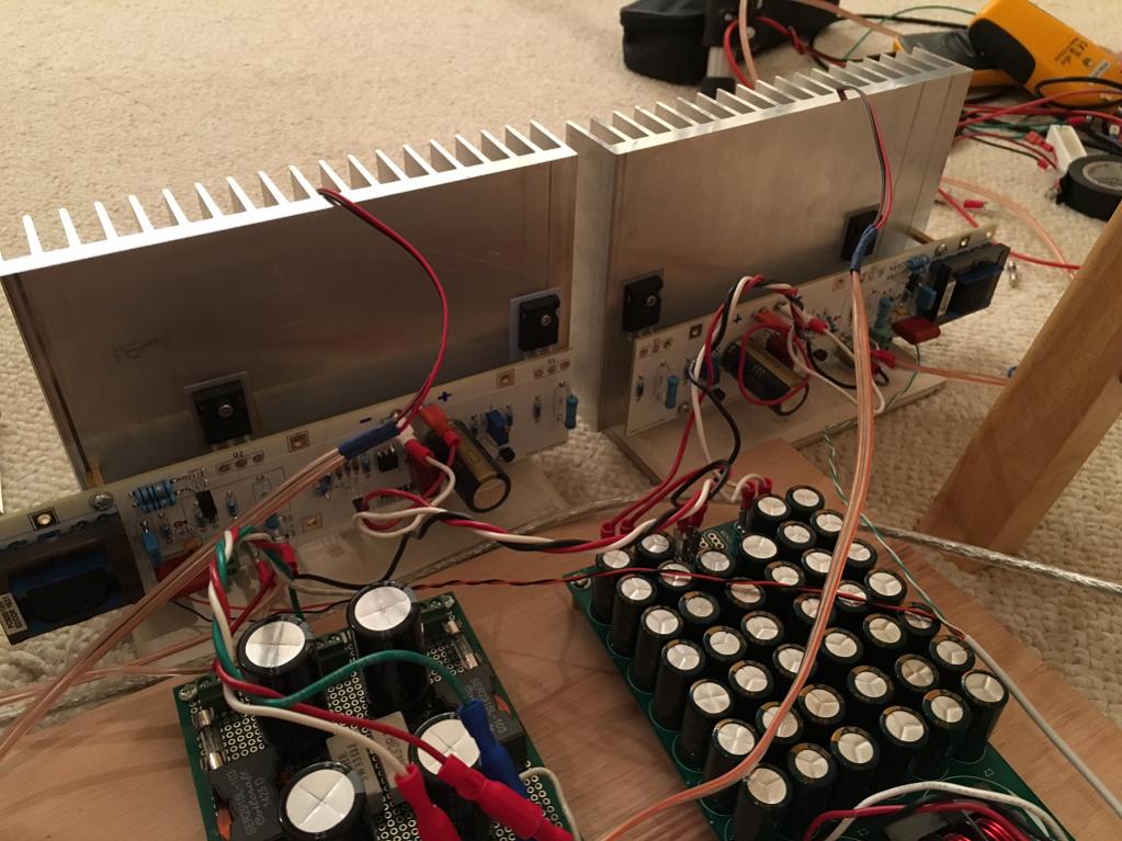

Completed pair of Teabag M2's:
It seems to be running at 1.3A bias current, and the neat thing was to see it start low, and rise fairly quickly once warmed up. I guess had I been listening I would have heard it go through class B, then class AB, then class A 🙂
Even with the 52.3k resistor on R7, I could not get the DC offset to zero out. It's bottoming out at -95mV. However, that's not going to stop me from listening.
I am using my existing PSU but with a new 400VA 18vac trafo which makes exactly 25.0vdc rails. Ripple is 56mV with CRCLC filter ending with 20mF of small 1k cap bank and about 29mF total per rail.
This amp puts out some heat on these slightly undersized heatsinks.
Still listening to it but sounds very good so far. Wish it had more gain 😀

Hi xrk. I don't suppose you could detail the heatsink size you have there? I just chopped a large heatsink from a solar inverter in half, and I'm trying to get a feel for if it's enough for a pass amp.
Thanks!
This is 7.28in wide x 5in tall extrusion, fins are 1in long and base plate is 0.375in thick. It's undersized so I augment with a small 60mm fan at half speed and it's fine. If heatsink was double this size, fully passive would be OK.
Here is the heatsink I used (cut to 5.0in long):
7.280" - HeatsinkUSA
