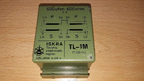

what you need is 600:15K (nominally) , which gives you voltage ratio of 1:5
with classic repeater (150 x 4 ,usually connected as 600ct:600ct ) , you can get max voltage ratio of 1:3 , if you use one 150R winding as primary , rest connected in series as secondary ...... with drekload of resulting problems
yup , I stand corrected - 1:4 , not 1:3 , as I wrote

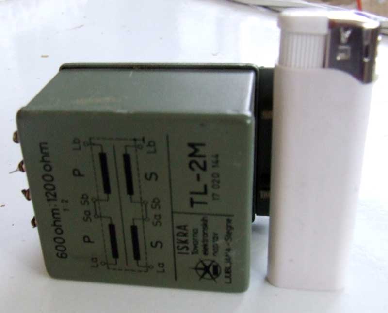

what you need is 600:15K (nominally) , which gives you voltage ratio of 1:6 , when connected as autoformer
with classic repeater (150 x 4 ,usually connected as 600ct:600ct ) , you can get max voltage ratio of 1:4 when connected as autoformer

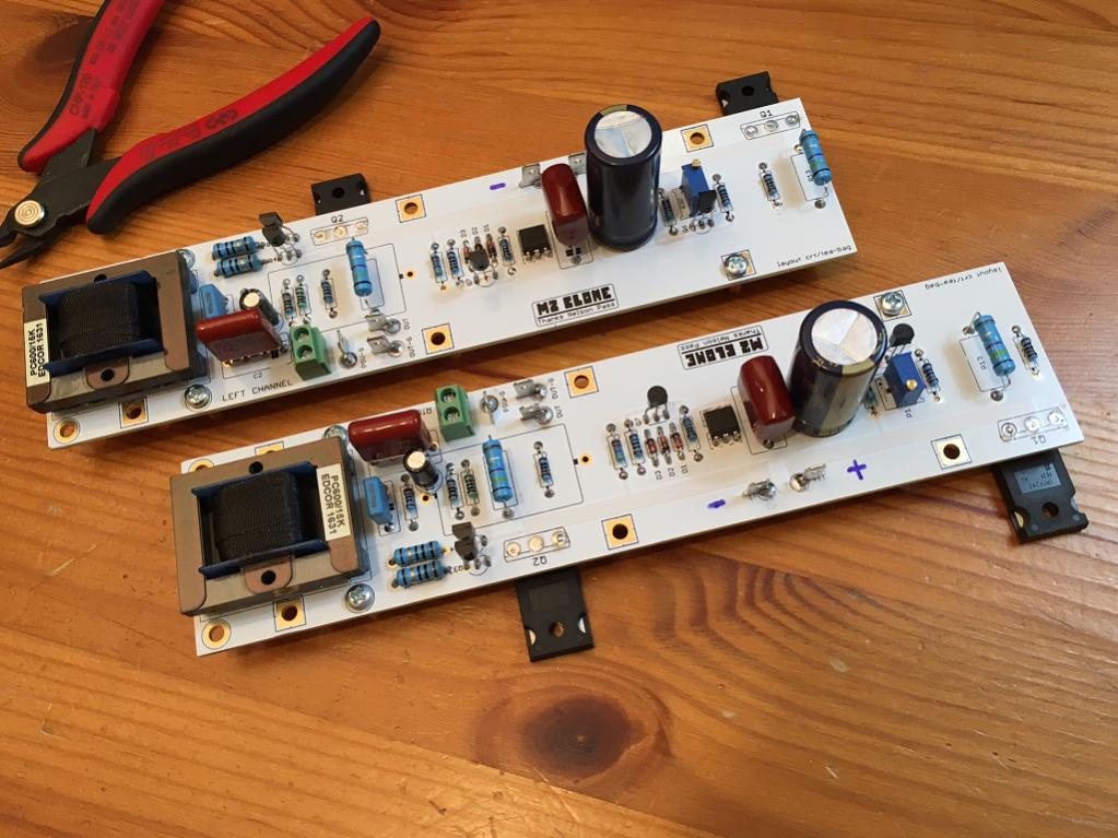

This amp was a joy to build. Simple simple simple compared to many of the class AB amps I have worked on.
Completed pair of Teabag M2's:

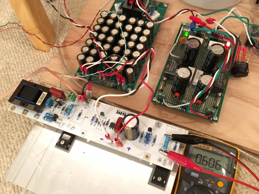

It seems to be running at 1.3A bias current, and the neat thing was to see it start low, and rise fairly quickly once warmed up. I guess had I been listening I would have heard it go through class B, then class AB, then class A 🙂
Even with the 52.3k resistor on R7, I could not get the DC offset to zero out. It's bottoming out at -95mV. However, that's not going to stop me from listening.
I am using my existing PSU but with a new 400VA 18vac trafo which makes exactly 25.0vdc rails. Ripple is 56mV with CRCLC filter ending with 20mF of small 1k cap bank and about 29mF total per rail.
This amp puts out some heat on these slightly undersized heatsinks.
Still listening to it but sounds very good so far. Wish it had more gain 😀
