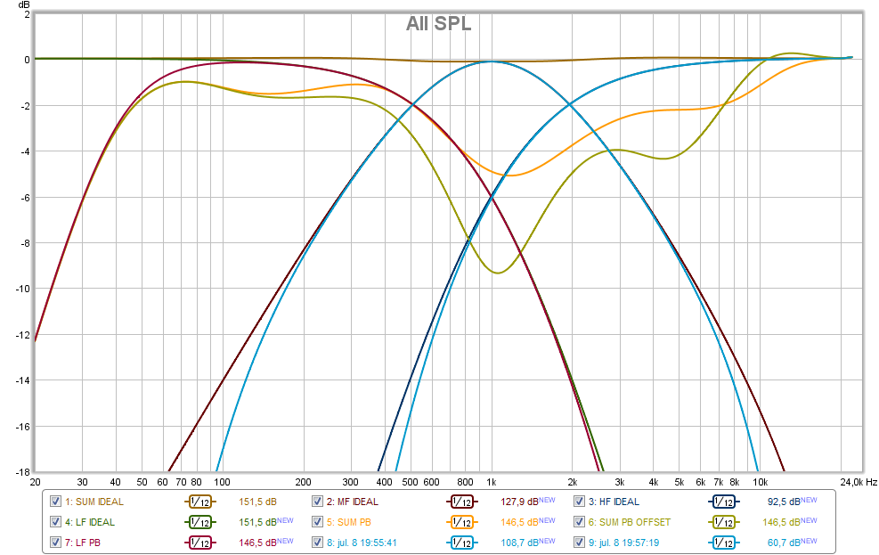

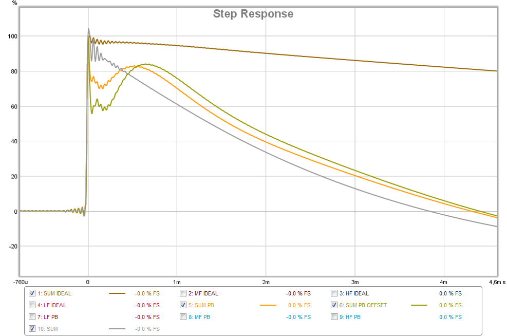

Moving the driver rolloffs to 350hz/1.5kHz so that the mid and tweeter only follow the target highpass slopes for 1 octave before steepening to 3rd/4th order:
It would seem that hitting the target slopes for 1.5+ octaves is quite important.
edit: Back to the 200hz/1khz driver rolloffs, I was able to fix things a little by changing the woofer lowpass to BW2 1.2kHz and the mid lowpass to 5kHz.
TMM thanks sharing interesting post and nice visual data,
More to the subject was started by PLB at post 133 where some pdf files is available http://www.diyaudio.com/forums/multi-way/88135-filler-driver-ala-b-o-14.html#post4383549. Had a run PLB's filters (linked below) thru my JRiver DSP with soundcard hardwire loopback and REW listening in between at post 139 http://www.diyaudio.com/forums/multi-way/88135-filler-driver-ala-b-o-14.html#post4383814.
Guess key is use John Kreskosky's spreadsheet to find slopes that suit ones drivers bandwidth best, then from spreadsheet at the three grey button export the three curves as frd file and import into measurement program used as overlays and hit those slopes in acoustic domain, probably by a handful or more IIR filters as helpers and a way to bring acoustic center in sync. Below screen capture example from spreadsheet and at post 24 GM shared a link to spreadsheet http://www.diyaudio.com/forums/multi-way/88135-filler-driver-ala-b-o-3.html#post4375989.
