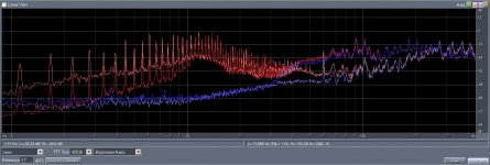

Spectrum analysis of my noisy old Rek-o-kut still showed 10Hz to be the strongest level. Rumble was below that in amplitude
What does the spectrum look like?
I've seen just a few examples on DIY, and this is typical:
Above is comparison of 16bit 44.1kHz treatment of master v rip of vinyl. The tracks are provided by PMA in his thread: http://www.diyaudio.com/forums/ever...-you-prefer-cd-vinyl-version.html#post4347337
It is obvious which plots are for vinyl and for cd.
Turn table fundamental results in intense spectrum of harmonics do to combination of off center disk with tone arm and cantilever resonances.
For me, describing this as rumble or low frequency noise, then thinking about adding suitable out-of-phase low-frequency noise will result in a listener preference for the processed track over the original is that it is not going to happen.
Obviously the stylus tip motion is modulated by the complex spectrum it is exposed to. This leads to modulation of stylus contact force. Tracking force changes can be very audible. Even with tracking force apparently optimized, surface noise becomes modulated with low frequency spectrum.
So with sub-sonic filter the brain is still receiving information that most likely cause groups of neurons to fire at some very low frequencies. The perceptual possibilities are vast.

In my prior post I used Cool Edit to generate spectrum picture. Too really see low frequency behavior of vinyl records, a very big FFT needs to be used, or down sample the ripped track to get better resolution with smaller FFT.
In picture, sample rate was changed from 44.1kHz to 882Hz, at low rate 65k FFT spans about 74 seconds.
