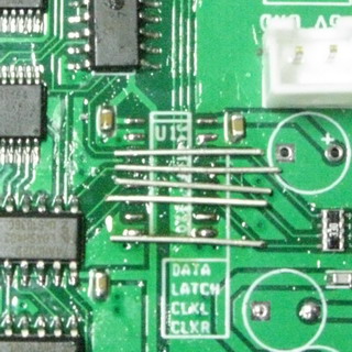

🙂🙂 Sorry, this is just so funny to read..... Btw, it looks like the clocking is an input though the isolators, are you aware of how much jitter an isolator chip introduce ? Don't sounds like you do....
DIYER can always remove the isolater easily and listen the different😀 (for modification it's always harder to add rather than remove) There are also unpopulated aux circuit / pads on the pcb for advance diyer to do customization🙂, but base on the feedback, most user prefer to use isolator
You still don't get it ?? Based on the available info (the picture) it looks like you do your "FIFO reclock" which remove maybe 10-100 pS of incoming jitter, then you add something like 350 pS jitter in the isolators....
You otherwise do reasonable stuff at good pricing, but on that one you need to find a better engineer....
This PCB is designed to be flexiable
If the user do not like the isolater, it can be easily removed like the below image😀
There are many way to play with it,
apart from bypass the isolator, user can also try different isolator,
NVE [FONT=Arial, Helvetica, sans-serif] IL700-Series Isolators jitter is told to be [/FONT]50ps
http://www.nve.com/newsletter/nve_newsletter--12-10.htm

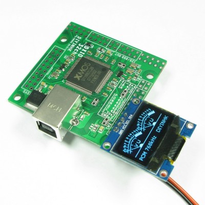

New XMOS Multichannel PCB
Dear friends,
A new xmos multichannel PCB is just released.
  • 4 layer PCB, Ultra low phase noise ndk audio oscillator
  • Upto 32 channels or 384kHz with different firmware
  • XMOS Xcore-200 XU216 with 2 Tiles 16 Cores upto 2000MIPS in dual issue mode.
The default firmware on the DXIO32ch support 8 channels 192kHz I2S input , 8 channel 192kHz I2S output, spdif output, OLED VU meter and volume up/down control button
Extreme diyer can use the onboard full size XSYS connector to program the xmos with their customized firmware to add more feature and function. (For programming support, please refer to the xmos official website and xcore.com for question about xmos programming, the PCB portmap is shown in the item image.)
The usb audio source code can be downloaded from xmos.com and the VU meter patch can be downloaded from xcore.com released under bsd license.
To compare, the xmos used in the stereo 384k USB I2S PCB is 500MIPS processing power. Our test shows that the OLED VU meter patch can degrade the audio quality if it is not used with the new 2000MIPS XMOS.
