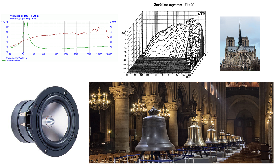

.....if Only some could send you : TI 100 - 8 Ohm .....
No more bells please 😡 or use as mid not tweeter duty.
Metal FR58EX and FR88EX will participate next round they seems much less resonators up there 😀
if i have money i will try it with a passive filter (I mean in front of the cone ! )... yes, + 10 db at 5.5 k is too much !
