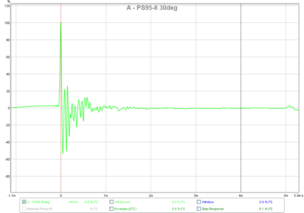

My secret surprise entrant was the Dayton PS95-8: a $24 alloy framed, paper coned, inverted surround, full range driver with a phase plug. It is a bit bright on-axis, so I did a passive "EQ" by pointing it 30 deg away from the mic to balance the response. It has received some votes and I think in general the votes seem to indicate that these are ALL great drivers and you can make a great sounding speaker with them.
Here are the measured frequency responses (4 ms gated and 1/48th oct smoothing, 10dB shifts to allow viewing):
Corresponding Impulse responses
PS95-8 at 30 deg off axis:

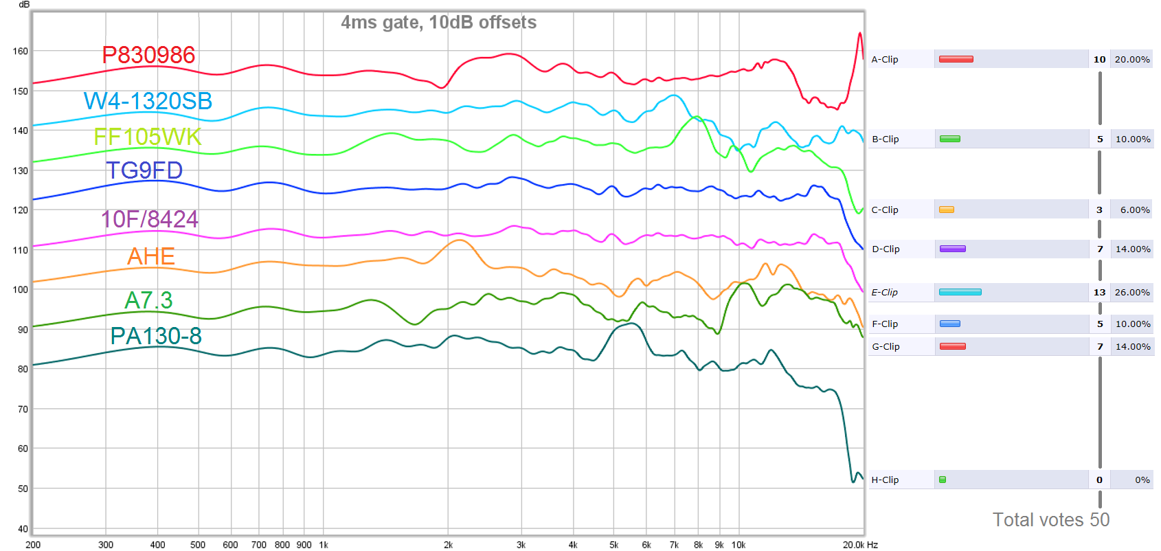

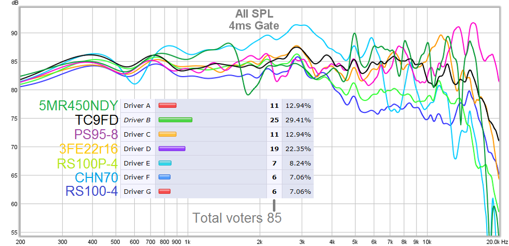

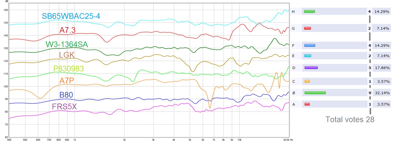

xrk971,
Thanks for fun interesting round to squeeze data from 🙂.
Below summary from all rounds it seems baffle/woofer-system from round 2 verse round 4 change how its F10 or TG9FD that win flattest frq response on axis, at round 2 10F was micro flatter than TG9FD but reversed here at round 4 .
Round 4:
Round 3:
Round 2:
Round 1:
Round 4:
Round 3:
Round 2:
Round 1:

Byrtt,
Thanks for the summary. The change from the trapezoidal baffle to the rectangular baffle used in Round 4 probably increased ripple due to diffraction effects. Diffraction should theoretically be less with trapezoid and that seems to pan out. The Nautaloss spiral sealed TL is also 3 feet long vs 12in long Dagger so there is more room and more volume for the drivers to "breathe" with the earlier rounds. Perhaps I need to go back to Nautaloss and trapezoid but keep woofer sealed with RS225 like in Round 3? That configuration is indeed much more flexible as it can accommodate 5in drivers.
