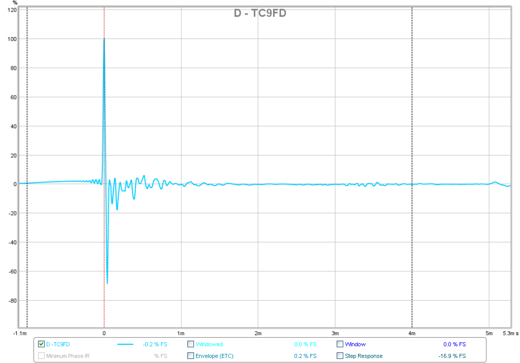

Lucky for me I prefer (by a large margin) the even cheaper TC9.
Impulse of PS95:
Impulse of TC9:
Combining this information with the fact that we "listened" to the PS95 at an off axis angle of 30 degree(!) is enough for me.

Although I picked the B80, I have a BIG smile on my face knowing that the TG9 has the flattest FR (since I've got them in several different systems I've built). The impulse response of the TC9 is quite good. What would be nice is to see non-linear distortion measurements at various levels. Thanks XRK for your efforts. It was a lot of fun.

That's one thing the reveal revealed. It thought the TC9 was much clearer than the TG9, and I was honestly surprised that those two were from the same family.
Impulse response is certainly cleaner. Do you happen to have the TG9 too? I'd really like to hear all these in real life, as I implied in my earlier post.
I don't have the TG9. I almost chose that one for my line arrays. But after investigating every comparison I could find online I relied on the fact that I always seem to come back to enjoying paper coned speakers. So I got 2 TC9's to test and the rest is history.
