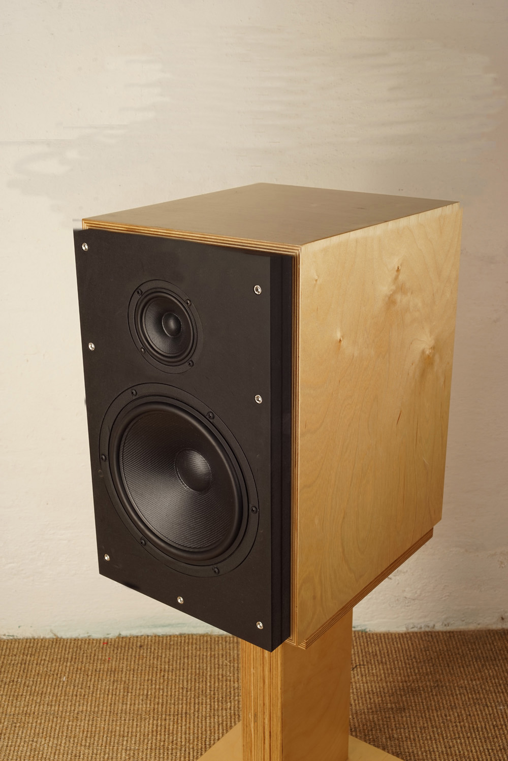

Ha ha ha - nice photoshop skills there Byrtt. I forgot all about that picture. It still looks good. Something about black MDF as a baffle material. That ATC look is timeless. 🙂
I may have to ask Jessman to make that box for me yet.

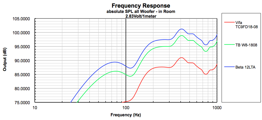

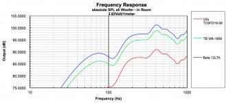

Here is the simulated response (using XLBaffle) on a 19"x19" baffle about 20" high (on top of H-frames). Looks like there's a natural rolloff just below 200Hz. This way I don't have to use any circuits - which I prefer whenever possible. The H-frames are connected to a typical sub amp and blended into the mains to taste. Everything sounds great.
If you look carefully the TC9's relatively high Qts of .89 adds a bit of a bump around 200Hz giving it a bit of a fuller sound than the other drivers. I've been swapping the Vifa, Tangband and Eminence 12LTA for months. They all sound very good. Clearly the Vifa at under $15 is the value leader and it's certainly not trounced by the other much more expensive drivers.
Much more expensive drivers may probably have much lower Qts. You cannot put them as is in an open baffle like the cheap Vifa.
You can and I do. But I recognize the advantage of higher Qts on open baffle when reaching for lower octaves. Remember, I'm using the baffle size to create the low frequency rolloff. Making the baffle 17"x17" creates a rolloff beginning around 250Hz. Smaller baffles produce higher rolloffs without concern of Qts.
Even doubling the size of these baffles will not produce more bass with the Eminence and TB. The higher Qts Vifa may extend a bit lower. Regardless, they all need bass support.
That's good, but you subject the full range driver to unnecessary cone movement in its attempts to create bass, which creates higher levels of distortion. It sounds a lot cleaner and more clear when hi passed filtered.

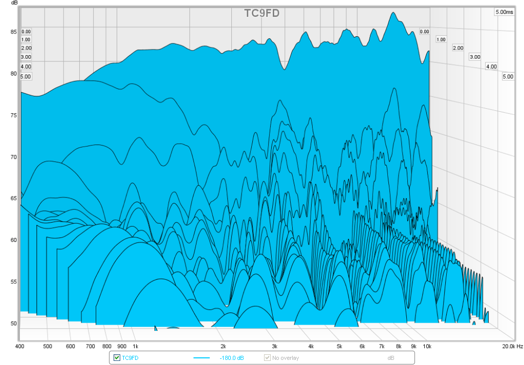

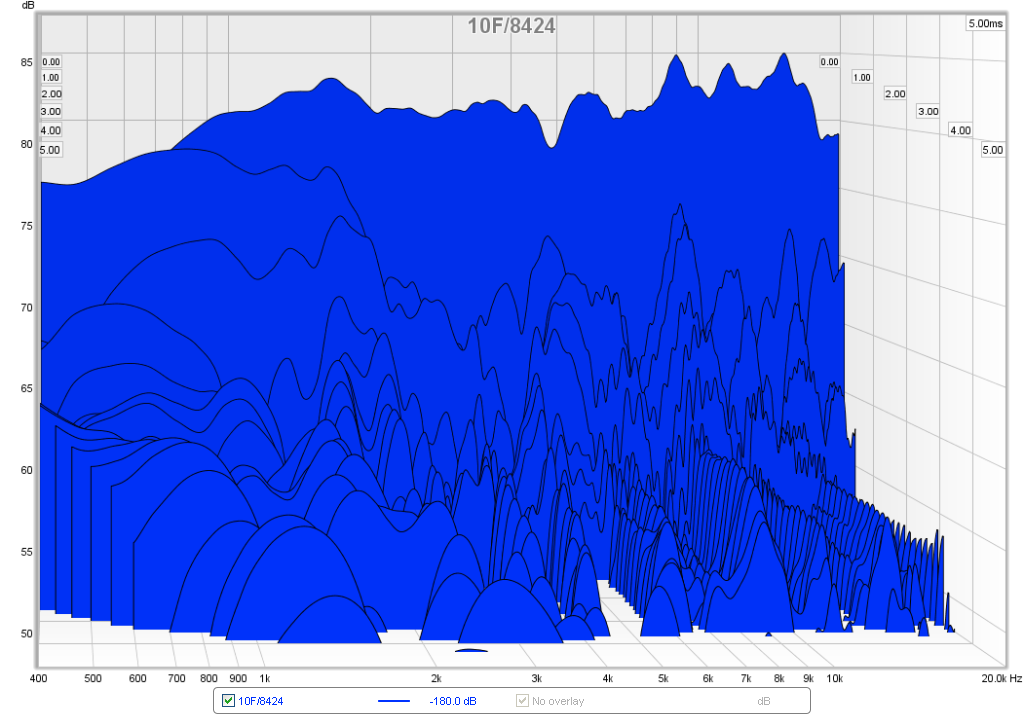

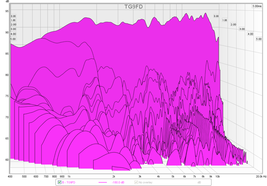

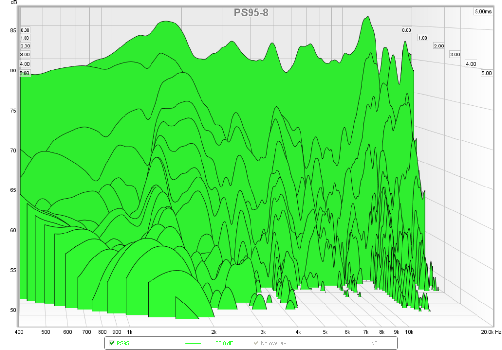

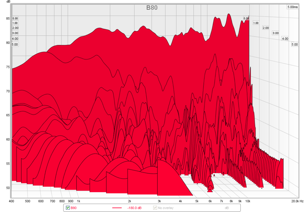

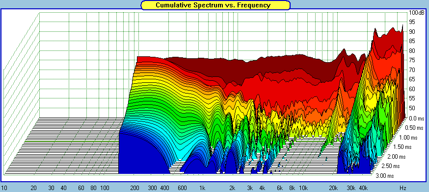

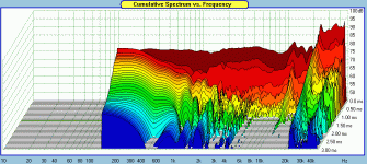

Waterfall Plots (CSD)
Here are the measured CSD plots for the drivers. Settings for the CSD are 31 slices, 5ms range, 5ms window, 0.1ms risetime.
PS95-8:
TG9FD:
TC9FD:
10F/8424:
B80:
The TC9FD looks pretty good.

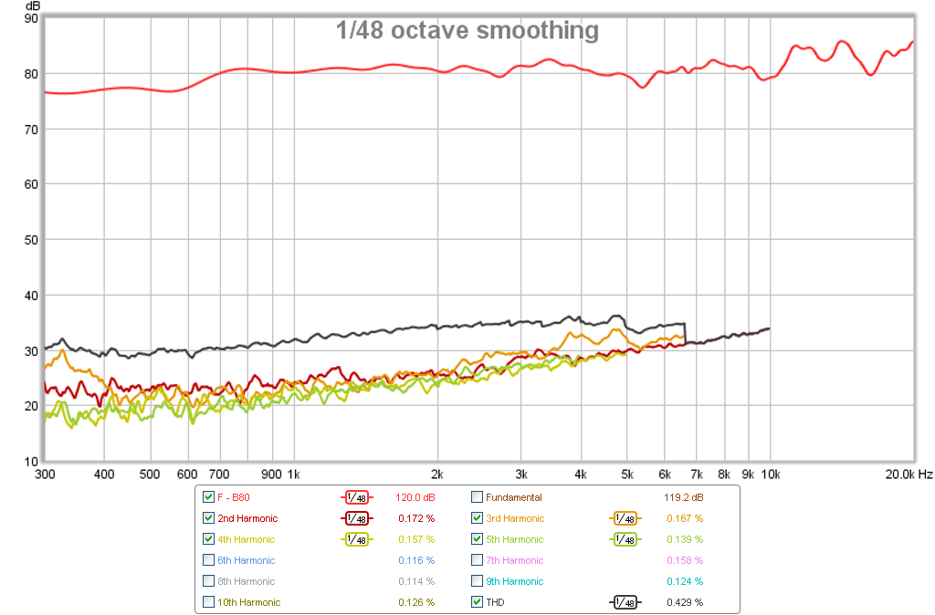

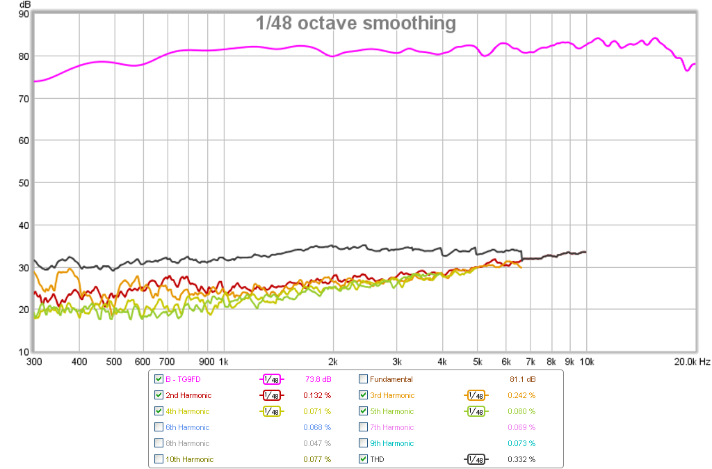

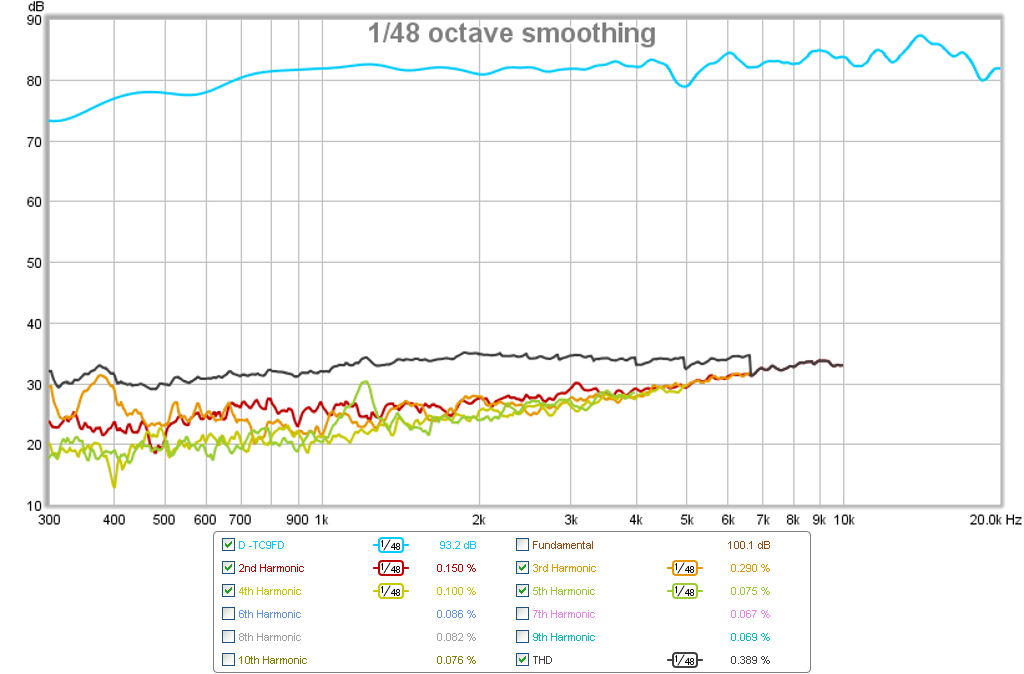

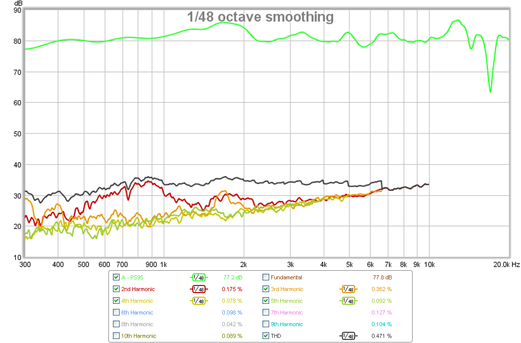

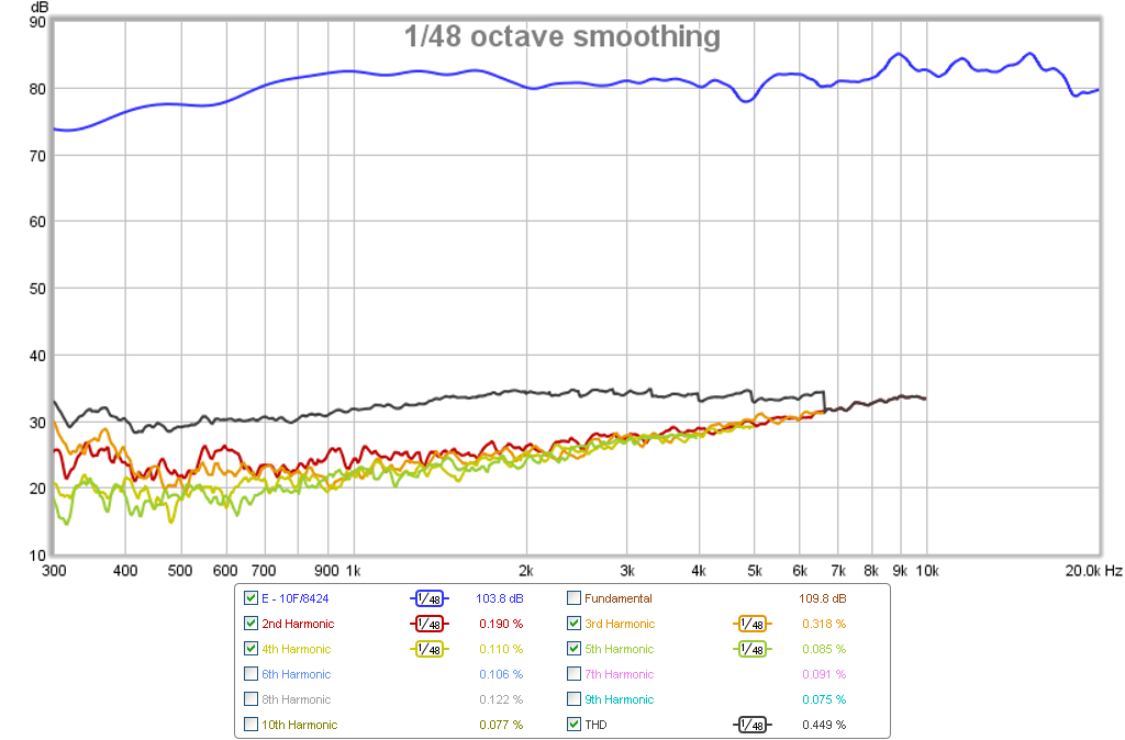

Harmonic Distortion at low SPL (74dB at 1m)
This probably is not much use as the levels are so low that drivers are in general very clean. If I have time I will remeasure a few like B80 and 10F at 90dB and 1m. For next round I will keep this in mind and collect it.
PS95-8:

TC9FD:
10F/8424:

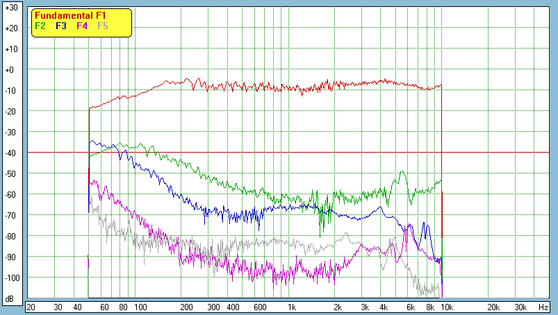

THD+CSD very similar to Klang+Ton mesurements..This probably is not much use as the levels are so low that drivers are in general very clean..
Three best drivers still are 10F, B80 and TC9.. exactly in the same order.. nothing has changed..
B80 has only one problem, poor 3rd harmonic..

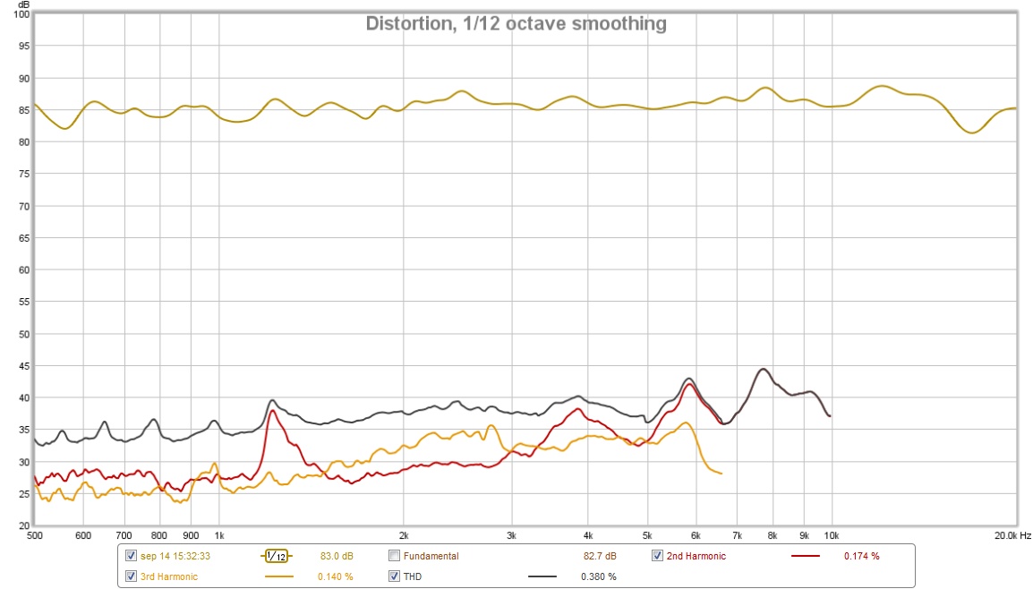

Here is B80 with AL170, 3rd order xover..
.....Here is B80 with AL170, 3rd order xover..
