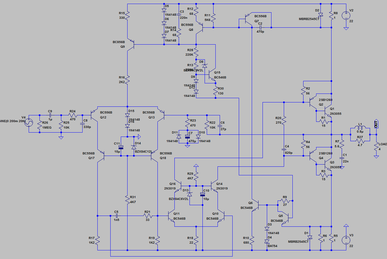

Hello all!!!
I discovered the thread and the project just yesterday.
I was looking for a new amplifier to build, gave a rapid look to the original schematic and immediately felt in love with the Circlophone.
I really love its topology: simple, clean, extremely sophisticated but simple.
Great jod, Elvee.
I also have to clap my hands to danielwritesbac, for the big job he is doing dovumenting the project.
Wonderful project!!!
I immediately elect the Circlophone as my next DIY project.
After reading few pages of the thread, I decided it was time to simulate it, so LTspice entered.
I drawn the circuit, play with it and now I have a nice circuit, slightly modified by me, that I'd like to submit to you.
I cascoded the inputs, just because I can, and because this will grant me to slap in my beloved 2SJ74 fet (or any other low voltage device), during the future tests.
I cascoded also the VAS stage; this way, the VAS transistors can be small signal transistors, as the cascode transistors will handle all the power dissipation.
This way I can also install the cascode transistors onto the same heatsink close to the driver transistors, compacting the board and saving the space otherwise occupid by the VAS heatsink.
Again, I added the CCS instead of R21,beause it seems to help.
Tonight I will leave for my holidays, which I will spend trekking through the alps; I will bhowever bring with me my laptop, so I can continue to play with the project and read the thread.
I want to develop my own PCB; I know there are already many, and really well done, but I want to do my own because it is funny, for me, and because in this way I can still learn.
I leave you with an image of my circuit and the simulation schematic.
Let me know if there is anyhing wrong with the circuit, what do you think and if you think what I've done is useless, and why.
Ciao,
Giovanni

Thanks for your kind words, GiovanniHello all!!!

You seem to follow very much the same path as Piersma: he also designed a "Super Circlophone", broadly along the same lines.After reading few pages of the thread, I decided it was time to simulate it, so LTspice entered.

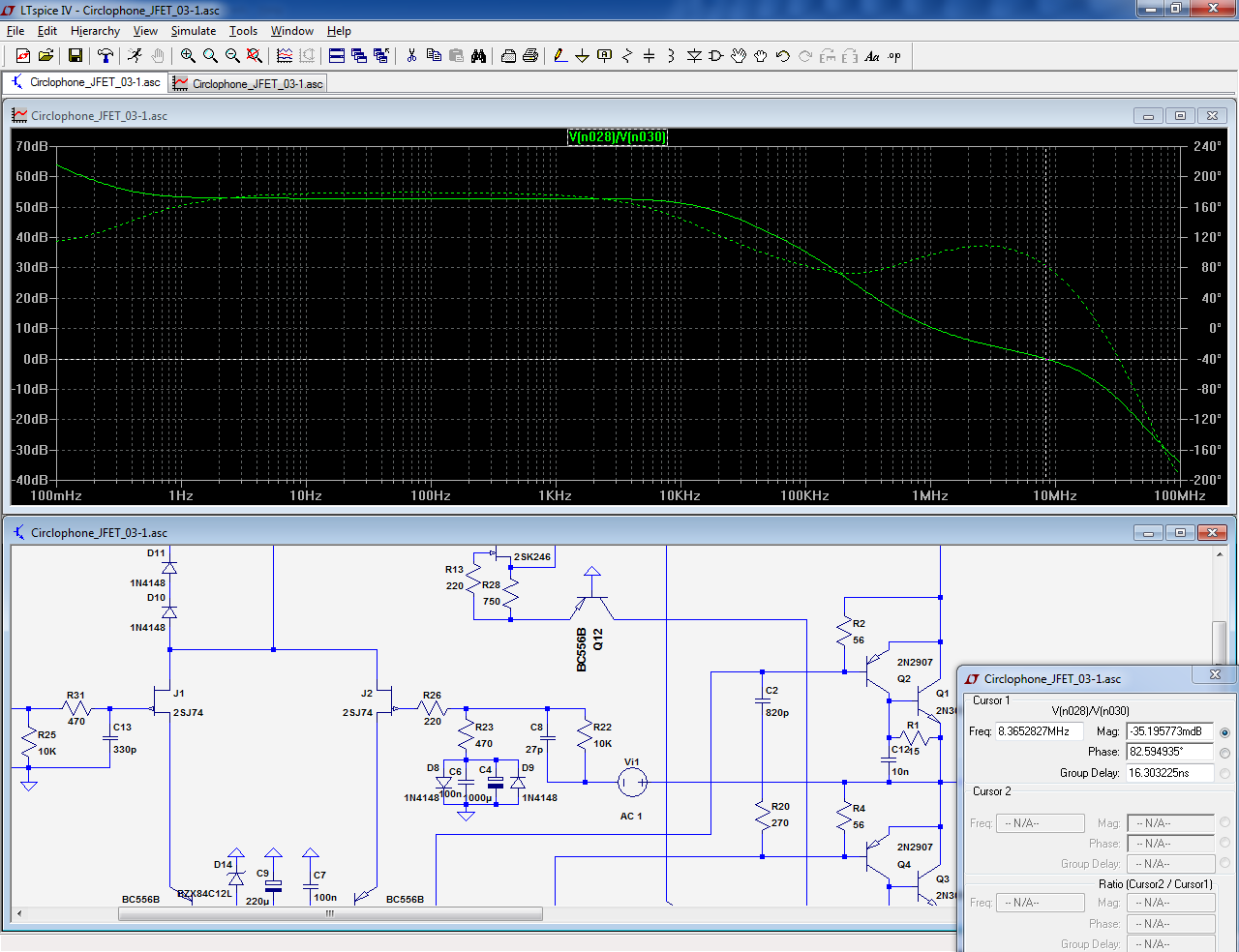

Hello all,
I'm back!
I took the time to read (most of) the thread, and now most of my doubts and questions have been answered.
I have to repeat I really love this amp, this seems to be the end of a long search, started some 25 years ago, when I built my first class AB amplifier (with TO3 2N3055!!!); from then, I searched for something that could join the class A "sound" (I built few Nelson Pass's Aleph 3/30 amplifier/prototypes, the first still in the '90s), with AB efficiency...
Up to now, no way, class A being too power-hungry for my taste, and class AB being "not exactly what I wanted" in terms of sound.
Of course I tried also valve amplifiers (KT88, EL34), which sound I appreciate, but I don't like them too much for the same reason of solid state class A amplifiers, power requirements.
I always knew that there should be a clever way to keep those output transistor always on, without transforming enormous quantity of energy into heat.
I also tried to develop complex bias servos, to obtain that, but never really succeded.
And then I found your Circlophone. Great.
I decided to use what I have on hand,so fets on input and as a ccs.
Please find the schematic attached.
It simulate very well.
Any problem you can see with my solution?
any suggestion?
I also own several 2SK1058 FETs, do you think I can try them as output device?
Any improvement over BJTs?
Next step is to develop a suitable PCB, in the next few days.
I will let you know.
I'd like to read it too, if you can send it to me.
Ciao,
Giovanni

It looks finePlease find the schematic attached.
You can probably eliminate C9, with your components and configuration, local instabilities won't be an issue.any suggestion?
Also, I suppose you are aware that the 2N2907's as drivers are a bit small, and in reality they would at least require a good heatsink
You can, but in this case I would recommend you build an opposite polarity version, this will eliminate the need for drivers.I also own several 2SK1058 FETs, do you think I can try them as output device?
This has been described somewhere in thread, certainly for darlington OP's, and perhaps also for MOSfets, I don't quite remember
The slew rate will probably be improved, maybe the harmonic profile too, but the global THD will probably increase a bit, because the loop gain will be diminished.Any improvement over BJTs?
Another effect will be a reduced positive swing compared to BJT's.
This could be eliminated by using the same technique as in the CircloMOS, but I am not sure how the circlophone and circloMOS bias schemes will coexist.
Something to be tried

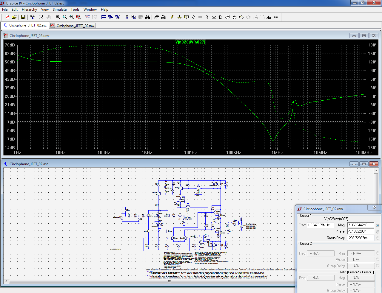

Hello all,
I'm working on my own PCB, with jfet cascoded inputs.
I simulated my jfet version of the circlophone, and modified slightly the input stage and feedback path, increasing their impedance.
Is there any problem increasing the feedback path as shown?
I think everything works fine, but I have to ask before to proceed with the PCB.
In the past, I built a Nelson Pass amplifier with a jfet input (Aleph J), and completely removedthe capacitor in the feedback path (C3 in original Circlophone schematic).
In such a cas, the R16 feedback resistor should be connected directly to ground.
Is it feasible?
Simulating my circuit in such a condition gives a slightly higher DC offset at the output (about 2.6mV), what about in reality?
Do I have to match input jfets to obtain an usable offset?
Or simply this does not work?
I also removed the input capacitor, cause I'd like to use two very big polypropilene motor capacitor I own, that cannot fit onto the PCB (Arcotronics MKP C.4G, 5uF, 700V).
Is this OK?
I'm also wondering if I can omit them completely; any issue (other than the usuals) running this topology without input capacitor?
I cannot see any, but I'm not skilled as you.

Again, I omissed the compensation ntwork on LTP (C6, R23); do I need it in reality? jfets I think should not need it.
What's your thought?
