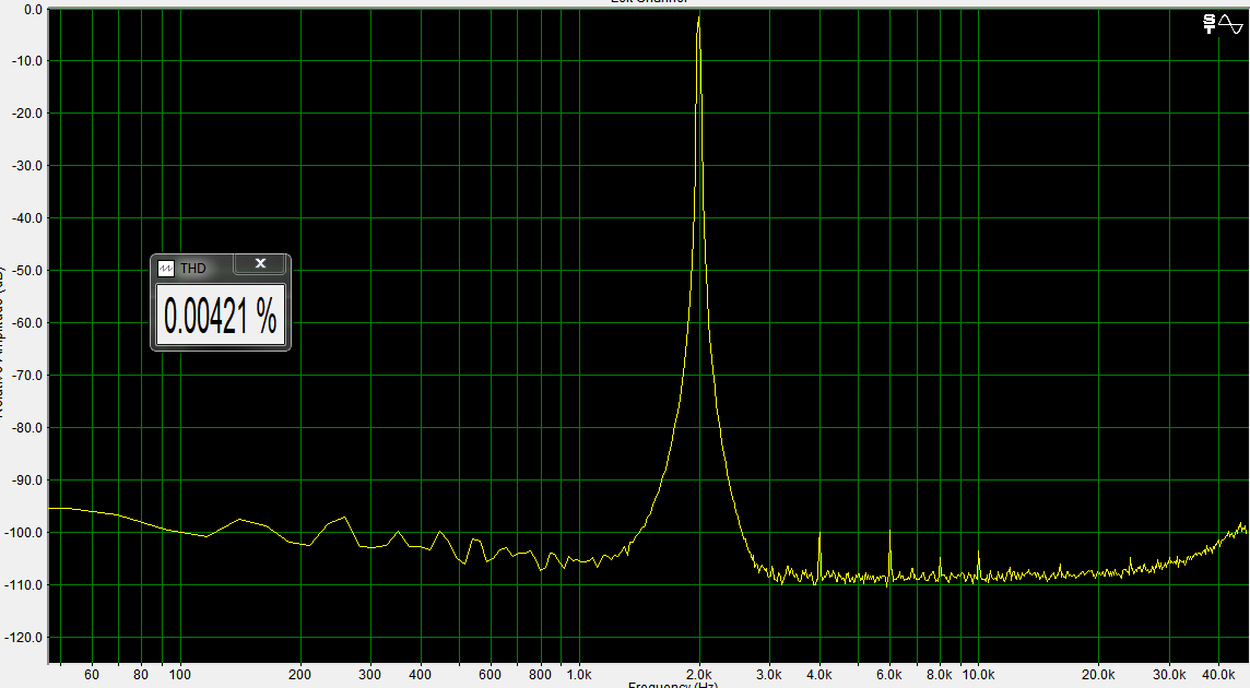

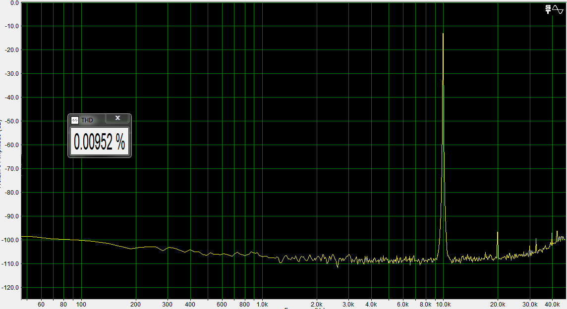

Latest measurements and revision V.1.2
Added:
Degeneration resistors front-end.
Zobel network.
Measurements:
30W@ 8 Ohms BW: 80kHz
