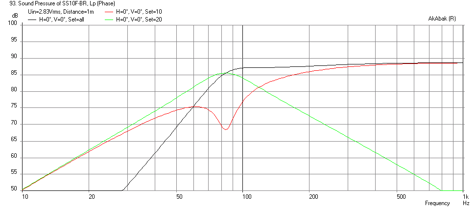

My sims show that you will need at least a 2.3 liter cabinet to extract reasonable extension down to 80Hz with the 10F. Here is the cabinet tuned to 84Hz, the extension is about 79Hz at -3dB. It will need a high pass filter to prevent over excursion below this though. But if you were running 30 of them, the stroke would be cut by 30x, so maybe not an issue.

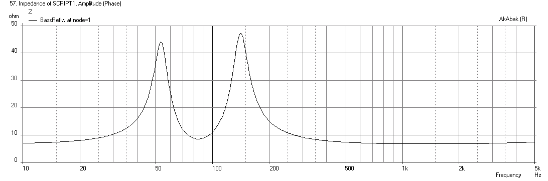

Impedance:

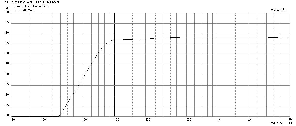

From my other thread, I can see that you can have a ported alignment to make it flat to 80Hz, but XO at 2 octaves higher at 320Hz, and this gives you the bandwidth needed for a -6dB/oct XO needed for a time-aligned FAST. So the cones would never actually move that much.
Here is what the frequency response would look like with a 320Hz 1st order Butterworth high pass filter applied (as the linear phase time aligned xo):

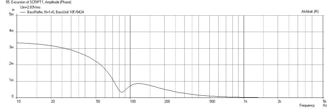

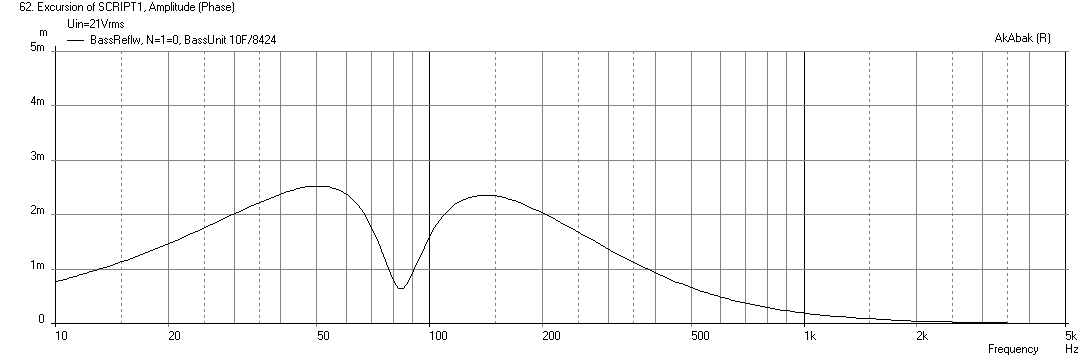

Here is the cone displacement of a single BR driver at xmax of 2.55mm - it takes 21 volts:
485439d1432825689-all-aspiring-full-range-array-project-10f-8424-br-79hz-320hz-bw1-hpf-dsipl-21v.png

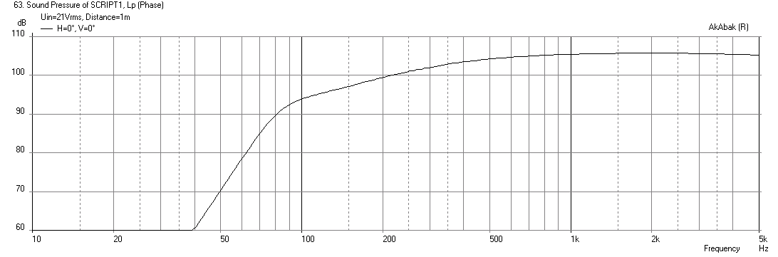

Here is the corresponding max SPL at 21 volts - about 105.7dB! Not bad - x 30 would be quite the loud semi PA like system:
485440d1432825689-all-aspiring-full-range-array-project-10f-8424-br-79hz-320hz-bw1-hpf-spl-21v.png

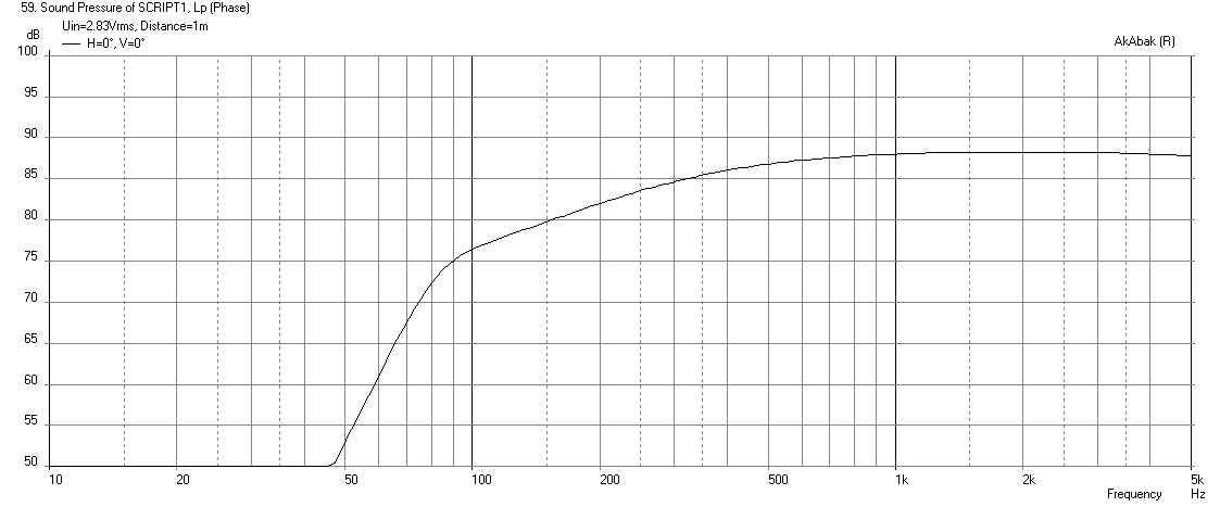

I would question that sim (unless it has EQ built-in): here is what i get. Pretty ugly.
Dare I ask, Why are these so different? Different software, different formulas used, different BR alignments?

In Akabak, there is an option to set effective Q/fb. I set that at 0.1 to correspond to having some damping internally. Makes a minor difference - won't fix a funky step ledge response like that.

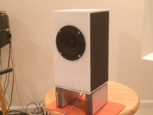

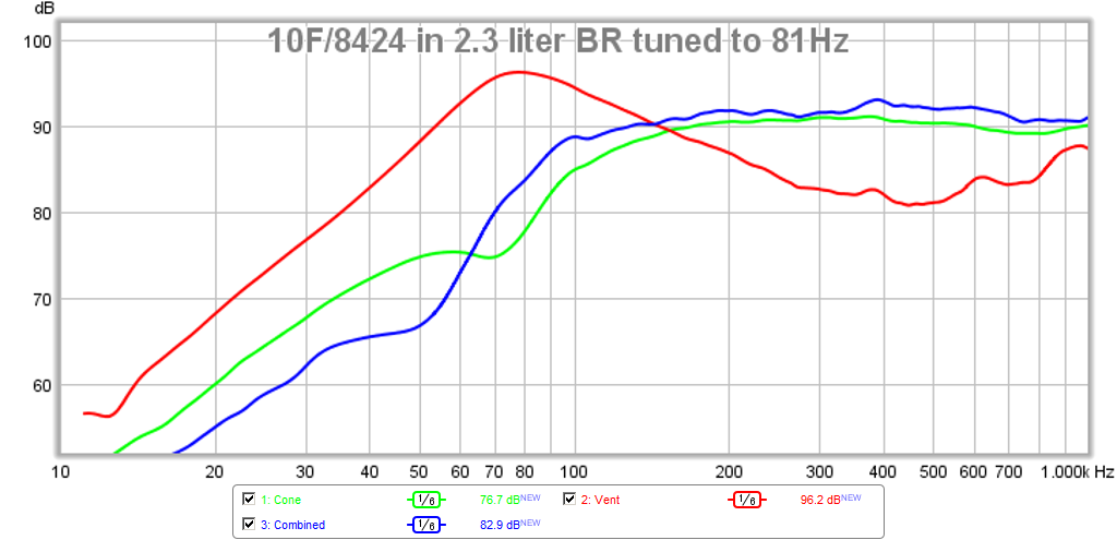

Rather than argue with whose model is right, I just whipped up a quick and dirty 2.3L bass reflex box and tested the 10F/8424 - 30mm dia x 75mm long port exits out of bottom, I put fiberglass damping on one end surrounding the internal port tube, and lined the wall opposite the driver with foam:
Near field measurements of port (red) and cone (green - still some port contribution) and combined output (blue) about 0.3 meter away (levels are NOT to scale):

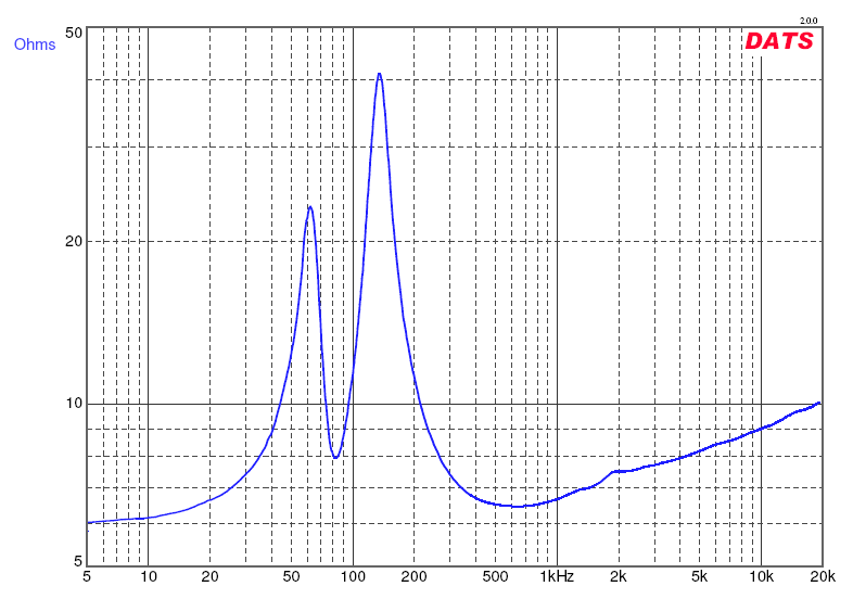

Impedance measurement using DATS v2.0 showing tuning freq of 81Hz:
485556d1432900103-all-aspiring-full-range-array-project-10f-8424-br-81hz-impedance-meas.png
Simulation of cone, port, combined for 81Hz:
Oh, and almost forgot to say, with a 1.0mH & 5R BSC in place, the response is flat and it sounds quite nice. 80Hz bass is not bad and sufficient for easy listening as a portable speaker or mp3 player dock. The lower Qts of this driver makes for a compact BR box.
