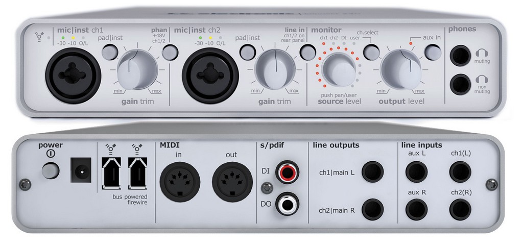

It was a sad day when my previous Edirol FA66 DAC went down. My backup Edirol USB DAC did not have near the DDR and the system lost a level of performance. At swap-n-shop on Sunday i ran into a fellow selling a TC Konnekt 8, i bought at a bargin price and has brought me back to similar performance as before so i am happy.
I could never afford an expensive DAC but in the highly competitive proAudio field these guys will build at least a 1000 pieces for every single unit the hifi guys sell and they are really good value for the money (this one used cost me $50 CAD (about $40 USD)). They also come with multiple channels out (this one & the FA66 have 4) so i can bi-amp right out of Pure Music, as well as micPres so they can be used for measuring.
dave

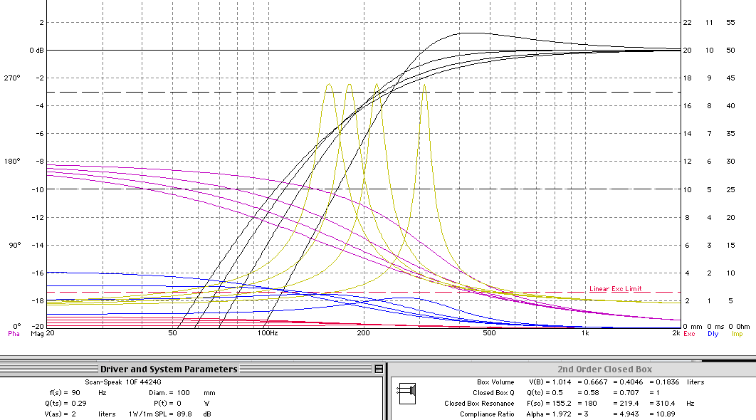

Attached are the sealed sims. How much EQ you put into them depends on how low you want to go and how much power you have.

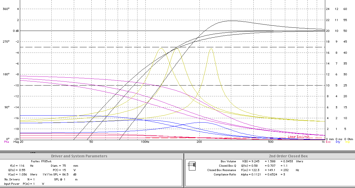

Actually, it looks like excursion is going to be the limiting factor. With 30 of these on each side, I am at about 103 dB with the excursions as they are laid out on your sims. It would seem that for the cleanest, most dynamic sound, allowing for head room for dynamic peaks, these are best used in a FAst system crossed at 300 Hz, (ideally at 500 Hz, which is too high). Yet, I know it is hard to judge the true excursion performance off a sim like this, but I prefer to go with the conservative approach at this point in the game.

Note that what is graphed is the excursion at 1 w.
That is the concern. On the positive note, if I was to use 30 10Fs/channel and achieve 103 dB SPL @ 1 watt, I would not need a big amp. 😉 But to have no power compression at all, these would need to be crossed at 500 Hz (based on x-max), I would push the envelope and go for 300 Hz (based on x-mech).
Now let's just say they perform better then the sim suggests, and I ran these "straight", I could cross a bass line in at 160 Hz, using the natural 'almost' Linkwitz-Riley roll-off of the 1.014 liter box. That slope would fall under Norman's "Yuck" category 😱 Derek's Butterworth would be at 170 Hz. If I was really lucky, and somehow this driver was to completely defy the excursion limits of this sim altogether, I would need 8 dB of EQ at 80 Hz to bring this array to the - 6 dB Linkwitz-Riley point to cross to my subs.
For the Fostex, at one watt, the overall SPL with 32 drivers is 101.5 dB. Its - 6 dB point is at 120 Hz in a 1.588 liter box for Butterworth. In that alignment it would need 5 dB of EQ at 80 Hz to cross to the subs. I do not think 1st order at 80 Hz is THX, but it might be fun to try. My guess with this order cross-over, the subs would need to be close to the arrays. If I went with the large 9.245 liter Bessel roll-off, we would only need just under 4 dB of EQ at 80 Hz. Again, this driver would need to completely defy all excursion limitations given on this sim. And not really understanding the Fostex X-max to begin with, it is hard to say where to even cross this driver over in a FAst array (2000 kHz?). If I was to guess that the X-mech is 2 mm, this would be clear and free at 400 Hz and I could push it a little at 300 Hz. If x-mech was as high as 7 mm, it could go down to 140 Hz, but that is probably a pipe dream. (I will not be going higher then 300 Hz with either driver).
I do not know how close to reality these excursion estimates are on these sims, but I find it interesting when considering that the CSD response on both of these drivers falls apart at about the same frequencies their excursion limits are reached. (I am doing a conservative "guess" with the Fostex.) I do not think that is a coincidence. And as I mentioned earlier, it does appear the Fostex is a little cleaner between 300 - 400 Hz; note that it does not move as much at these frequencies as the 10F (even though it is "outside" its "published" X-max). It is going to be interesting to see how the 10F performs against the Fostex in the Mids and Highs.
I am agreeing more with Derek on this, "I believe in minimising cone travel by maximising surface area."
On one hand, I probably could run both of these drivers safely down to 100 Hz (10F needing more EQ, at least twice the power (for EQ)), and have a "reasonable" amount of distortion and power compression. 80 Hz seems to be out of the question with these driver choices.
Yet, if I really wanted to keep things clean, relaxed, open and as free as possible of IM distortion, esp with dynamic peaks, I would need to embark on the challenge of integrating a bass line and hopefully not having the "yuck" Norman is talking about. If avoiding the "yuck" is as simple as 1st order cross-overs, we have it made! 🙂
