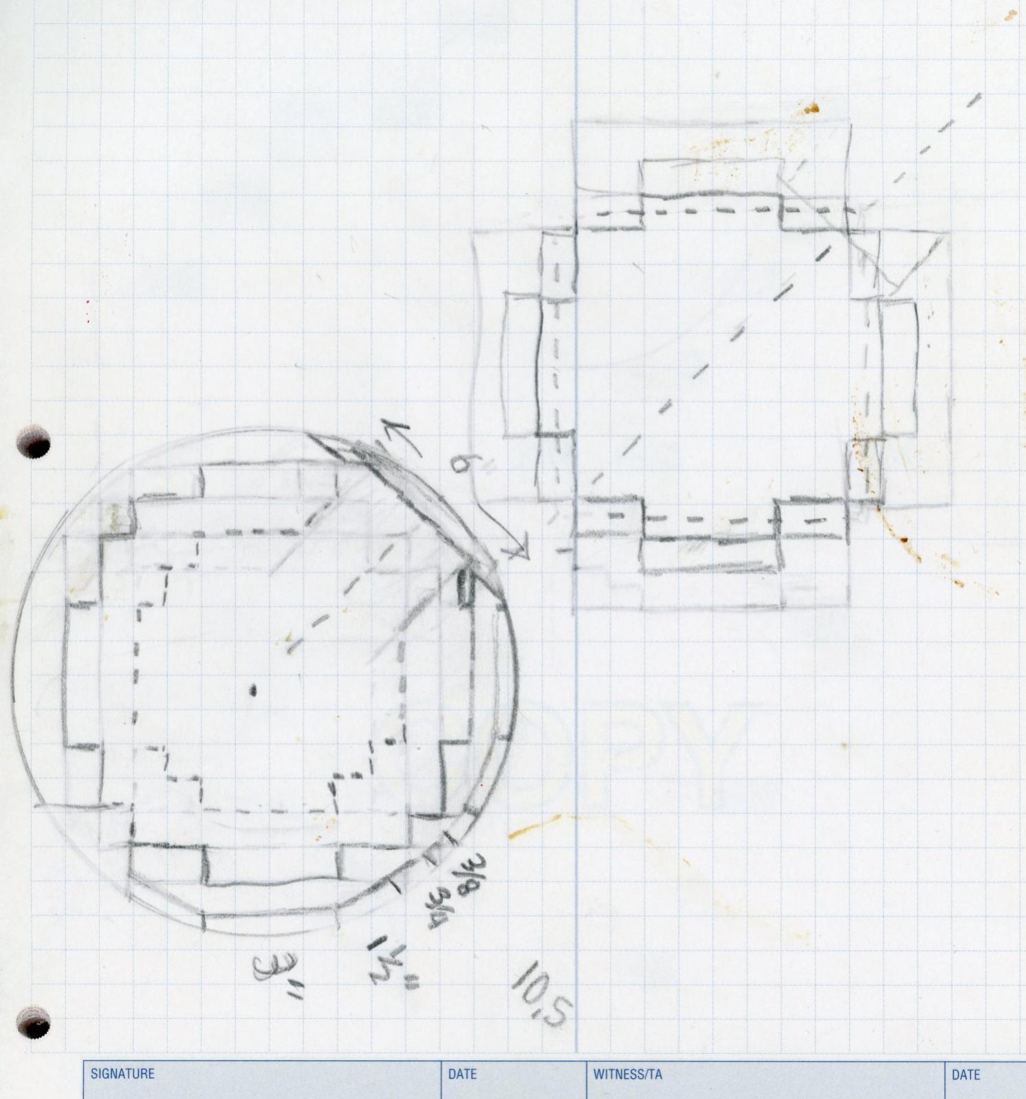

Now, about the volume choice I made.
10 years ago, when I was first playing around with the NSB drivers, I tried them in an Open baffle (similar panel size to the panel I used in the drivers blowouts on this thread) and a closed box with the same volume as VAS. The Qts was published at 0.76, so at the time, that seemed logical, as I did not have the DSP or knowledge I have now. At that time, I always preferred the more lively mid-range of the open baffle, but did not like the bass roll-off...
So six years ago, when I came back to these to try as arrays, I did not want to rise the Q too much, so I went large and leaky - way too large. I wanted to create that open baffle mid-range I liked. Also, I did not want to cut the wood into a bunch of useless parts either, in case the whole idea bombed...
I was an array skeptic at one time too. :rolleyes:
...But instead, I enjoyed the build up to January 2017 and gave them the name: Cheap the Cheerful.
So when considering the rebuild, I did contemplate bringing the cabinet size down to VAS. I looked at what others did with these speakers also. Some of the ported designs where about as big as what I had, but I really do not care for ported designs. Then there was the part inside me that said "What if You do all this work, and the sound does not improve and the only path forward is new drivers?" Also, I like the mid-range, why chance changing it?
So, what I decided to do, was make the cabinet 2/3 smaller. Without the braces and diffusion parts, that puts this cabinet at double VAS (still pretty big). (Original was triple VAS). But it does make the Volume about right, just in case I ditch or wear out the NSBs, I could populate these same cabinets with Fostex FF105wk or Markaudio CHN-70. I know this is not the best decision in regards to the NSBs having some power handling protection, but oddly enough, I did not have any issues with the original either. ;)
Also it keeps the experiment pretty interesting - given both cabinets are/were pretty over-sized...
Of course if any of You think this is truly a bad idea (remember the Qts of 0.76) then I can add more bracing and diffusion. :D I know I can DSP the Q peak flat, but am skeptical in regards to that being the ideal for the mid-range...

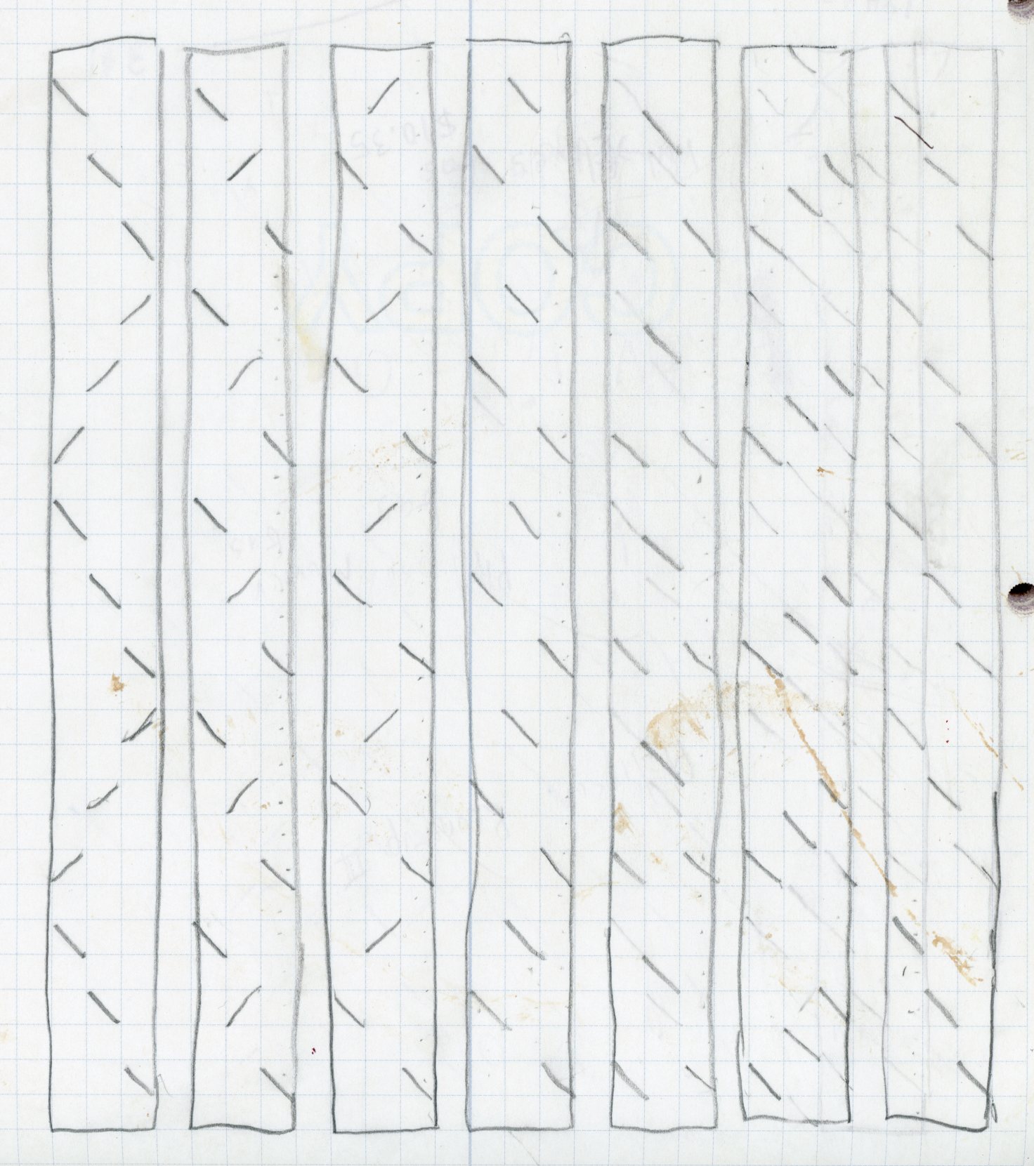

Drawings:
The first one was keeping the cabinet size the same, but having a rounded front and taped back.
The second one I have had in mind for years, as I mentioned in my "welcome back" post, I have always wanted try a column shaped cabinet. That method of assembly did not work with the pieces of wood I was reusing...
...so I designed it to work with the pieces I was using: third drawing.
The fourth drawing shows different possibilities I was considering with the re-used door trim scraps.

I am curious to what your guys thoughts are - continue as is, or dial it in to VAS? (I will find a way to figure it out if need be
I would not be so concerned with the chamber volume and Vas mismatch, as you can tune a lot by adding more dense stuffing (rock wool or fiberglass), or even volume filler like bricks that will add stability and take up space. It has to do more with making sure it handles power well but if too big, will give appearance of "deeper" bass. You are going to use DSP and EQ anf FIR etc etc anyway so it can be driven and controlled at will.
Vas on the TC9 I use is 1.19 litre. My chambers are ~ 2.2 L. I would error on the large side. This isn't comparable to OB, as the array effect will se a raise in frequency all trough the midrange. Something you will have to counter with EQ/FIR.

Damping the chamber is very important. Leaving breathing room around the drivers but also preventing the little wiggles in the impedance plot, which are internal reflections. Once you get that right, the midrange has huge potential, it's definitely one of the strong points of arrays done well.
Sure it depends slightly on the driver used etc. but the EQ is what determines your final tonal balance. Well that, and the fact you'll get the driver you use back on steroids.

So don't sweat it, leave it (the enclosure) big enough and damp it properly. Then EQ to taste.

...But based on your last post, and X's, I looks like I am on the right track keeping what I got - I will give that "Infinite Line Source" a read, as I have not read that one yet. ;)

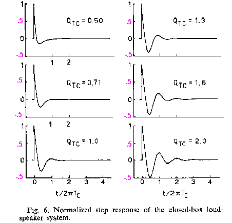

4497d1038550363-subwoofer-qtc-tightness-step-response-closed-box-gif

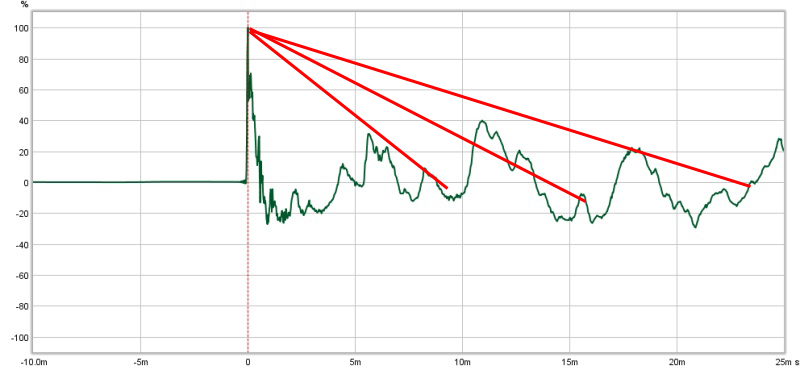

Measuring Loudspeakers, Part Two Page 2
Now I get it, at least the goal we are shooting for: a gradual slope heading down towards zero - like the hypotenuse of a triangle, with a slight concave curve to it. Your graphs illustrate that really well. (Mine don't). It appears that the lower the frequency the system can produce, the more gradual the slope is, taking longer milliseconds to reach zero. If our systems could go down in frequency infinitely, we would get the perfect STEP posted above...
Only 'perfect' in theory, not in our audio hobby
It figures ;) Good so far?
Now what about this:
As this slope is frequency based, is it safe to say that the frequencies between 0 - 0.5 ms are higher frequencies, 0.5 - 5 ms are mid-range frequencies, and after 5 ms are lower frequencies? I do not expect that I have these "ranges" exact, but that is the general concept, yes? As lower frequencies are longer wavelengths, they would take more time to decay. I am on the right track, yes?

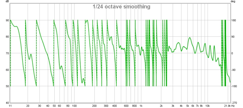

Either way, it looks like I have a lot of work ahead of me. I do not see any gradual slopes in my current Avebury set-up. :eek: I see a lot of phase shifts:
attachment.php
Yet, there ARE a lot of phase shifts - at least at the listening seat. Actually, it is an ongoing downward slope that happens to do many 180 degree cycles. I need to remeasure the speaker itself, but I am guessing a lot of this is room. :eek:
