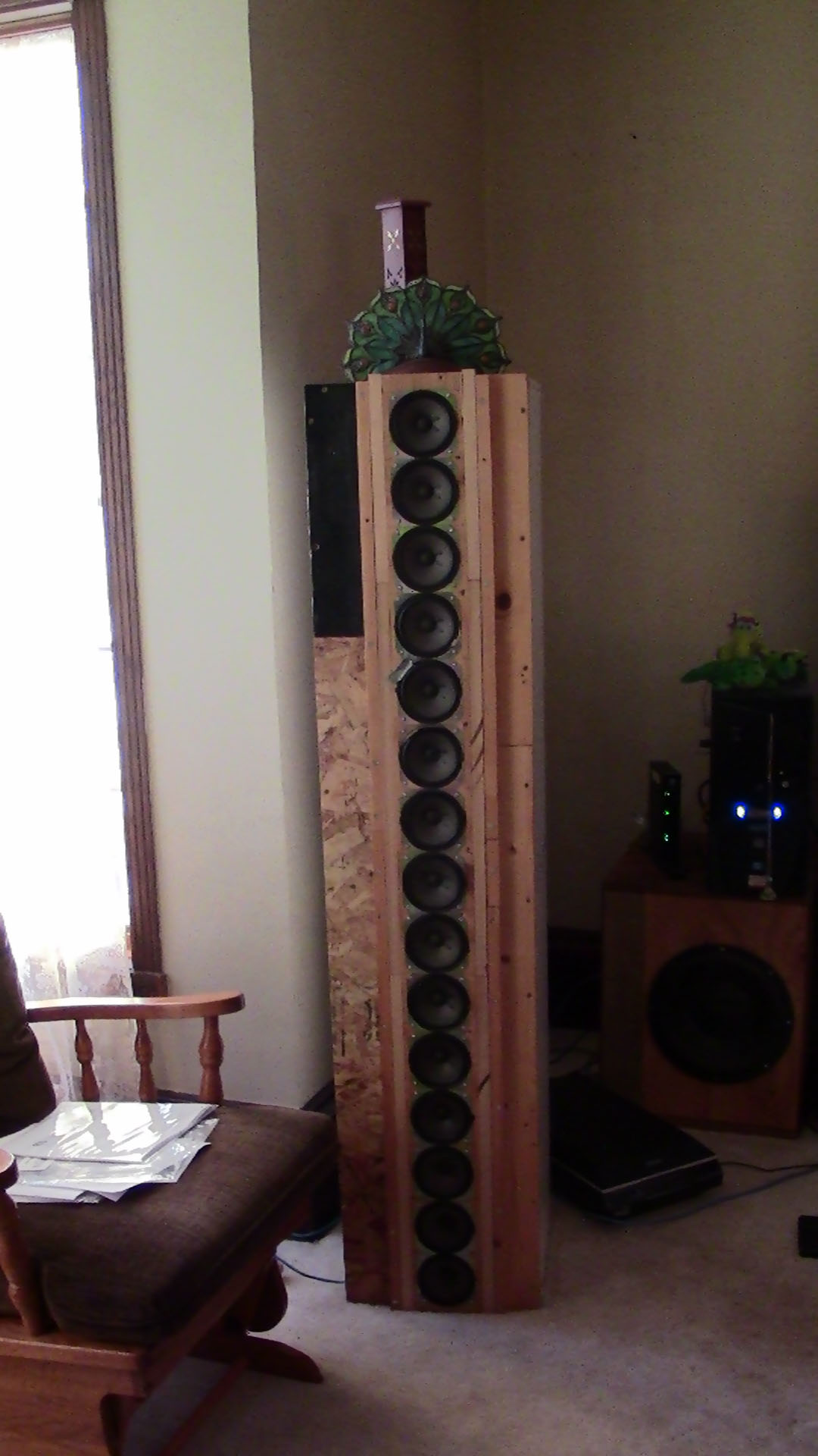

Anyway, I looked over the last couple of posts, and I realized that I have not even mentioned on my very own thread that I am rebuilding my cheap and cheerfuls arrays. 😱
I started the re-design in January 2017 and I have been diligently working on them since then, between all that other stuff i mentioned above - (believe me, there is a lot more woes I will not be sharing at this time). I really did not plan to take this re-do to the level I am, but You could say I am creating a cotton purse from a sow's ear. I say "cotton" because I am still using the 99 cent driver, workable, but not state of the art wood, and not the full floor to ceiling array I really aspire build. But having enjoyed these speakers so much in their ugly form, I figured they are worthy of a nice cabinet. Also, I am curious to see what a well executed build would offer to the table. This could only help future builds right? And to be honest with myself, I can already see it now, if I would have moved on to another build, these would more then likely never be finished in a nice cabinet. The new build would have confirmed my preconceived notion that the cheap drivers could only go so far. But, from the listening comparison between the different drivers I am considering for arrays (post 276), the 99 cent driver is in the ball park, not my favorite, but not undesirable either. So how much potential I am missing out on due to the crappy cabinets. We will see...
Here is the photos of what they were:

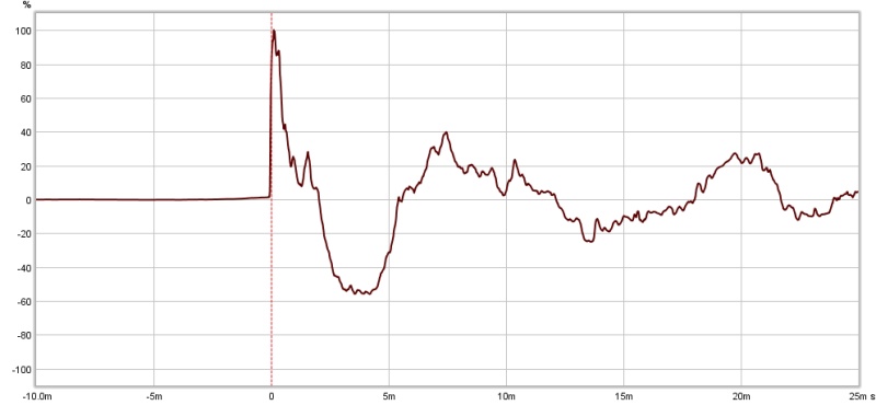

Measurement Inspiration

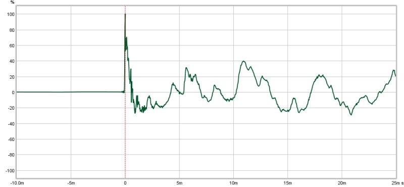

Here is one of the objective reasons that inspired me to remake these arrays.
Wesayso always mentioned the importance to the first 20 ms in the impulse response, but I never knew exactly how to find it. Once he guiding me to the images and proper settings, I found some interesting surprises.
I listen to my Arrays and Avebury systems in the same locations. When comparing the 20 ms STEP responses at the listening seat, You will notice that the arrays have a lot more spikes in the first 5 ms then the Avebury does. We thought this could be elements of the corners by the speakers, and some could indeed be so, but my gut figured a lot was coming from the cabinets and the driver protruding rims. We will see how reliable my gut really is. 🙂
I included photos of my Avebury locations for the objective types out there.

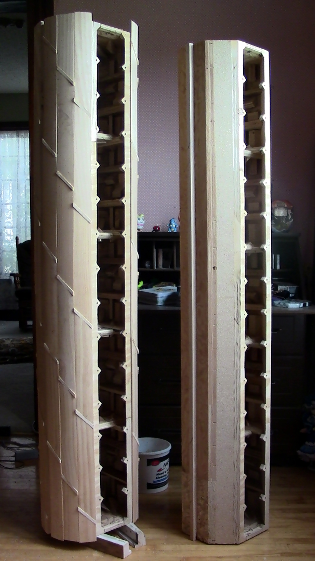

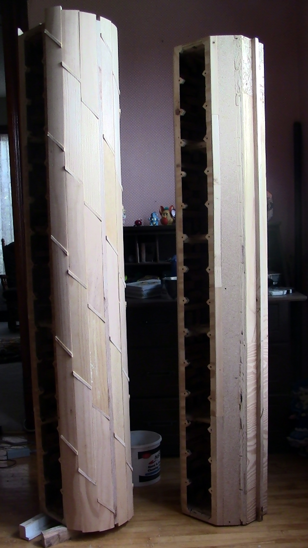

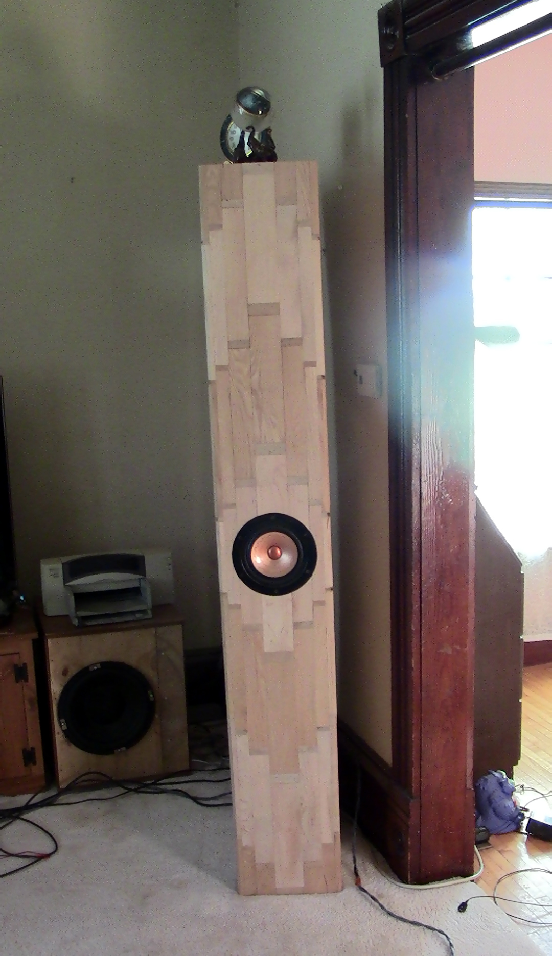

Introducing the Cheerful Conglomerates

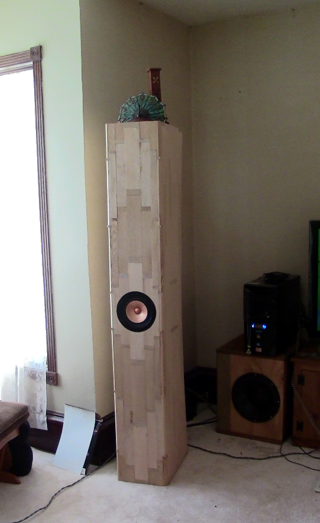

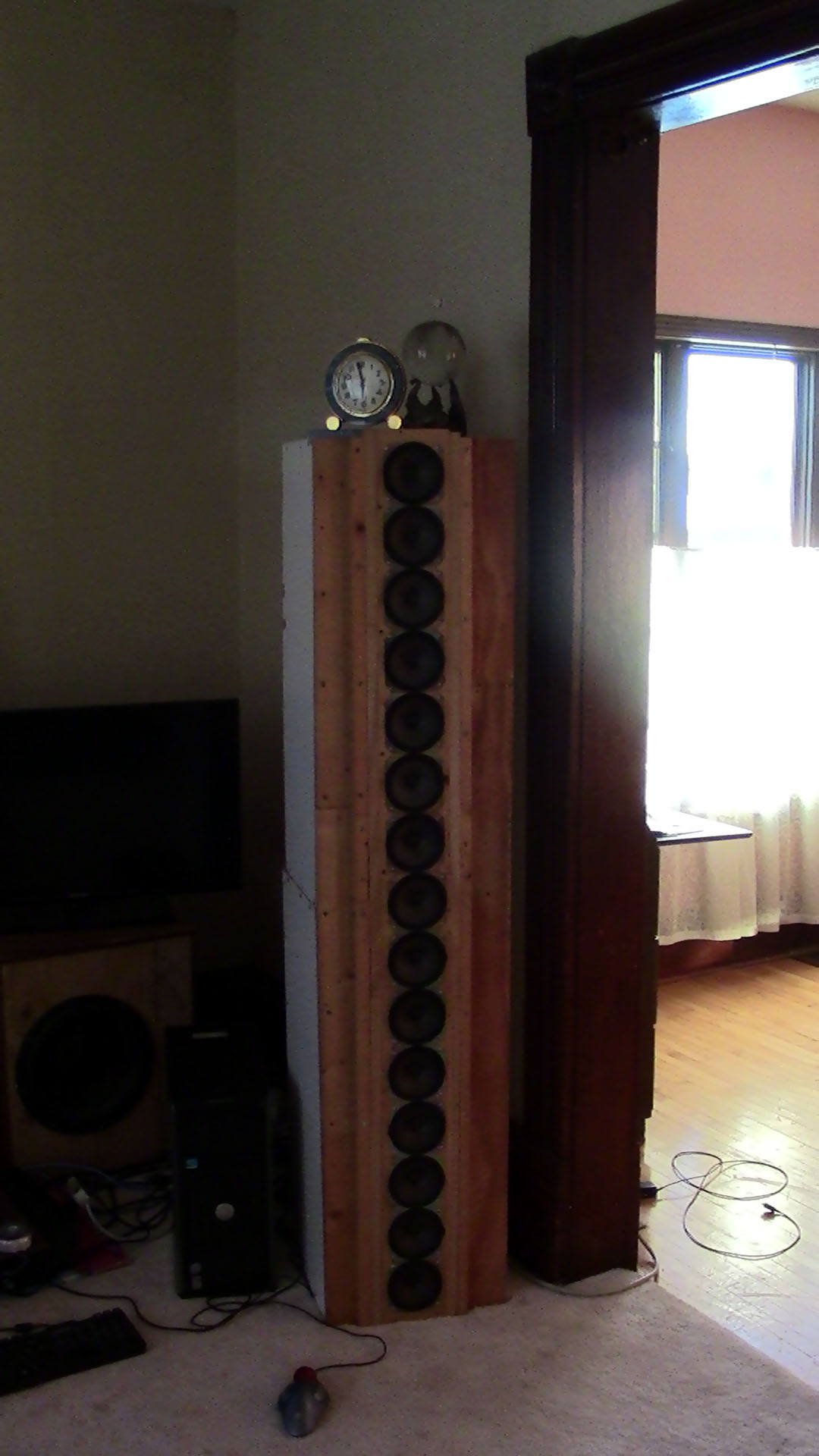

As You can see from the photos, I ended reusing the wood from the prototype design. It is what is going to make the differences so interesting. What can one really do if on a budget. Do not worry, I have many builds planned with better materials, some that I already have. But, for many people, times are tough. How far can we go with limited funds? Also, this is a creative hazard I have, I like to recycle things, and make them useful. 😀 Even if I end up with two sets of "better" arrays in my main listening room. I would enjoy these in my studio.
The right cabinet in the photo shows the conglomerated core structure of plywood, particle board and some OSB (I really wished I would have spent the $20 on A/C plywood thou 😱). There are consequences I found using so many different woods, and I should have known better - but the creativity over ran my logic. I am more Artist then Engineer, and I am totally okay with that. But as I said earlier, I really did not plan for this build to become the art it has. I was planning on a glue and screw build, but after taking the prototypes apart and seeing what the screws did to the wood, that was out. (more on that later).
The Left cabinet shows the fir door trim mosaic I created to make the cabinets circular columns. I always wanted to try a column design, even if the beveled sided rectangle is as practical.
Both cabinets have the fir door trim mosaics on them now...

Now back to the beginning...
Here is what my aspirations are for this project:
Goals:
Nicer looking cabinets
More solid build
Air tight build
Eliminate driver protrusion diffraction
Eliminate mid and high cabinet diffractions
See if this smooth cabinet diffraction theory holds any water and affects measurements and more importantly listening impressions.

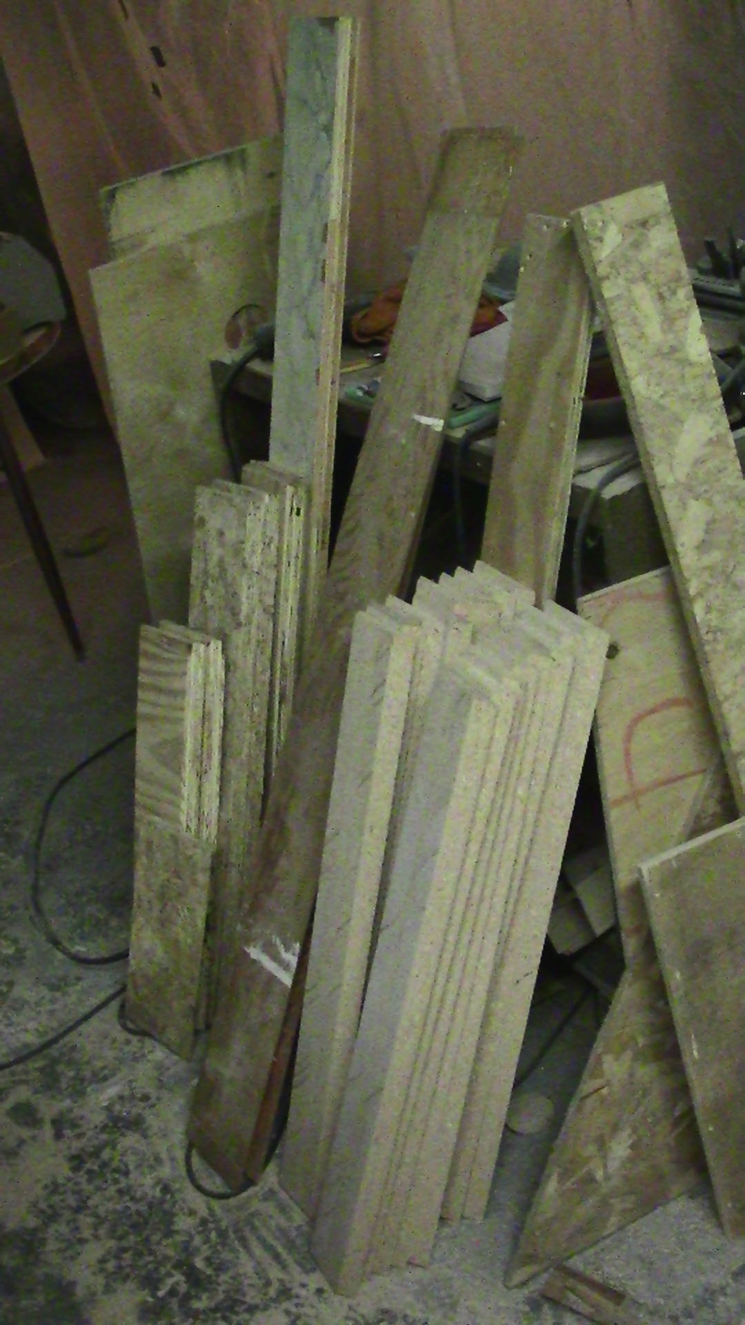

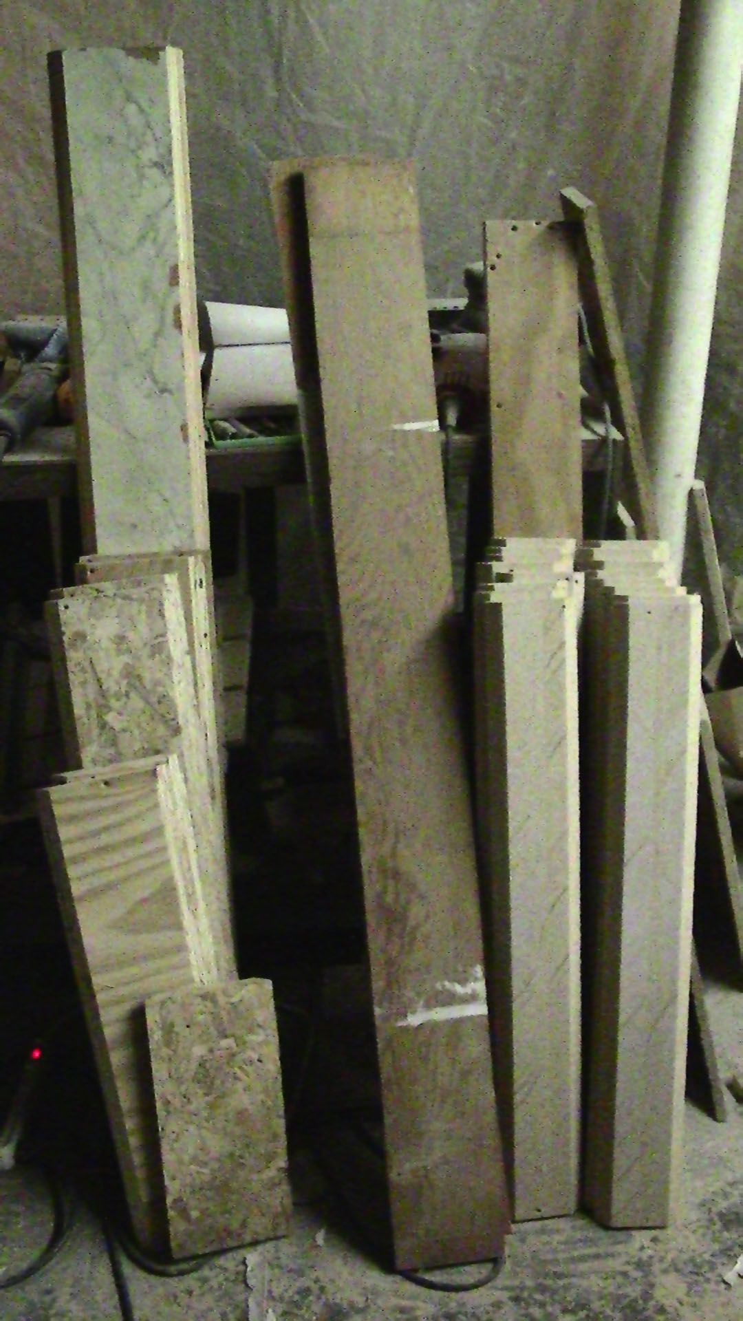

Here are the photos after cutting the prototypes up into their new parts. 🙂
Even then, I had no idea what these are to become...

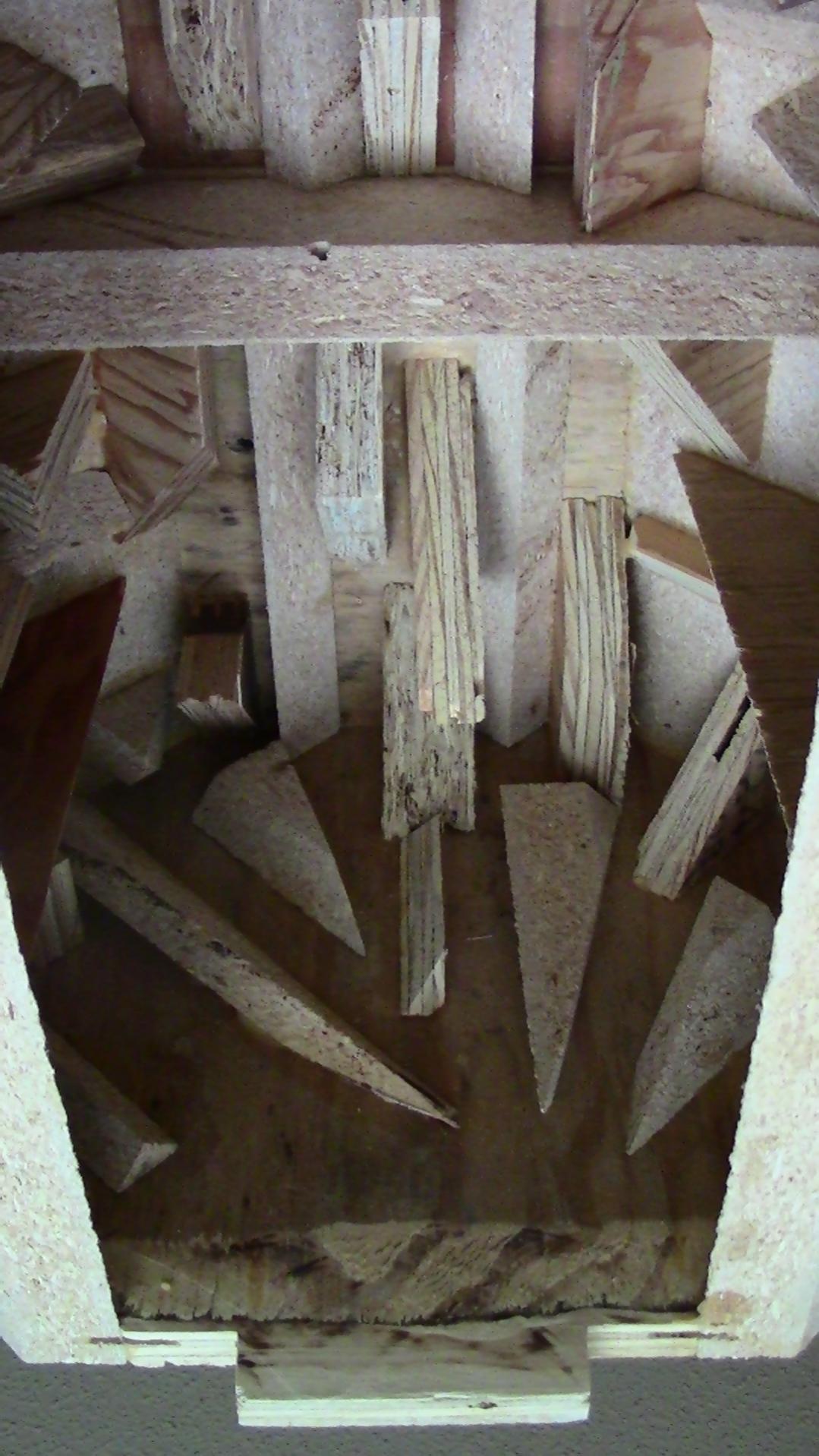

Jump ahead to the insides
I really like where this is going!
Thanks, Ronald:

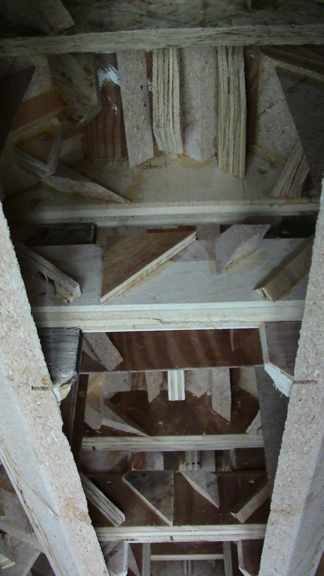

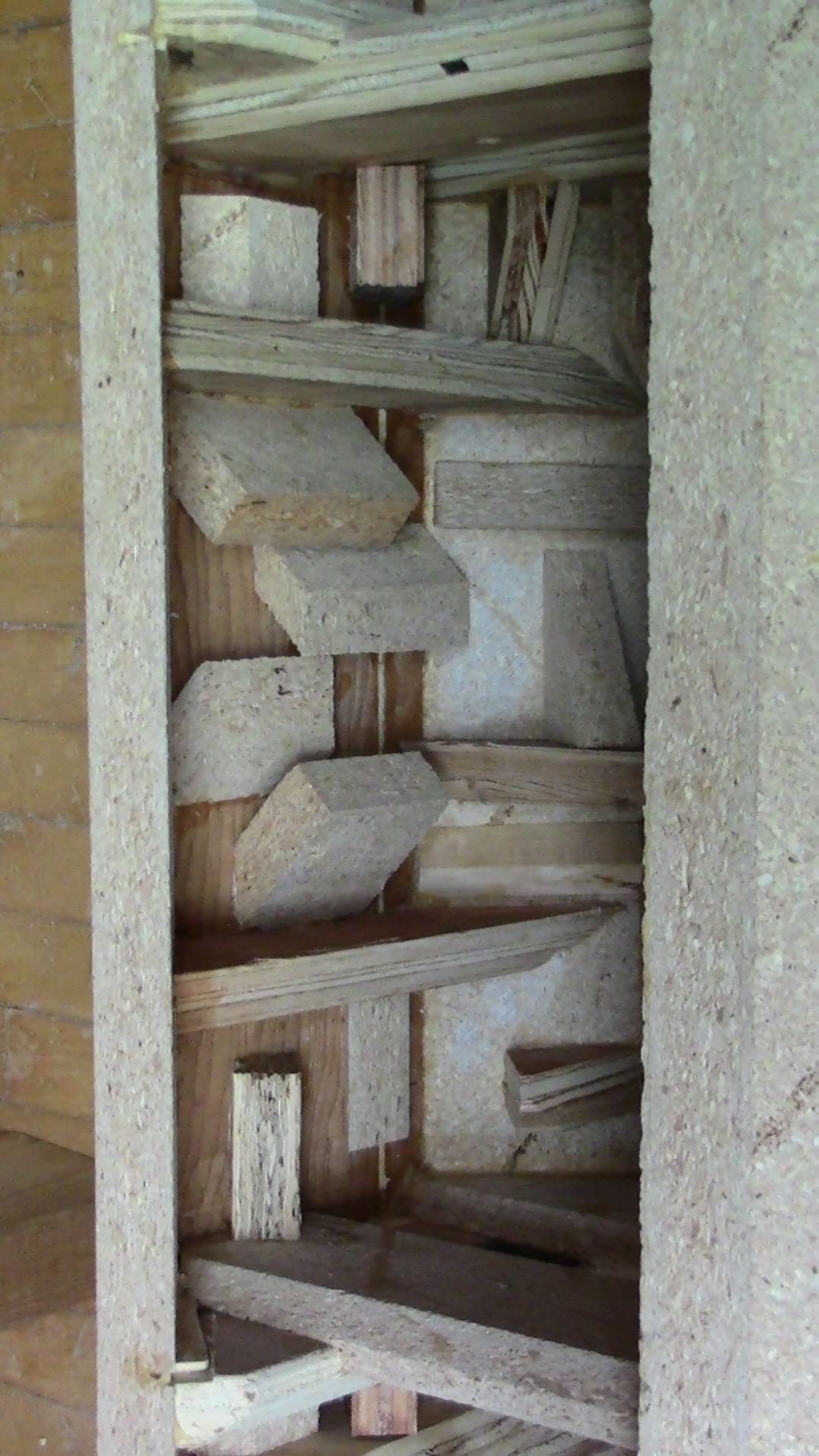

For laughs and giggles - what do You think of the insides?
I really got into this, no plan what so ever, just pure fun!
What I can say, this made a big difference when I would talk into the cabinets. This really cut down the reverb inside the box, esp with the middle and high part of my voice. It did not cut my low ranges too much though, but I am satisfied what this burst of fun accomplished. I really wished I would have recorded a sound clip of before and after thou. Hopefully I will remember on the next build...
Actually, I need to clarify the "no plan what so ever". What I mean by that is that I did not have this diffusion figured out in the beginning. I knew I wanted diffusion. I knew I wanted bracing that would break the panels up into as different as possible dimensions to spread out any resonances I had. But I had no concrete plan. Instead, I figured it out as I went along and in a lot of cases by looking at the potential in the cut offs and other pieces of wood that would normally be considered scraps. 🙂
It will make a lot more sense as I progress with the documentation of the build...

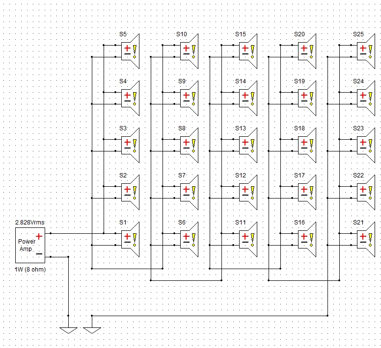

😱 You have been busy! I like that it's pretty random. It remains debatable if it really scatters and diffracts inside waves (due to the size compared to wave lengths) but it does a good job of making wall shapes random and brakes up parallel planes. Don't forget to put in plenty of damping material, fiberglass isolation being one of the best broad band attenuators. Leave some breathing room behind the driver.

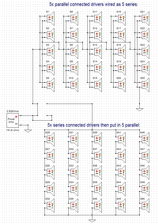

Also look at the impedance of the drivers in the enclosure to look for wiggles that shouldn't be there. Be sure to test a single driver's impedance in free air to see what that looks like.
Look at the thread from fluid for the best wiring scheme to use. The discussion started about here but the fun starts a little later. Further simulation showed some interesting differences between:
5 drivers in series connection, 5 groups of those in parallel and
5 drivers in parallel connection, 5 groups of those in series.
From those simulations it shows the 5 parallel drivers, hooked up in 5 identical series are more equally loaded. Both in terms of displacement and watts received. I know of one array here that's wired like that, the one from OPC. When fluid wired his and it showed similar behaviour to mine (a strange dip at the impedance peak) we started investigating it with the above linked results. OPC showed his clean looking impedance curves in that thread. Each dip or wiggle could lead to dips or peaks in the frequency response.
It's just a little more work but I think it's worth it if you start from scratch.
The wiring diagram BYRTT drew up in XSim for this test:
attachment.php
Top diagram in the above (each driver has it's own measured impedance curve loaded into XSim for these simulations).
Can easily be changed to:
attachment.php
That way its pretty easy to wire it all up in parallel - series without using much more wire. Start with a positive lead for the first 5 drivers. The negative wire for the first 5 drivers is the positive lead for the next group of 5 and so on. Hardly any more wire needed when compared to series parallel wiring.
If I ever find the time I'll rewire my own arrays, if for nothing else than pure curiosity. Mine are still wired as series - parallel at the moment.
