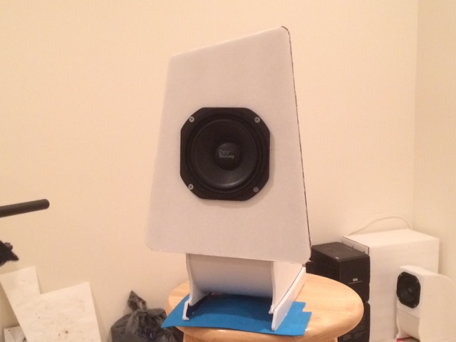

PRV 5MR450NDY Data
Speaking of data, I just completed another set of measurements using the PRV 5MR450NDY, sold as a "midrange" but reaches pretty high and has great sensitivity above 300Hz. This is using the identical trapezoidal baffle and Nautaloss rear chamber.
467597d1424650978-objective-comparison-3in-4in-class-full-range-drivers-5mr450ndy-setup.png

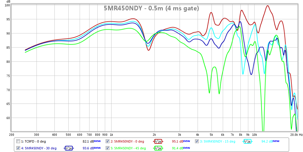

Polar data at 0.5m and 4ms gate (data resolution is 250 Hz),it looks messy but within 30 deg, the variation is actually quite low within 10dB up to 10kHz:
467594d1424650545-objective-comparison-3in-4in-class-full-range-drivers-5mr450ndy-polar-0.5m-4ms-gate.png

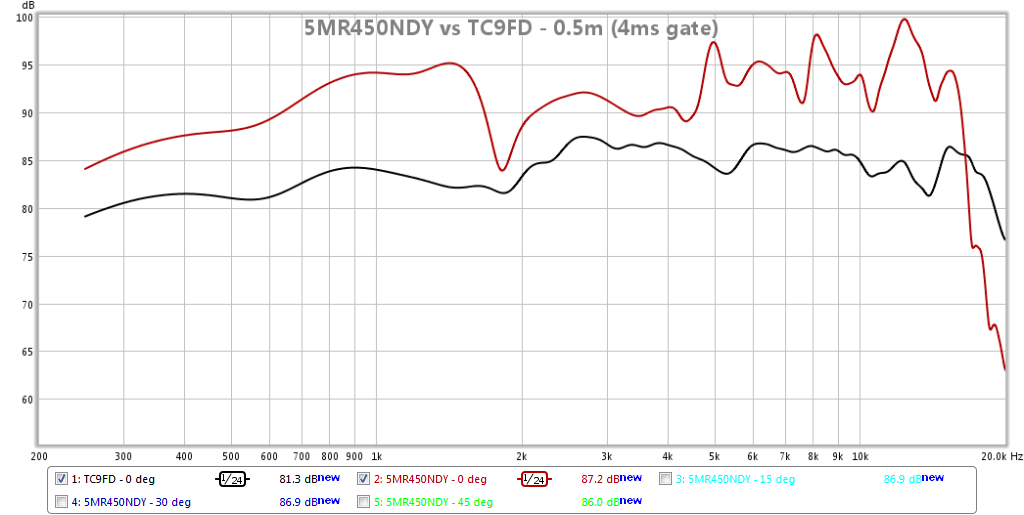

TC9FD vs 5MR450NDY at 0 deg:
467595d1424650545-objective-comparison-3in-4in-class-full-range-drivers-tc9fd-vs-5mr450ndy-0.5m-4ms-gate.png

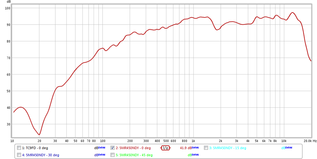

For reference, here is the factory plot:
Here is what the above 4ms gated data looks like when gate is extended to 200ms and with smoothing similar to manufacturer:
467603d1424651423-objective-comparison-3in-4in-class-full-range-drivers-5mr450ndy-0.5m-200msgate-1-6th-oct.png

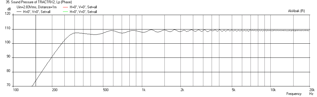

I've got 250Hz rectangular tractrix which may mate to one of those little PRV. - wish they would make a smooth 6 or 8 dedicated fullrange. Re: subjective comments, - just saying have heard mediocre multiway which sum "ok". When I can, I take some basic measurements on and off axis to correlate with balance.
The 5MR450NDY rocks when loaded with a front horn. If you want to hear something special, this is it when horn loaded. Will need a high shelf EQ boost of +10dB at 3.5kHz with Q of about 0.7 to compensate for the HF rolloff when horn loaded. SPL will be 120dB at 1m and 2.83v and cone motion in the microns so no distortion to speak of. Very clear sound. It is the modern interpretation of the JBL LE-5 but on steroids with a huge Nd motor. 🙂
I haven't seen an impedance curve of the little Vifa. I will see if i can make one sometime this week.
But i suspect that it may be hard to find. The VIFA so far exhibits poor DDR. And little uncontrolled breakup.
I speculate that the engineers who designed this driver knowing it was for the TV market heavily damped its behaviour yielding smooth response and poor DDR knowing that that would be good for the low resolution audio often associated with TV programming.
Great for MidFi, not so much for HiFi.

120db/m/2.83V must be a typo.
It seems like a nice driver, but I don't understand how it could be used. 3 way? What tweeter, probably a compression driver. But then why a small mid. Might as well go with a larger mid to get the added directivity. Only thing I can think of is something like this.
In that type of setup it could be really amazing. That in fact is the best speaker I've ever built.
That does look like an amazing speaker. I bet it can knock your socks off.
Oops sorry, yes I meant 110dB at 2.83v and 1m in a tractrix.
