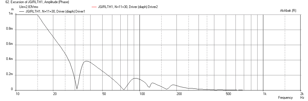

Here is the cone displacement at 2.83v running fullrange (no filters):

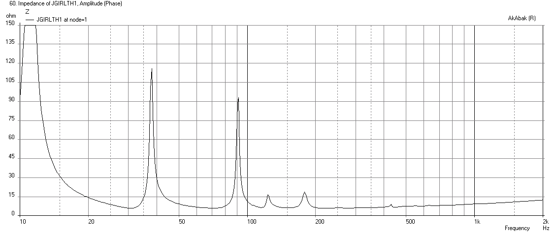

Here is the impedance:

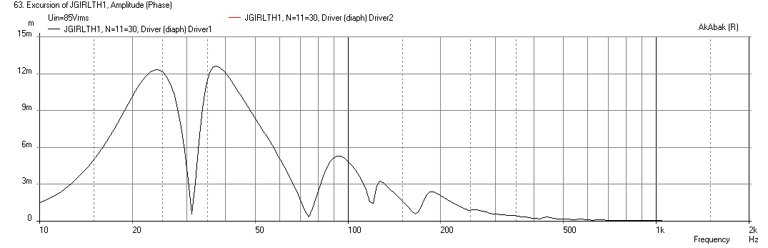

Here is the cone displacement with a 24Hz high pass (-24dB/oct) applied and 85volts to reach xmax of 12.5mm:

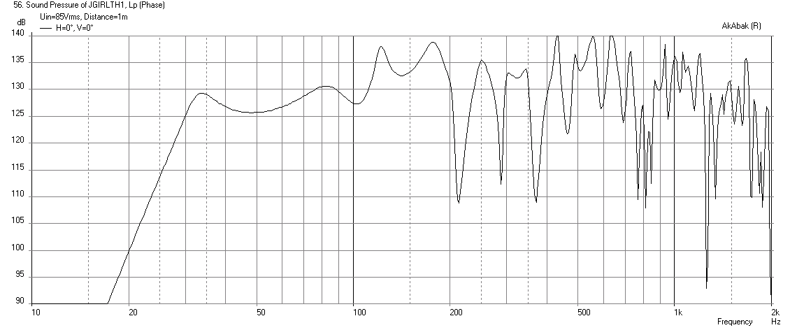

Here is corresponding max SPL at 85volts:

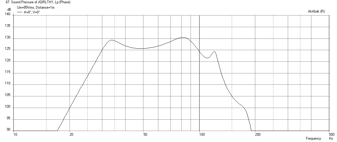

Applying a 48dB/oct LPF at 100Hz you get this:
Looking at the Impulse Response on the HPF and LPF output there appears to be a negative maximal peak at 24ms delay. This would suggest flipping phase on drivers. That delay is long and may be result of the filters?

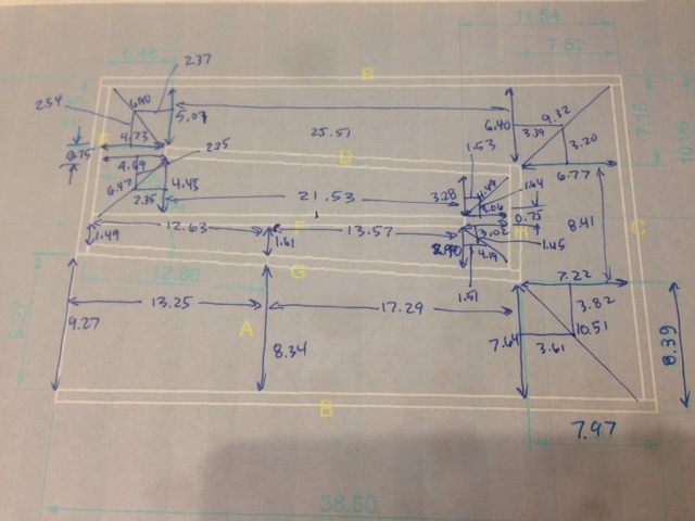

Sketch of layout and dims used on Akabak model
Here are the photos of the layout and dimensions that I used for the akabak model.

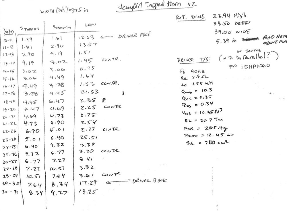

Here are the dimensions in a tabular form from the diagram above:
