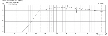

Let me run a sim for you with the tractrix design I have all drawn up already and scaled to your maximal dimensions of 39 in wide mouth. You are set on using the 8FE200 though right? It probably won't reach 100Hz in the sim, but what I have noticed is that the bass may actually go deeper than predicted. If sims pan out, just use the 2d cut templates I made.
You're the best! Yeah I have two 8FE200s. Does your template need to have a certain mouth aspect ratio? Because if at all possible I would love to keep it to 11" height, but it's not a deal breaker- I could simply scale up if necessary. Looking forward to seeing what the sim looks like!
Thanks again 😀
Thanks again 😀
The tractrix horn is designed as a 1.5 wide to 1 high aspect ratio. Which makes it 19.5in high. You don't want to to go too flat of an aspect as that may give bad dispersion and would require me to completely redo the CAD plans and that won't be possible as it is too much work. My initial sims show that this can work if you are willing to take a -10dB EQ high shelf to trim the sensitivity down to 100dB from 110dB at 100Hz, 1m/2.83v. This is what I have to do to get the sensitivity of the tractrix to match my bass as well. It is an EQ negative boost (cut) so it reduces excursion and harmonic distortion as well.

Xrk wow are you freaking kidding me, that is an 8FE200 doing full range on its own?
That is amazing! I'm sold!!
Now, another question: if that is a single driver and I still have one more available, is there any use for it injecting a little 100-150hz boost to increase max SPL? Kind of in the way you did with yours? Not really that big of a deal to me.. If I can drive that little 8FE200 with 150w contiuous that should afford me 100db to around 122db- correct? I'm not sure if that exceeds the 4.6mm xmax so please correct me if I'm wrong!
With my sub reaching 125dB at a minimum, this would seem to line up, I'm okay with LF being 3db higher than the rest.

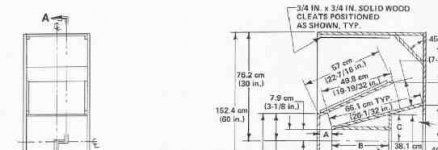

Thanks for these most useful suggestions and pic!
I think I'm still confused about how to do cleats though, do you have an example?

Hi Jennygirl,
Post #272: "...cleats...example?"
I'm just about sure you know what they are (cleats/glue strips) when you see them. Here are some examples. One way I have reinforced corners is taking cut-off corners from junk wood, and glue/staple those corner pieces into the enclosures inner corners. Seals and stiffens.
Okay that's exactly what I was thinking, but when I googled it there seemed to be a million different kinds of cleats! Thank you for the clarification 🙂
