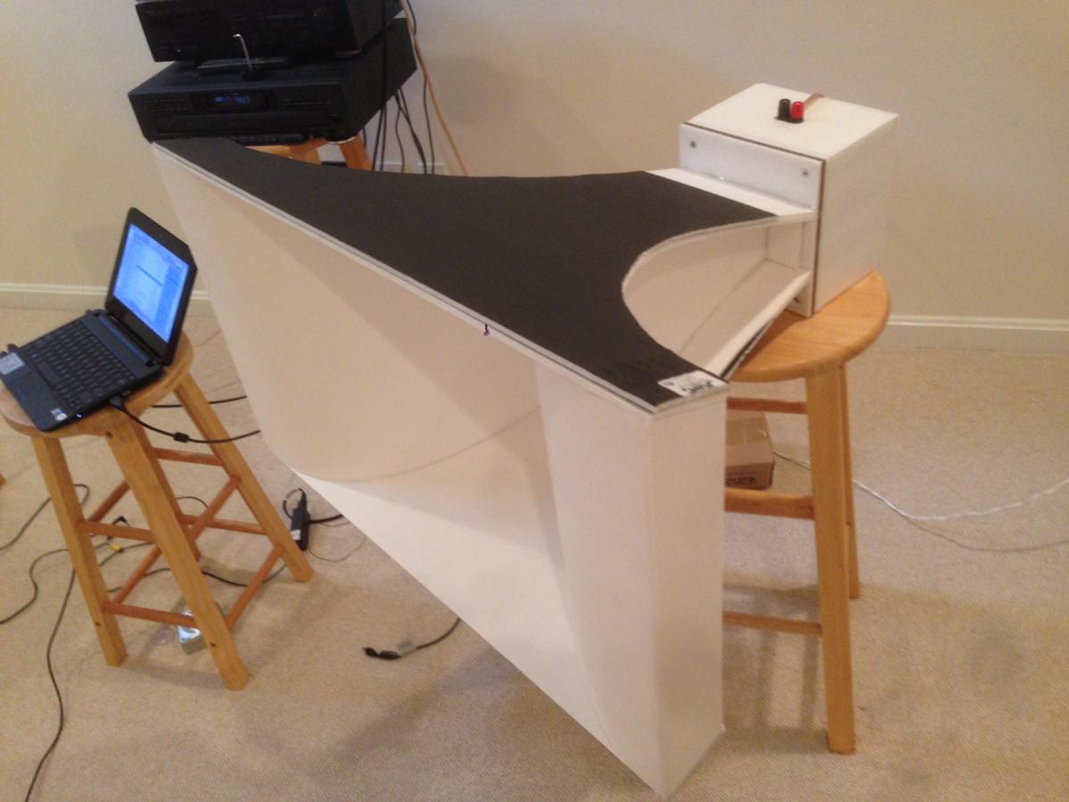

Btw, cool that you like horns. I have tried almost exactly what you did by putting a mid in very small folded tapped horn and it sounds terrible. You get reverberations and all the higher freq get muffled due to the low pass nature of the turns. If you want a great sounding mid horn - try a tractrix. I recently built one for a PRV 5MR450NDY (5 in 95dB mid with 250 watt power handling). The tractrix sounds great - very nice and super low harmonic distortion. I think a similar horn can be made for an 8in mid. It may be kind of big but sounds excellent. More info here: http://www.diyaudio.com/forums/full-range/259293-prv-5mr450-ndy-fast-applications.html. I used foam core but you could use bendy plywood or even foam core and fiberglass it if you want more durability. Info on calculating the horn profile is in link in thread to Volvtreter's spreadsheet. Also, I think you could just use the horn I designed for the 5in driver and put the 8in behind it as you are looking for mids and not full range. I can sim that in AkAbak too. It all probably go up to 4k or 5khz. The SPL sensitivity will be insane - in the 110dB range. If you use my design, a 2d cut template is provided in the thread (you can scale that up or down and it works - I scaled down to 0.7x and it works great). The 2d template is the key to making this and required me to model the horn in 3d then use sheet metal tools in Solidworks to unroll it to a flat pattern. That pattern, when anchored at the throat and mouth boundary conditions force a flexible sheet to form the tractrix automatically.
Here is the type of performance I got with the PRV driver in a 28in wide x 22in long tractrix.

Wow that tractrix is really cool. I am so down for something crazy like that. Makes a ton of sense and looks really weird/cool to boot.
How big would it have to be to cover the gamut of midrange frequencies I would need it for (100hz seems to be pretty important with the subs). My top cd horns sound great with anything above 1200 where I was crossing them in the existing 2 way setup.
I guess I could go as wide as 39". Ridiculous looking is not only okay but basically preferred 😉 ...especially with such high efficiency benefit.
