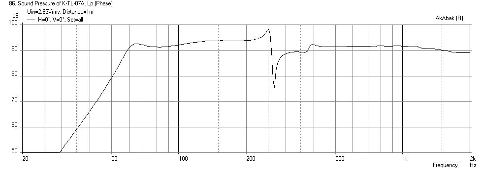

Here's an old working sim I kluged by abusing Martin King's old 'sections' sheet. There's no consideration of the effect of slot exit, but it gives an idea. (ignore the early working name... )
It would be interesting to see how X's much more comprehensive akabak sim compares. If the slight peak at 4-600 pans out, it's in the right place to fill in a dip in the FE208EZ's response at the same location. It's always nice to have complementary response..

the prototype Karlsonator 6 sounds good with a de-whizzered FE164 and also with the excellent and extended treble F6 L Cao. TheJessMan's graph of Karlsonator 8 looks very good and probably would be better if he used light fill in the stub rather than lining.

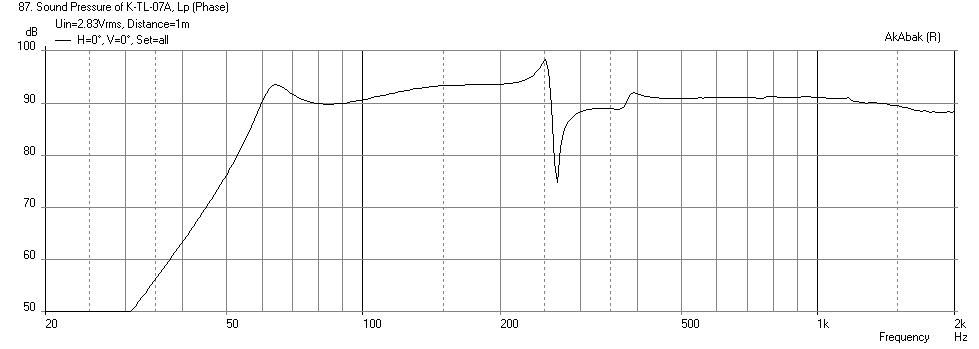

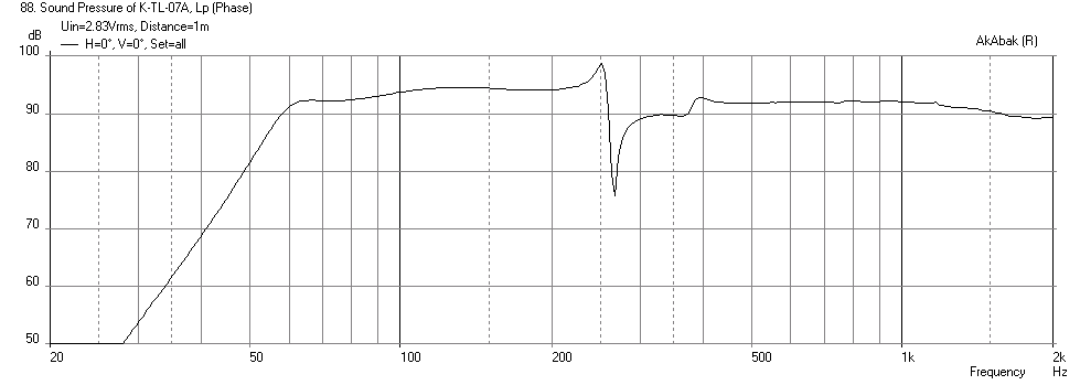

TC9FD & 4FE35-8 Combo in Same 0.53x scale Karlsonator
I got a request from a member to see what would happen if a TC9FD and a Faital Pro 4FE35 were to be used in the same cabinet. It is an interesting question and I think there may be an advantage from the standpoint that the improved efficiency (sensitivity) of the 4FE35 may help overall SPL and reduce the saddle between the lower bass peak and the mid-bass. More importantly, I think that the TC9FD has a better smoothness of the HF's. So what I would do is place the TC9FD in the lower position so that the HF's have more of an effect as they can escape the aperture in a direct radiator mode, and the 4FE-35 will have to principally, escape through the K-aperture. The TC9FD is also more pleasant to look at with a nice bezel compared to the 4FE35's industrial stamped steel ears hanging out. Wire both 8 ohm drivers in parallel for nominal 4 ohm speaker.
Here is the TC9FD and 4FE35-8 combo:
Here is the 4FE35-8 x qnty 2:
Here is the TC9FD x qnty 2:
Anyhow, it seems worth a try...
