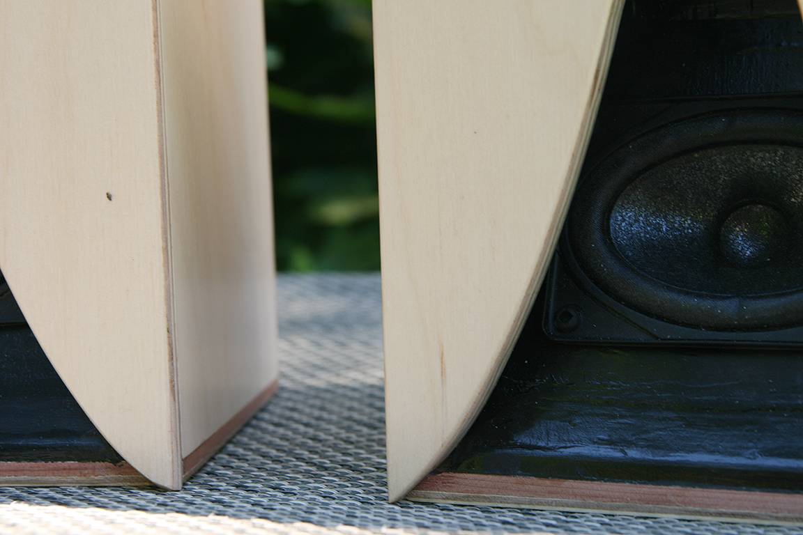

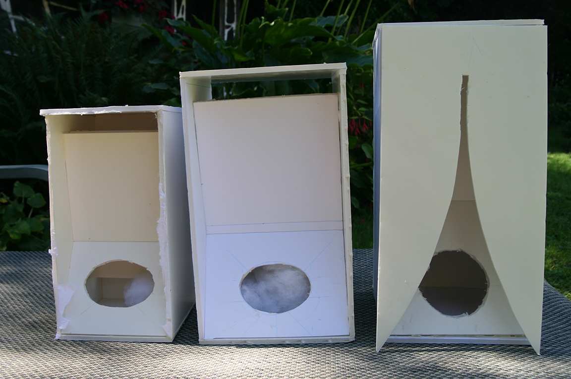

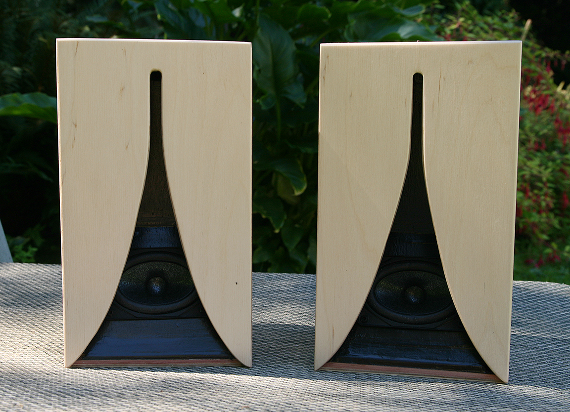

I thought I would try my hand at making a pair of wooden K’s. The drivers were rescued from some Sony plastic boxes. Not knowing any specs on them I made 3 foam core models and then went from there. After quite a bit of adjusting the filling they are sounding pretty good; a hell of a lot better than the plastic boxes. 🙂
Next will be a pair built with some better drivers.
Thanks X- the drivers are an oval 2x3". They have a fairly substantial magnet so I figured they would be reasonably decent. The box is 9.5 x 5.5 x 5.5. I really don't have a clue as to how to figure out what size to make these things. It's fun anyway.
hi prezden - those look real good and the size is great - must be one of the smallest K made so far
Thanks freddi- I think I would make them a little taller if I were to do them again. Anyway they sound pretty good so I'm happy with them.

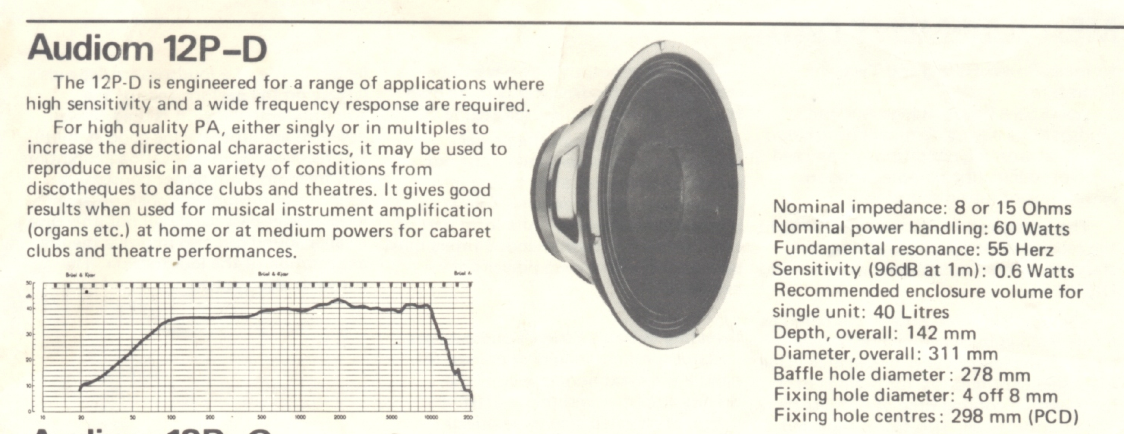

Hi xrk971,
I have a pair of 12 inch burman xp5012 speakers, pulled from a guitar amp, that I'm interested in making a Karlson or TL enclosure for. These speakers are 50 watts at 15 ohms. I have been researching and I think they were made by Goodmans. They seem related to the Goodmans audiom 12p-d. Attached is some specs. When you have time, can you do some calculation for me to figure the dimensions for Karlson and TL(and the length of the TL)? Thanks for your help.

Oh. So just scale it down with the exact proportions.
Gotcha. Thanks!
