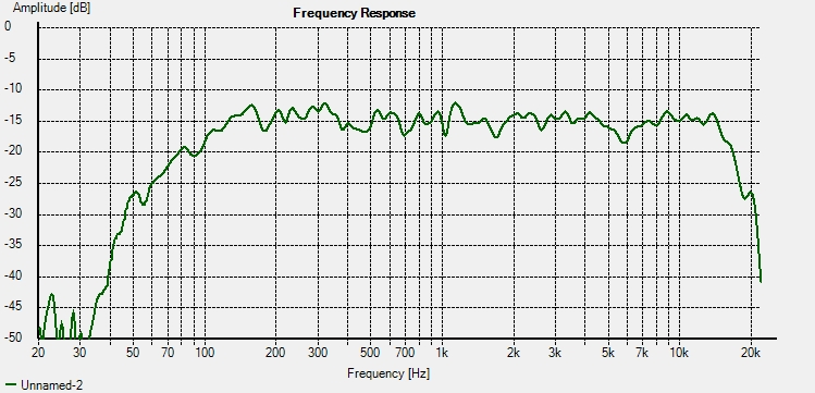

The TG9 is easy to EQ to reach very smooth FR:
Distance 40cm, 1/12 oct smoothing. TABAQ box with excessive stuffing.
In final placing the room effect and HF area dispersion have required tweaking of the BSC filter, as this (on axis) FR is good only in very close range.

You can't beat physics but the TC9FD apparently is using physics to its full extent because that huge dip at 7kHz is not there. Here are results of the TC9FD measured for 0 deg thru 90 deg. Presented on same vertical -10dB to 110dB scale as the A7. This was measured at 1 m away by moving the mic and leaving speaker stationary relative to room.
(calibrated mic and DAC using Dayton UMM-6)
These are for the dual driver Nautaloss II:
These are for the single driver Nautaloss I:
