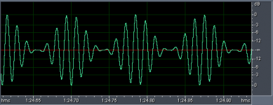

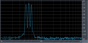

Burst waveform is excellent test signal for testing:
I have generated a continuous track of bursts with center frequency sweeping from 10Hz to 200Hz through 4 minute interval and uploaded a copy as 44.1kHz 16bit mono wave file:
https://dl.dropboxusercontent.com/s/advf4c75c4keqof/swept%20bursts%2010Hz-200Hz%204min.wav?dl=1&token_hash=AAFfz_TjpnizazdzfkfNXMOcXhYO38vIv8Z8v5zHoARyaw
As long sweep the spectrum at any point is easily resolved as a peak center frequency with side bands at 0.85f and 1.15 f:
Response recording of waveform is revealing of room interaction and distortion.
Waveform readily exercises driver excursion, and caution is advised in controlling volume at start of wave with initial use until familiar with system capability.
Slow sweep effectively energizes single room mode over any short interval of time.
In my room driving sub system with two subs each with 450 watts of available power, portions of track sound like diesel locomotive throttling up under load.
Perception of sound direction shifts with frequency.
