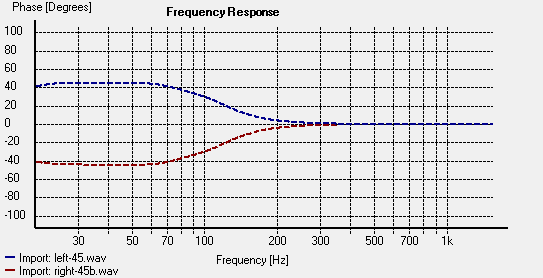

I was interested in David Griesinger's experiments (just found them) with changing bass phase. He was working fairly high, into what I would call the midrange, but still worth noting. I decided to try a little experiment here similar to what he was doing. I built a software filter that shifts the left and right bass phase by 45 degrees in opposite directions. You can see what it does below.
Certainly noticeable. It's an odd effect - midrange voices and instruments don't change place in the image, but there is a definite widening to the image. In fact the widening of the lower registers seems to peg the midrange more solidly to the middle.

This 45 degree (90 total) shift intrigues me. Since the wavelengths are huge compared to the dimensions of the typical listening room (in my case anyway), I don't know if decorrelation would achieve much more than constantly varying bass amplitude at any given location (tremolo?), but a fixed delay or phase shift would effectively move the location of a given woofer relative to the other woofer and any room boundaries. In a room where it's just not practical to put the woofers where they interact best with room acoustics, this method might offer significant improvement in acoustic frequency response where the listener sits anyway.That is my goal, also. The debate about localizing bass is important, tho - because if we simply can't, then all else is moot. Or if all recordings are mixed to mono in the bass, then there is also no point in stereo bass.

it's an interesting effect - on my system anyway.This 45 degree (90 total) shift intrigues me.
I tried his Left minus R bass and Right minus L bass approach and it certainly does "something". It sounds more spacious than normal, even with content that is not >100 Hz heavy.
What I did was remove the bass content below 100 Hz from the Left channel that comes from the right, and vice-versa. I.E., decreasing crosstalk under 100Hz. It's subtle on the tracks I tried, but pleasing.

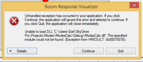

The last error is the one that I just fixed, at least on my end. I'll look into the VB power pack error as this should not be required. It may have snuck into the references.
Sorry but I still get this error with your "modes" app 1.0.0.8:
Looks like the app is trying to access files that are only available locally to your PC.
Markus
Thanks for trying. I'm still trying to figure out how to place the DLL's so that the app can find them. The "Publishing Wizard" does not seem to do this correctly.
Anyone out there an expert at Visual Studio and Web publishing? I'd hate for this to not work out as the app is so cool.

Earl,
Why don't you just list the necessary dll's so that the user can install them into their visual basic or whatever processing program is required? It shouldn't be that hard to install a dll where you need it.
