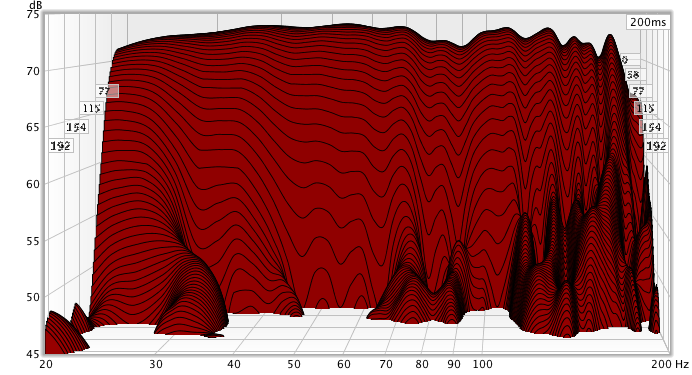

That's what I'm listening to:
Not funny but fun and no warehouse either 😉
Very nice. Result looks smoothed out by windowing below 70Hz.
Here is my sub system with detailed FR:
Also set up for nearfield listening, measurements where taken at 5ft.
When slowly sweeping with tone, sound appears to come from different places in room.
Any pure tone in closed space sets up standing wave sound field. Localization of source from any fixed location becomes impossible.
Yes, that's what it looks like but it isn't smoothed at all 🙂
How is the frequency response at different points within the listening area?
At what frequencies?
This is probably the toughest test for a stereo system. If those spatial fluctuations are minimized then stereo works the best. The underlying principle is interchannel level differences translate to interaural time differences at low frequencies.
Yeah, stereo works best with program material. Pure tones are quite revealing of system/human limitations.
I've done similar setup with sub about 5ft from a room corner and measured at >9ft, with similar results.
I really don't care about super uniform content <200Hz. Imaging cues in program material above 200Hz completely control perception of base location in any moderate domestic listening space.
Linear phase response of my sub improves realism of transients with LF content. Even this is secondary to getting flat response >200Hz.
