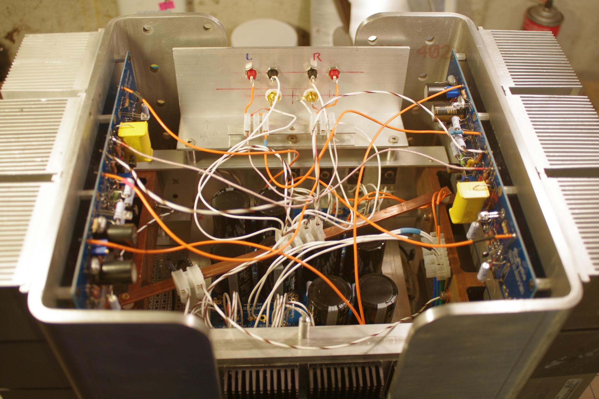

I've got mine playing now as I prepare for dinner. I'm going to give it a long good listen after dinner 🙂
First impression is of course, is very good. I'm super happy it just plays music!
I have one issue with shut off, a quick whistle/screech. I don't think it is a speaker smasher but I'd like to get rid of it. I could put in switches at the speaker terminals but that seems clumsy and I'd biet there is a clever way without adding much to the circuits (I'd hate to mess with such perfection)!
Has anyone got a quick solution?

sorry - me crystal ball is muddy these dayz .........
but ...... everything is possible with this bloody mess
😉Oh yea, you oughta see my work bench...
My first tube amp upon its completion, was like a well planned highway interchange. It was also impossible to service. Tear-down required desoldering and some of that task was nearly impossible. I had to redo most of it; now it looks like this one and I can break it all down into discrete sections as was required, quite a few times, to get it to sound the way I wanted it to.
I promise if I make another Aleph J, with the same pieces of scrap metal, I'll plan the "roads" more neatly.

enjoy for now ;
if needed - prior to powering off - pull speaker wires out
in a meantime, while listening da muzak - observe pictures of original FW amps , same as well made DIY specimens ;
just looking at pictures ........ and thinking about reasons for every wire and position of ... everything ........ will bring you some basic and important knowledge

Most of the wire mess is from a last minute shift to a three tiered approach from a two, moving the TX from over to under and then too, the admonition to have all wires to a star ground be of the same length. Add to that and my own belief that having free flowing air for the full perimeter of the heat sinks both inner and outer would be more important than many other variables in an amp so darn hot (the thing tells you of its presence even in a silent room it gives off that much heat) and you know why the wiring got so "intricate".

Hey guys,
It was a quick squeal/whistle at turn off (turn on is silent).
All I did was add some switches to the red terminals ( rated at 6A/125V w silver contacts). I switch off the terminals before the power thus no issue.
One might do a common ground for the black speaker terminals and switch/break only that to save one switch.
It all seems simpler than a Zobel network.🙂

That squealing is oscillation. I'd try to track that down if my amp was doing that, even it was just on shut down. It indicates instability somewhere.

Zobel Network will not help for the pop, it only provides impedance stability with reactive speaker loads, which may help prevent oscillation on the outputs.
The pop comes from temporary DC inbalance.
