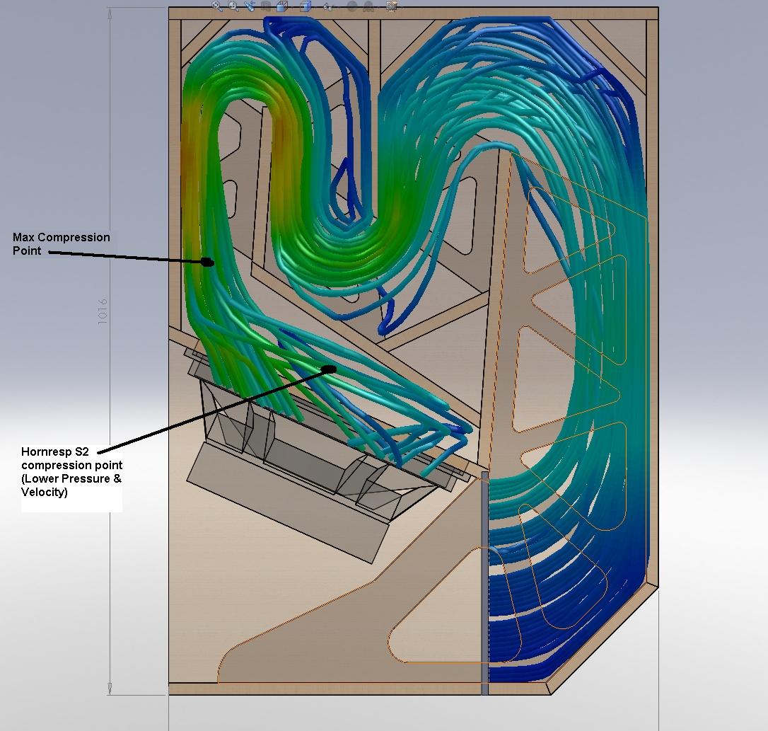

Hi Johan, that makes sense but only at low frequencies. Is that not what happens when the driver becomes unloaded below the resonant frequency and a hi-pass filter is needed to avoid excessive excursion.
I think that the maximum compression in the TH horn is reached at the point in the horn next to the edge of the driver, not the centre.
As such the Hornresp compression ratio reported is still useful information but does not specifically relate to the actual S2 point in the horn.
Flow analysis sim screenshot attached to illustrate this.
I am trying to concider what is really happening in the TH horn throat.🙂
Regards Martin

What software are you using to model the 3d flow inside the speaker cabinet? Nice work! My question is since the flow is oscillatory, you have an asymmetry of the flow patterns in the forward vs reverse direction due to corners and edges that would cause separation in one direction and not the other. Is this accounted for in your simulation?

Xoc1,
X
QUOTE]
Hi X......
The simulation was done in Solidworks, which in the 3D cad program I use for all my speaker modelling.
The flow program that comes bundled with the software is quite basic. It gives me the option to use Spaghetti like threads or particle like balls for the flow simulation.
The flow analysis screen grab that you re-posted shows the speaker as a flat piston - but it is offset to account for the volume of the speaker cone. This demonstrates the difference in compression along the speaker path with the maximum compression occurring past the S2 point, close to the first speaker fold.
I would not read too much into the results.🙂 The flow analysis assumes a linear flow.
