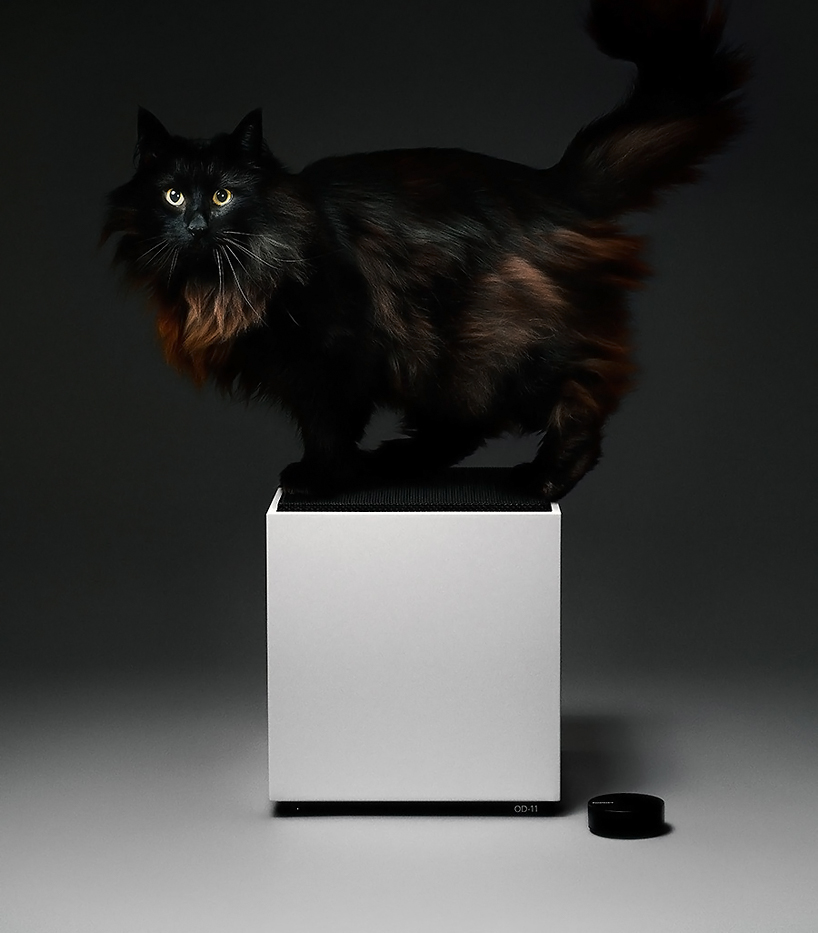

BTW new Swedish flooder:
OD-11 - Teenage Engineering
http://assets.sbnation.com/assets/1967869/OD-11_Flyer.pdf
