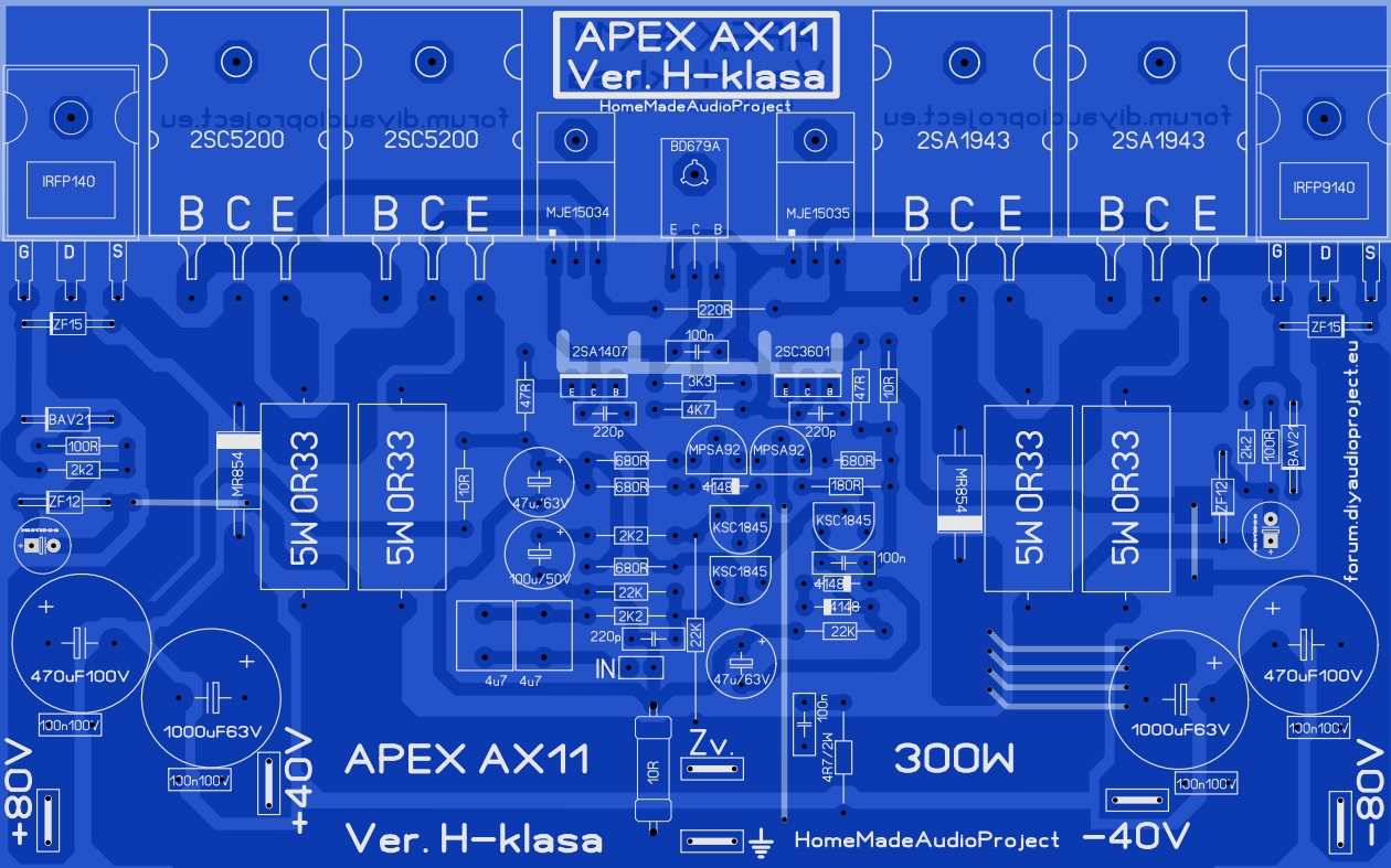

I have some question because i am confused.....Is ax11 and ax14 the some amplifier?
who owns the name ultimate amplifier?
I want to make an amplifier using 2sa1295 and 2sc3264 transistors
Can i do this with AX14?
Where can i find P.C.B in pdf format?
Thanks for all
Thimios.

No in the last pages you can find HX11 not AX11 .
HX11 is a mosfet autput amplifier class H.
I can't find AX11 and pcb ......can anyone help?
Thanks.
They are diferent topologies and i recommend ax11 which you can find pdf in the last pages

Check from page 193 onwards...
Thanks Mr Mile for you reply, and I can say that it works very well !! Soon I will post something, I hope

yes,200W/4R with +/-50V PSU and single pair of MJ21193/94 as output transistors

Finally this is HX11 as i can see.Is this recommended amplifier or AX11?

Is this confirmation that pc board in following post is working ?
maybe this will help:

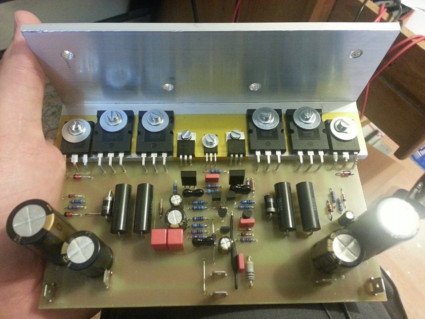

AX11 under constraction
Thanks for instant reply
Good news!It works. See posts 2102 to 2110.
regards
My opinion is that MPSA13 must in thermal contact with main heatsink.
Any replacement for mpsa92? can't find it in my place..
Nice work .Sorry, fotos.

Hi Boris i like your PCB but i can't use because your PDF have gray collor on pads.As a mater of this low contrast and over etching.Here is more elegant version of previous pcb.

Nice work .
Ok. Therefore it is on the right place.
