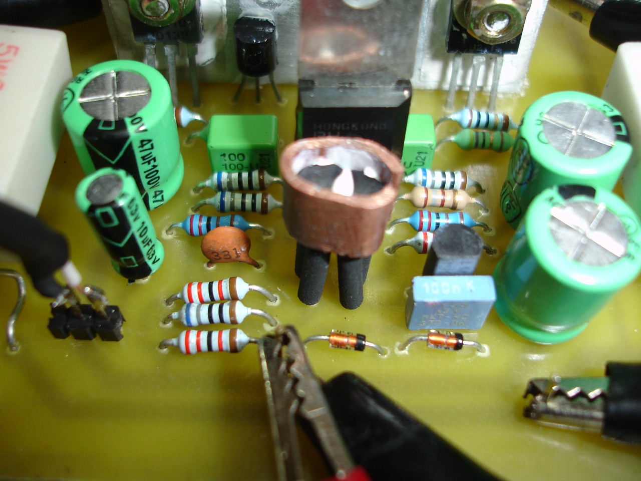

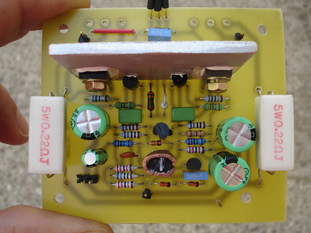

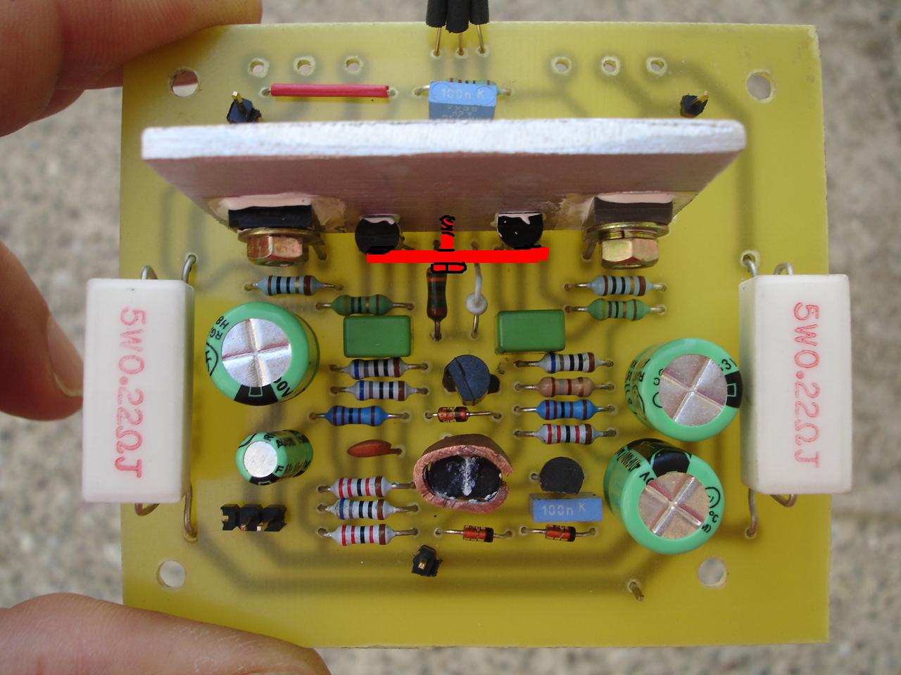

Sorry, I mean the PCB is ok for mounting on main heatsink. On my prototype it is on the other side of PCB.
regards
regards
Nice work .

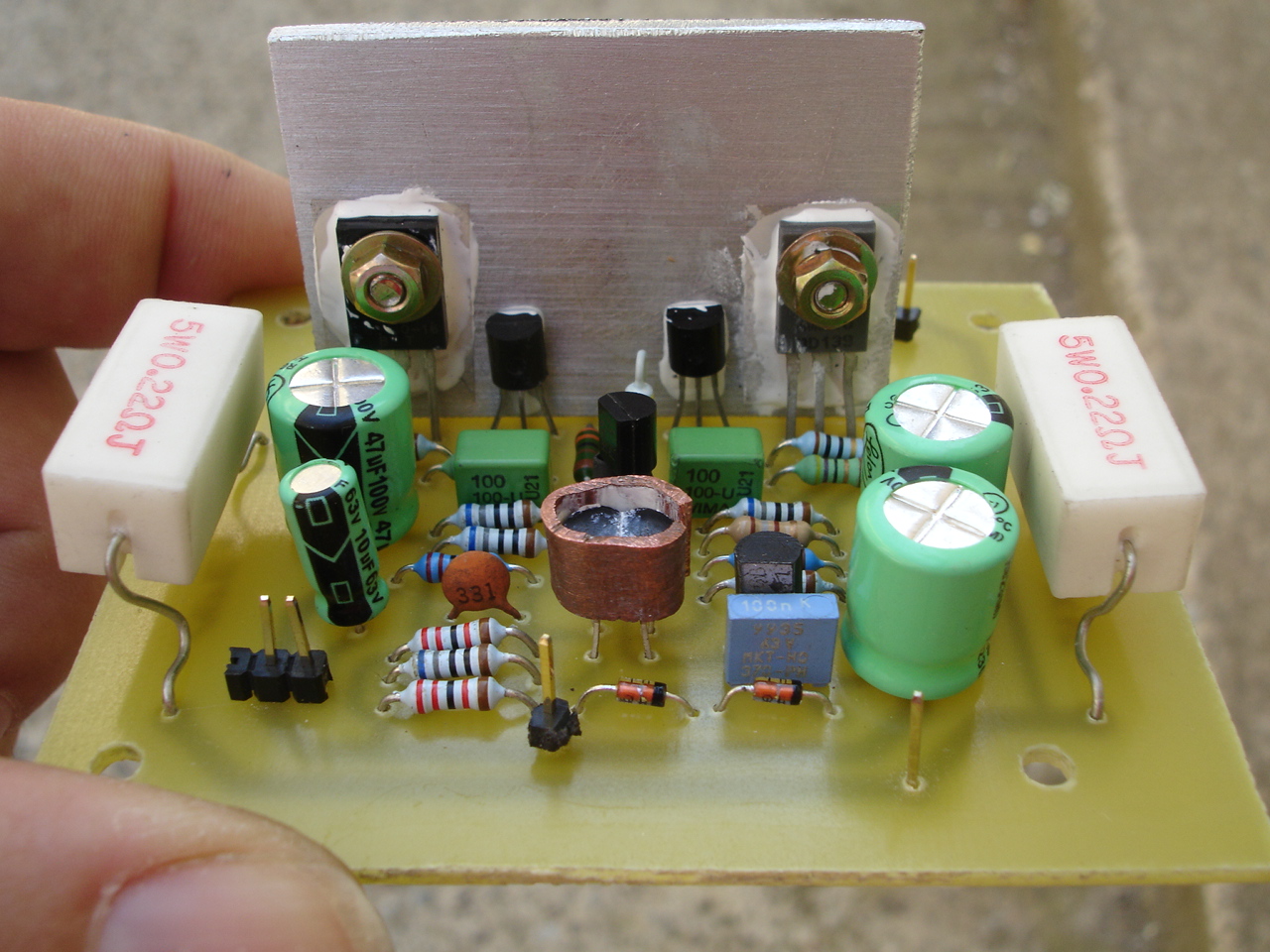

My opinion is that MPSA13 must in thermal contact with main heatsink.
Any replacement for mpsa92? can't find it in my place..
MPSA92 can be replaced with 2N5401
AX11 under constraction
Thanks Apex but 2N 5401 arivved in few days and i Anxious to listen today.🙂

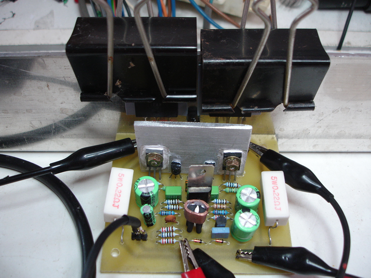

What is your rail voltage for test, BC556 can be use under +/-30V.

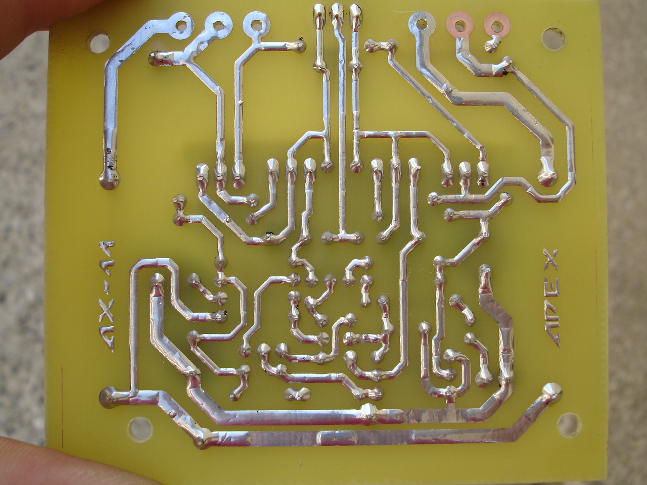

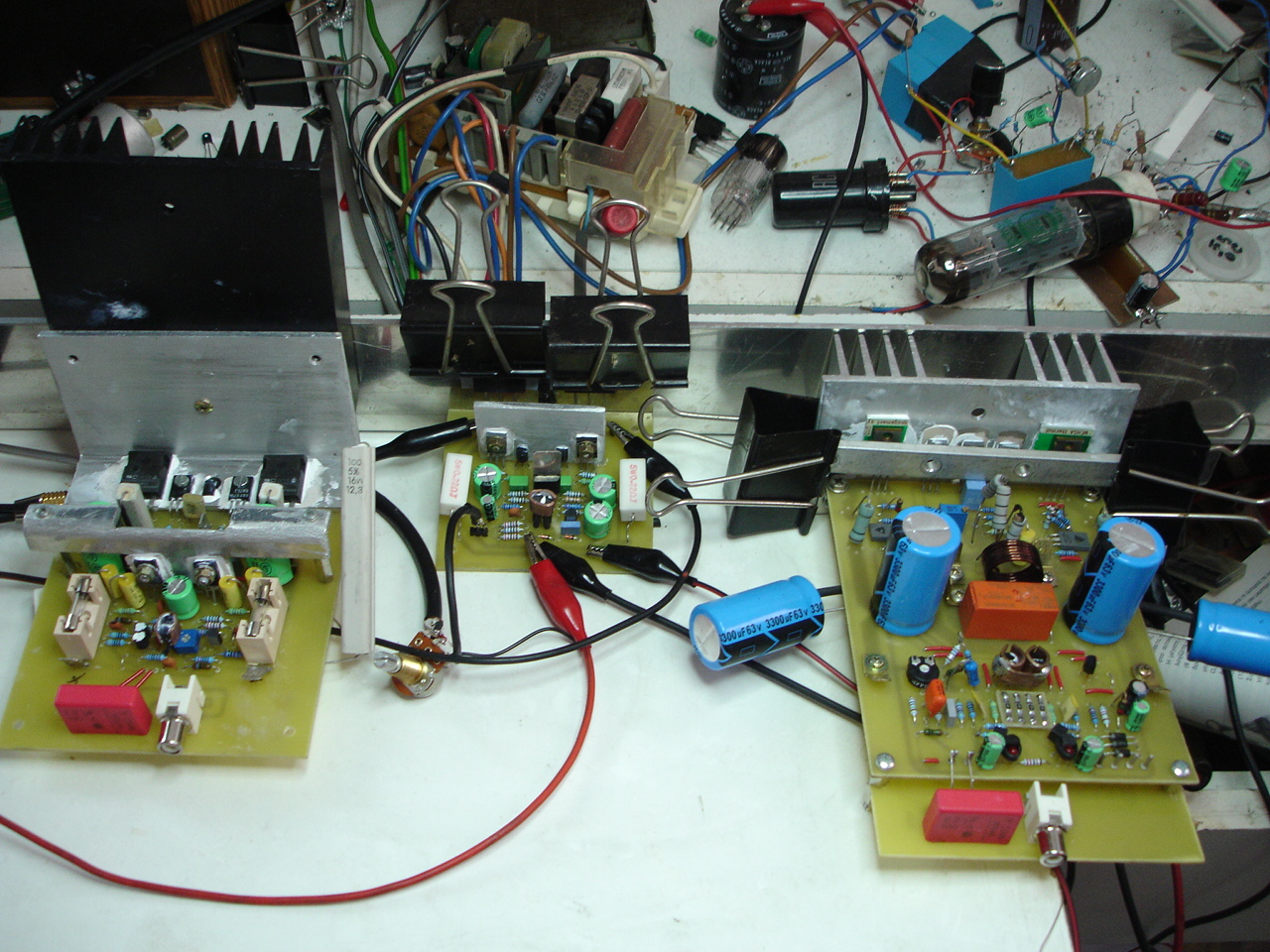

AX11 under....test!
Hi Mr.
As i promise the AX11 is here today🙂
bf 872 instade of mpsa92 diferent base
2n6427 instade of mpsa13 same base
2sa1943
2sc5200 final out
Tested rail voltage +/- 23v from two stabilized power supplies
Thats for now ....coming soon on youtube!
For listening of cource.
Thanks Mr Apex.
Pai attention ..in first two photos bd139 and bd140 wrong position!

AX11 under....test!

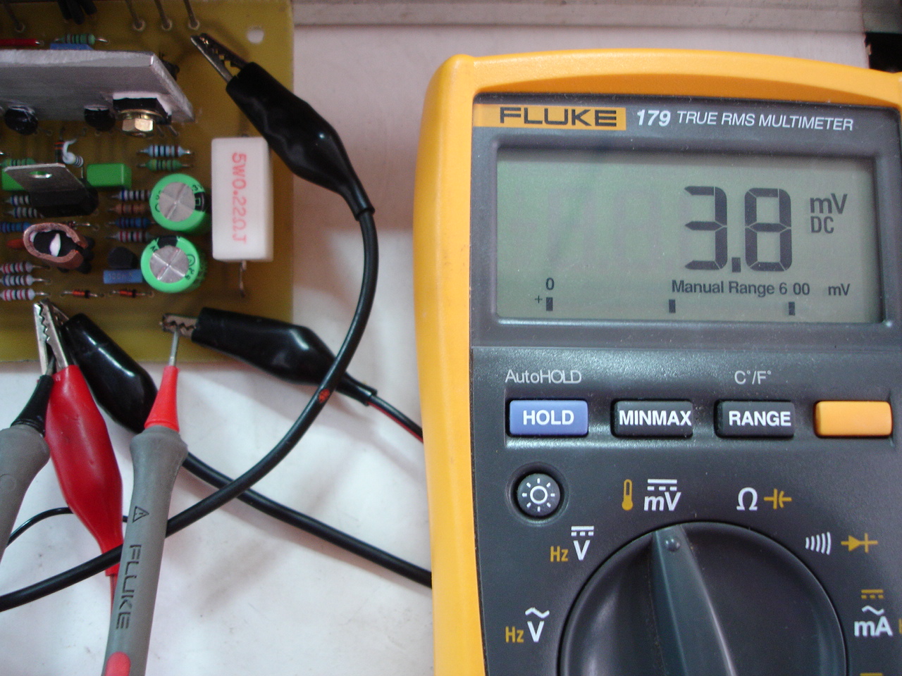

Testing this amplifier today i see that idle current at rail voltage+/-22v is 0ma.(v on 0.22R/5w is 0mv).
Mr. Apex can you post the max +/- rail voltage for this amplifier.
Can i use +/-42v ?
What about idle current?
Thanks for all.

AX11 rail voltage is +/-40V (+/-50V max). Idle current can be adjust like in BA1200.

AX11 under....test!
Instant replay.
Many many thanks!
Suppose with different value of 3k3 on base of mpsa13 or trimer....
And what value is suggested for +/-42v?
Again thanks.

Use trimer and set about 15mV on 0.33R/5W

Nice you can fix VAS transistor to heatsink for better cooling like this:
