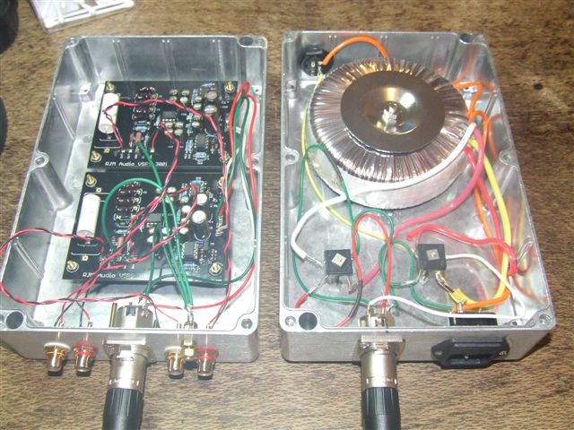

After the clone, I built the VSPS 300 and a larger (100AV) power supply inside alum case. When I first tried it, I laid the power supply on the TT dustcover and had notable hum until I moved it away. Once moved, there is near silence at high volume settings @50dB gain setting.
I'll return to pfcs49's excellent build report shortly. First a quick comment about the power supply placement.
Internal will most likely work fine, if you are moderately careful. External is pretty much idiot proof.
I have found that the interference from the transformer is most severely transmitted directly to the phono cartridge, not the inputs of the phono stage itself. From this view, it's not so important to separate the boards from the transformer, but the transformer from the turntable. If you like to have your phono stage sitting next to the TT, then I recommend an external supply.
The other issue is grounding. With an external supply there is no reason to earth the phono stage chassis, and this avoids the possibility of ground loops developing with the amplifier, which is usually earthed. With a one-box build you may have to connect phono GND to the chassis via a 50 ohm || 0.1 uF link to break the loop.
In truth, no one who has build a one-box phonoclone has reported problems, so I might be worrying over nothing. It's only been 2-3 people, however, a very small minority and all of them definitely fit into the "know what they were doing" category.
The transformer is a perfect storm of magnetic interference!
Even getting it near the tonearm likely produces (quite) noticeable hum!
If you use toroidal transformers you should be OK as long as you put the phono board on the other end of the enclosure (added metal shield would be best). That said, my phono preamp has a seperate enclosure for the regulated PSU... I did that so I could swap phono boards and keep the power suply the same. Build a new box with different phono section, just unplug the embilical and swap. It's all good.

Rectified, unregulated split supplies from 2x12 VAC 35 VA or larger transformers makes a very useful general purpose power source, good for just about anything from phono stages and DACs to line level to headphone amplifiers. Using multiple, common sockets and cables means you can swap different projects in and out without having to build a power supply each time.
Returning to your VSPS300 build : it's nice to learn that switching the gain resistors can be done on the fly, without the extra wiring leading to instability issues or noise pickup.
If I was doing it-
I would have used a much larger case. As things are, you cannot access the boards without disassembling the front and rear panel jacks and switches. Components have been bent to fit, which is always a bad sign.
I would have made a daughterboard with multiple sets of the gain set resistors pairs, and probably a DIP switch on the board to select. Just three wires back to each VSPS board. Keeps the wiring length down to a minimum, and VSP board layout free of any extra clutter.
"I would have used a much larger case. As things are, you cannot access the boards without disassembling the front and rear panel jacks and switches. Components have been bent to fit, which is always a bad sign"
I love these cases for their accessibility. Remove the 4 upper screws and the top half lifts off as in my pictures.
Remove the other 4 and the ends come off with all connections intact. Then simply slide the boards out of the bottom through the grooves in the case and everything is on the bench ready to run and totally accessible.
About bending stuff: I could have not bent anything (I inclined the 4 RIAA caps) but access to the R3 terminal block would be difficult. Also, R4 flush with the board would be against the R3 block and I thought moving it over a little and insulating the legs w/teflon tubing a better plan. And the gain switch and wiring are easily removed and R2/R3 installed across bays 1&4 of their respective terminal blocks. The rotary swx fits with room to spare around unmolested components.

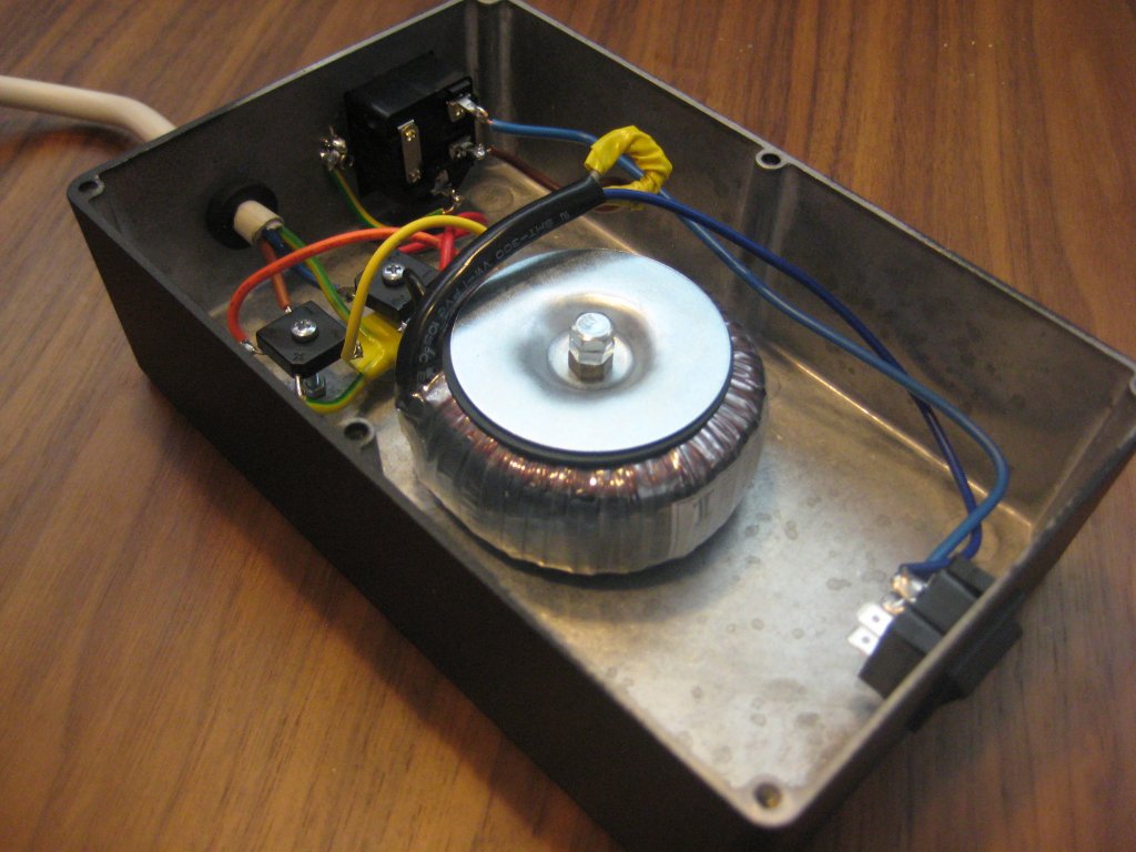

Newbie help
Building my Phonoclone 3 and power supply. Just a couple of newbie questions:
1. What gauge wire should I use for the connections to the RCA jacks? Should it be solid copper or stranded wire?
2. What kind of wire is used for the connector between the power supply and the audio plug that plugs into the phono preamp? A microphone cable? A power cable? Can I just cut up a PC power cable and use that? It looks like it is a three wire cable, but I can't seem to find a source for less than a 100 feet of three wire cable.
3. My transformer did not come with any hardware. What is the metal cap in the pictures below called? I don't know what to look for on Digikey or Mouser. I guess I don't need one, but it looks like it holds the transformer in place nicely.
I am using these pictures as my guide, which I found on this help forum.
Thanks.
You can use whatever you feel comfortable with. Solid core 24 AWG works quite well.
2. What kind of wire is used for the connector between the power supply and the audio plug that plugs into the phono preamp? [...] Can I just cut up a PC power cable and use that?
YES!! That works just great.
Unless your transformer has a potted "plug" with a hole drilled in it, you will need those rubber/metal plates and the bolt. I doubt these are available off the shelf at digikey, I've only ever seen them included with a transformer. However it's not too hard to make a bracket yourself from a bit of wood or plastic. It doesn't have to be round.
