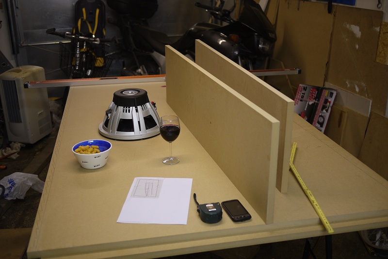

A bit of red wine, a 12" subwoofer, a bowl of peanut"fingers", a man with a mission and a 140kg 11 piece pussel. Perfect ending of the friday evening (wife and daughter fell asleep together, perfect 🙂 ).
The start of horn nr 2 build 🙂
