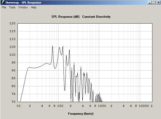

After looking at your SPL measurements I took another look at the Kraken 212 Hornresp model, and found that it could be improved (i.e.: made to fit the enclosure drawing better):

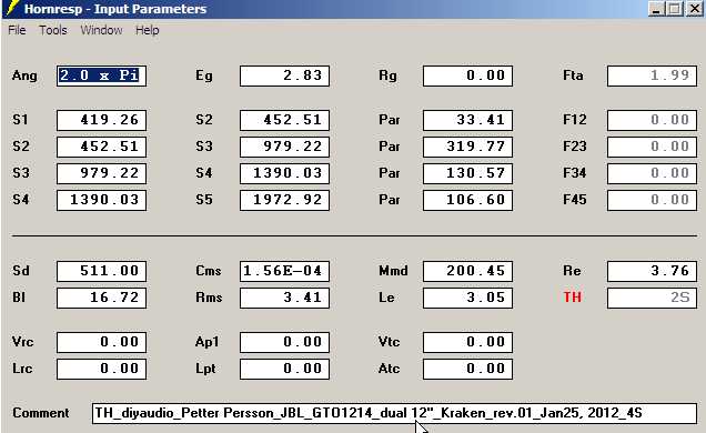

Hi barco,
Sounds good, but since I only "stole" the design from Petter, I have no idea what the values in hornresp means 🙂 (well, I know they are dimensions).
What have you done to it, have you decreased the output area?
Hi barco,
I redrew Petter's exact enclosure in AutoCAD, and remeasured the centerline using soho54's method for the corners. I did not change a thing about the enclosure, but went in the model from 3 horn sections to 4 horn sections.
S1 and S2 remain the same, as does L12. S4 becomes S5, and S3 becomes S4, L34 becomes L45. The former L23 is split into the new L23 and L34, and a new S3 is located in between the new S2 and S4. The location of the new S3 is adjusted to improve the fit between model and drawing.
Even if you're not using Hornresp (yet 🙂) you can see at which frequency the response peaks, etc. are supposed to happen.....

Hi barco,
Post #191: "...share the new design?..."
There is no new design, just an updated Hornesp model as shown in Post #187. For your information I'll attach the drawing from which I gathered the information. Again, the enclosure is not changed.
Ahhhhh!! NOW I get it 🙂 (finally!)
I thought you made some changes to how to build the horn, but it was the hornresp model that you changed to better reflect the measurements I have.

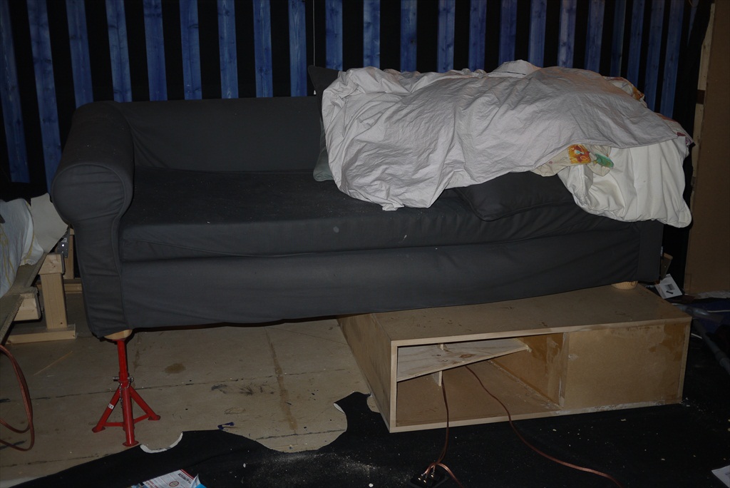

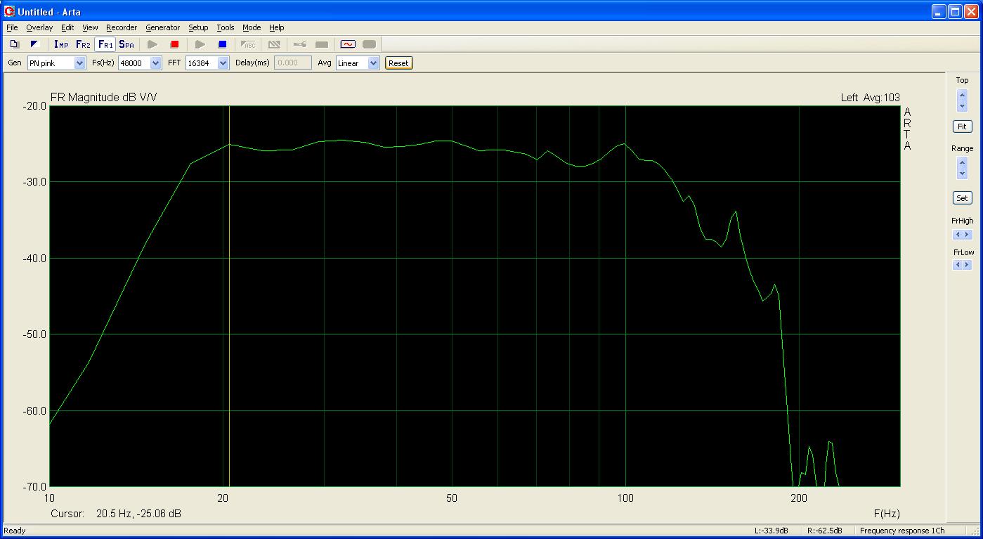

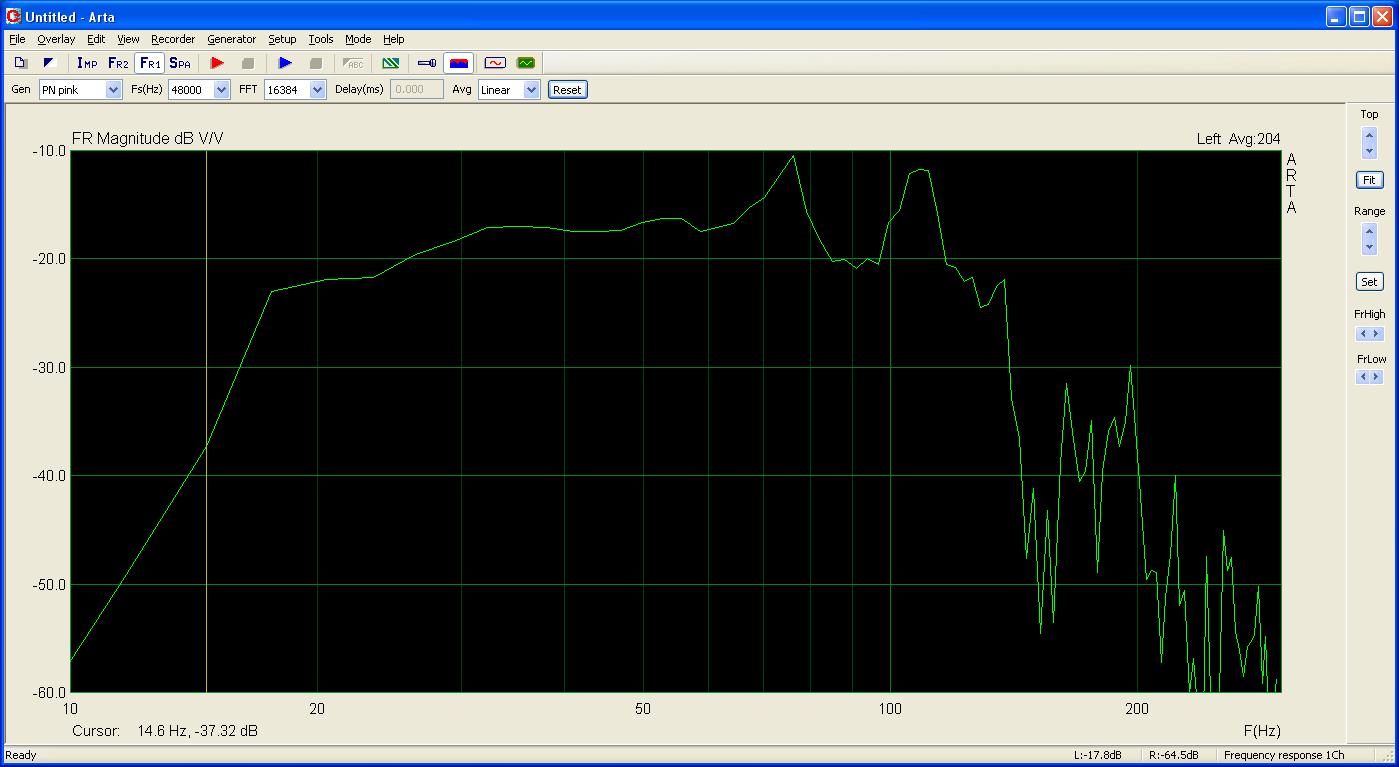

So I have made some more measurements with open vs "closed" (not really closed, but almost half of the mouth closed).
There is differences, yes. But not that much (at least I dont think so).
First, new measurement "same as before":
Second with "closed" mouth. Exactly the same setup with everything else (volume, mic placement etc):

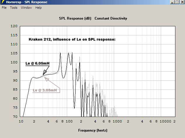

Hi barco,
Your measurements in Post #196 both show a bump in the 30-40Hz region. I get a similar bump in Hornresp when I double the driver impedance (Le). As the driver impedance in the sub 100Hz range is usually not anything like the manufacturer's Le specification (which is normally measured @ 1kHz), a rising Le in this range may be the cause.
At the very low end, below 20Hz it looks like your system may have a low cut filter. Do you have any way of testing for this?

Cool 😎 Looks a little bit better with the mouth partly closed. What's the difference in sound?
Difference in sound? Does that matter? 🙂
I have no clue, have just done the measuring for now.
I am guessing (dont know) but that closing the mouth would affect the "connection" with the room/air but that is just my amateur thoughts...

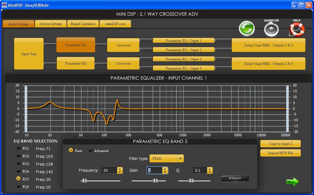

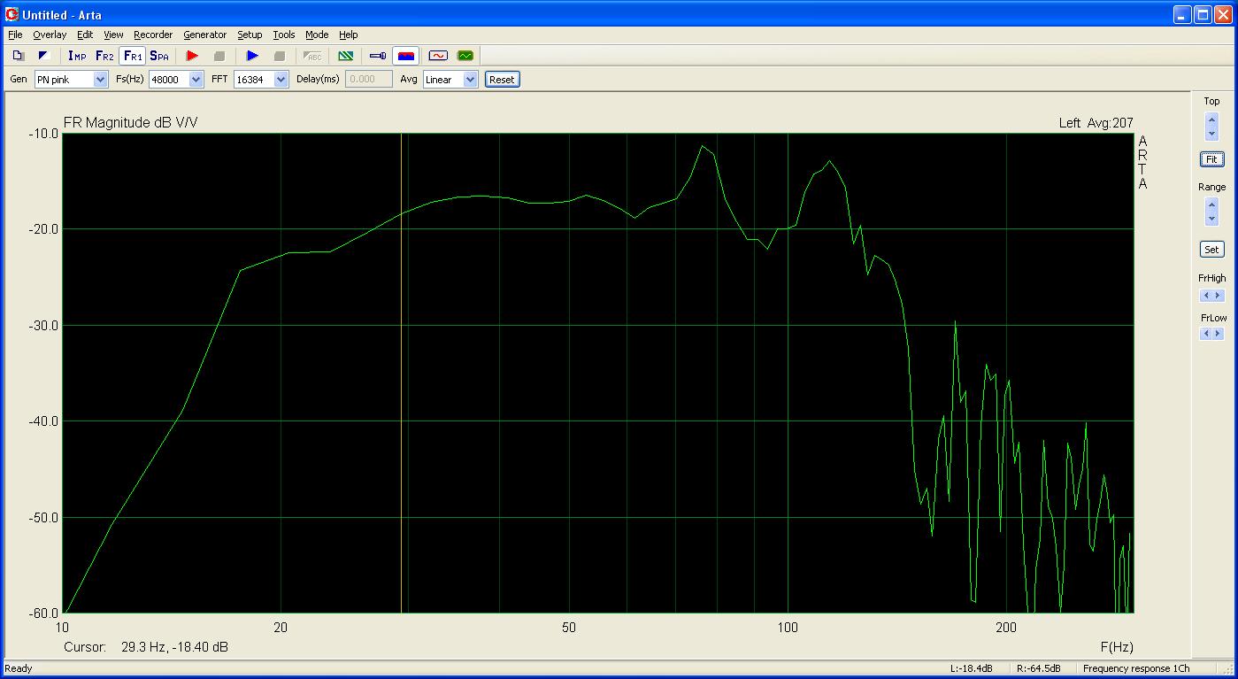

I connected the minidsp and played for a few minutes (yeah, maybe more) and now I have this graph instead :
The minidsp has to be the coolest thing ever....
Added a bandpassfilter (-48db/oct on 10 and 130 Hz) and 5 PEQ points.
Here is the PEQ graph in minidsp:
