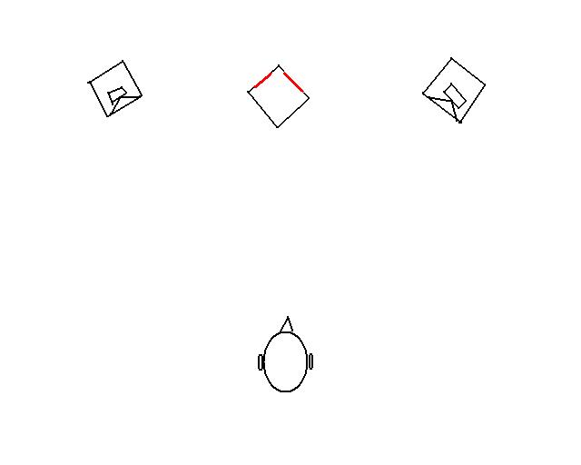

Upgrading the stereolithic projection. Removal of the pillow direct sound blocker. Low freqs are handled by crossed dipoles ! This way it is possuble to set the required level of direct sound attenuation by toeing the dipoles. The attenuation is possible through the whole audio band. High freqs handled by side firing box system.
- Elias
It should work, but would only work for one listener in a fixed position - Dipole nulls are pretty narrow. This might be okay for some individuals.
Dipole configuration would be critical as well: treble creeps into the null on many dipoles because baffle width exceeds high freq wavelength -- can't form a null at high frequencies. A ribbon on a very narrow baffle could pull it off.
. . . perhaps the treble can be controlled with a waveguide, or a pillow on the baffle edge, or use a beamy fullrange driver . . . hmm. . . 😱
Well, this IS a stereo system !!! 😀
Even though discussion in a stereo loudspeaker thread was not encouraged 🙁
Listener is not in the dipole null, but off axis ! Only requirement is attenuate the direct sound at least 10dB. 10dB is approximation, it could be less than that is enough. Markus was explaining about 5dB, so...
Dipole is for low freqs only ! Easy 🙂
- Elias
Thinking again:
This could also work as a base for stereolith below 1kHz
Directivity gained by an array.
Plus, if made in a box no back wave.
The crossed dipoles do have back wave, but because it has some delay, and it's negative phase, it could turn out enhancing spaciousness 😀
- Elias
