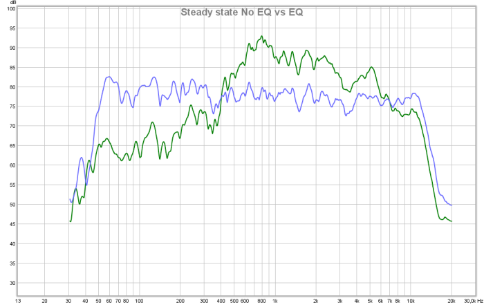

Same drivers, same EQ, this time simply put on the floor, as close as possible from the back boundary, 4.5 m from each other, 6 meters from the listener.
Since a while I wanted to verify this, to make sure that graaf or tinitus were not too sick.
Result : it's shocking when considering that it's the same drivers than 1 minute ago. All the claims of these gentlemen are real, with the drivers set up like a flower pot (but decoupled from the floor with thick rubber).
Not only the soundstage occupies all the wall (9 meters here) but there is eventually a strong center presence, it's ok for girl and guitar as for giant choruses or symphony. The trains circulate progressively. I insist it's not a mess up.
The Hf is not perceptually reduced (- 2 dB roll off at measure), and that's puzzling because the part over 2500 Hz stays in a 10° cone @ 0 dB. Even with one only running, the source is unlocalizable. Subs are not mandatory except for organ.
For me, adept of multi ways-multi amped systems, this is a double bottom kick : the flooder and the FR. Just the envelopment and perspective are not very good, all this is a kind of 2D image. But for 33 euros...

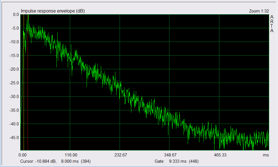

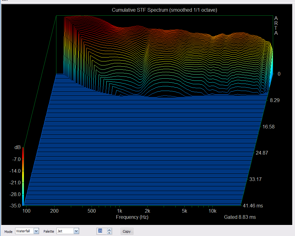

joined plots : > steady state of the flooder from 6 meters
> CDS with short gate (ok, it's 1/1 smoothed and has a lazy decay, but could be much worse)
> ETC with sub on (mistake), no floor bounce, the 9.33 ms peak is the side wall.

Nice experiments, Radu!
The steady state plot of the flooder tells me two things:
1. I truely believe that such a well balanced response sounds nice - regardless whether it originates from a flooder or a direct radiator.
2. The same plot tells me, that this same driver must be a screaming monster when pointed directly (or almost directly) at your face. And yes, tweeters which are much to loud and/or distorting - compared to the rest, can "glue" the image to the loudspeakers.
Rudolf
Rudolf

PS : the CSD are 1/1 and Hanning window for the beauty of the picture , with less smoothening it's a real porcupine. Just representative of the general balance.

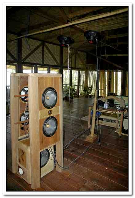

joined docs : > the on axis CSD of the facing & swinging driver (1/1, 4.50 m, no gate). It's not an anechoic room.
> these heroic drivers as they were this morning (speakers behind the listener)

Here are some revelations about the flooder's secret life.
First point : Nothing easier than put a naked driver on the floor, but the reproductivity of two measurement sessions is highly compromised, because a flooder placement is very critical. +/- 2 centimeters and monstrous dips and notches appear, even with 1/1 smoothening, it's impossible to get a flat CSD with a similar steady state curve.
As a proof of the malediction, look at the CDS ladder. The never seen before transversal ridge appears because of a 20 cm displacement. The dimension of the difficulty is best seen with the next plot, the raw driver before and after massive equalisation.

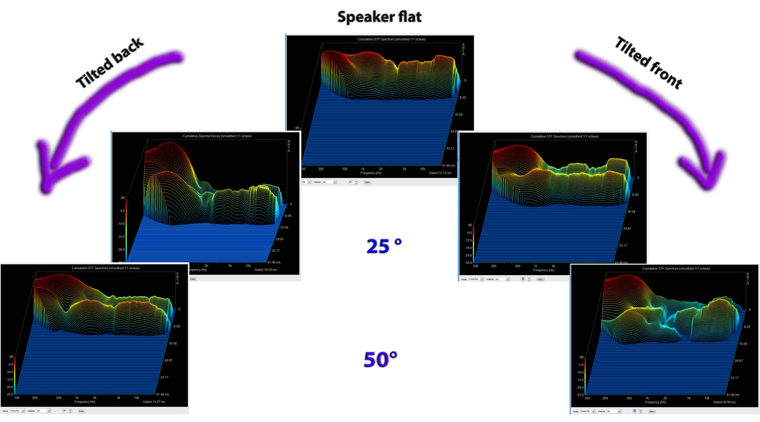

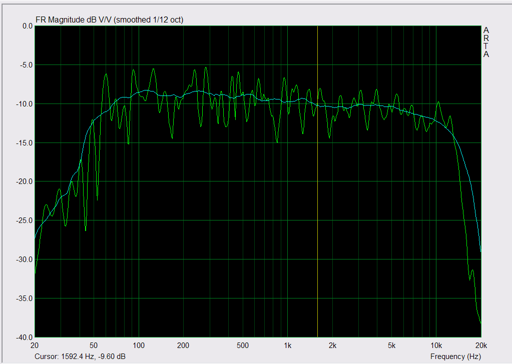

Second point : after choosing an arbitrary position, and doing my best to have something presentable and listenable, the question is What is the influence of the driver oblique orientation ? I did only the frontal plane.
On the FR plots (REW window) tilts of 25 & 50°. (flat driver, 25° front, 50° front, 25° back, 50° back and 35° back with EQ adaptation).
Surprise, the HF level stays unchanged, but the 100/400 Hz zone is very affected. Not very clear here except on the lateral thumbnails, but tilted frontward or back ward it's almost the same effect. The frontward tilt (thumbs 2 & 3) show a slightly increase of the HF.
The explanation is maybe the dipole null that is very neat in the lower octaves. When tilting, the mike see more the reflected image of a lobe (front or rear). Or the cancellation was boosted by the flat floor ?
Practically, this allows less EQ gain and then a better headroom.
HF are not very concerned because of the extreme directivity of the driver. Any way the sharp limit of the boosted low freq is very intriguing.

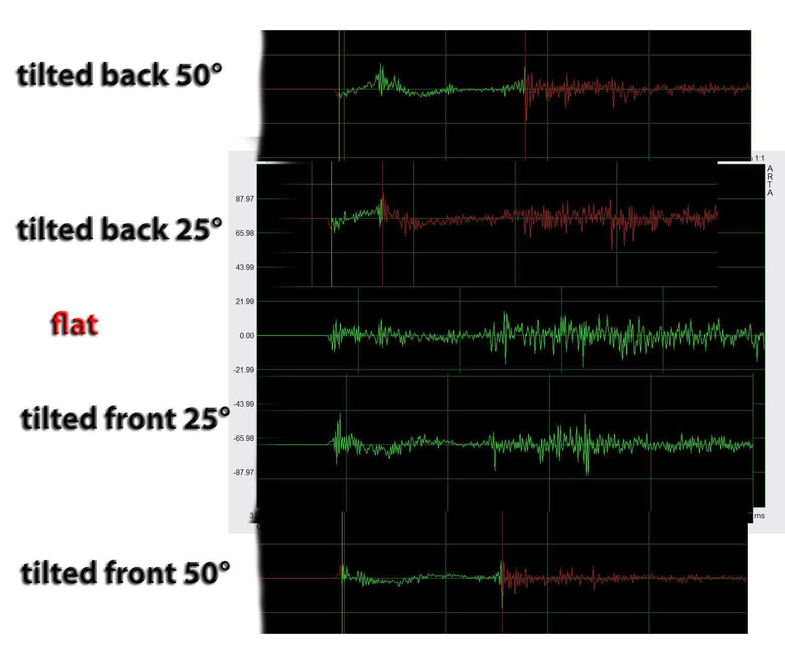

Third point : the IR variations.
The scale of the plot is 5 ms/square. Here it's now very different. As expected, there is a transfer of energy to the direct impulse when tilted frontward, and symmetrically a transfer to the first reflective surface (back wall) when tilted backward.
On the two extreme, the impulse tail is more clean and we recognize the side wall reflection (first neat artifact at around 8 to 10 ms). On the two back tilted, I suspect that the 100/400 Hz boost generates a big floor bounce (I forget to check this with the EQed one).
The curious guys (...) can DL the IR wav files, replace .zip by .wav

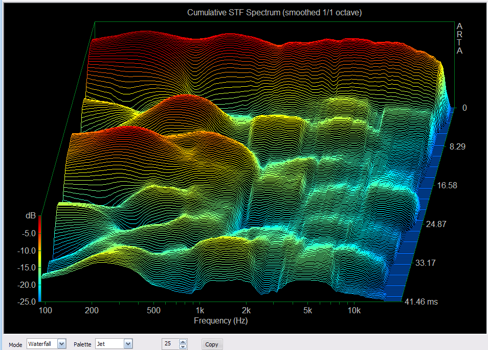

Fourth point : CSD
I admit that the flat position is not a beauty, but it's a comparative test. I don't have to comment a lot, the images speak by themselves.
Naturally, we see that the reflected impulse becomes more and more important.
From my subjective experience with the side firing, I can say that this reflection is predominant for the voicing of the system, could it be rejected at 20 ms. Maybe this is the breakthrough precedence ?
If I had to choose a sound between these five possibilities, no hesitation, I take the titled back 50°. The two ridges are grossly similar, well differenciated. The notch @ 350 Hz will be covered by the direct sound. The mega LF boost can be reduced (positively !) by less gain in the EQ.
The 25 front will sound harsh, the 25 back has little interest (where's the direct sound ?) and the 50° frontward is an horror. Strangely, this one is the closest related to a direct firing setup...😀😀😀.
All this being done for listening, I confirm that effectively the 50°/35° tilted back overruns the rest.
Please don't ask for polars...
