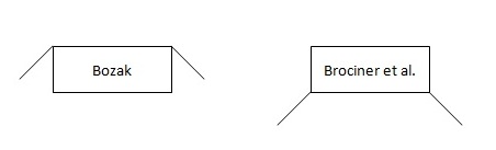

Bozak is certainly one of the greats! on the picture with Klipsch 😉
on the other picture the difference I see between Bozak's binaural (haven't seen this before - thanks for the link! 🙂 ) and Levy, Sioles & Brociner's deflector thing

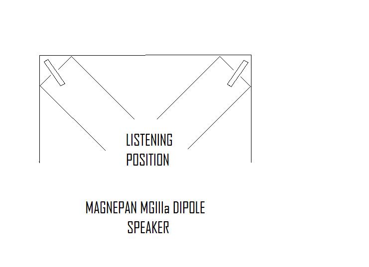

and another idea for dipole fans - hey Rudolf! 🙂 - that comes again from Maggies user's circles:
http://www.diyaudio.com/forums/full...ectional-fullrange-speaker-4.html#post1526321
pictures attached

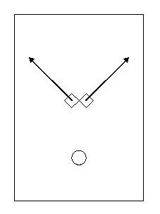

and here is another loudspeaker placement idea inspired by stereo sixteen:
What is it? What are the two squares and what are the arrows?
- Elias
squares are conventional front-firing stereo loudspeakers and arrows show direction and axis of the direct sound - the speakers are placed side by side and the toed out and to the back
I think they are more different than similar.
Bozak appears to mimic stereo triangle style presentation because reflections from cabinet doors are aimed to the listener and the width of the cabinet is comparable to the base of stereo triangle so direct sound dominates. Interesting is that with the reflective door one can have more directional pattern aimed to the listener than it would be possible just using a bare driver.
LSB on the other hand tries to prevent the direct sound from reaching the listener so it's a totally opposite style of signal presentation.
The Cardboard with the Pillow is similar to LSB.
However, what is the importance of the width of the LSB cabinet is unknown to me ?? In the pictures they look like at least 1 m or more.

Bozak speaker was around 1 m wide but I haven't seen any pictures of Levy-Sioles-Brociner bipolar speaker but is this really important? After all we are not trying to develop a product - a solution of a one-size-fits-all kind
we can all find our own ways of implementing this bipolar stereo - best suited to our rooms, preferences and available resources 🙂

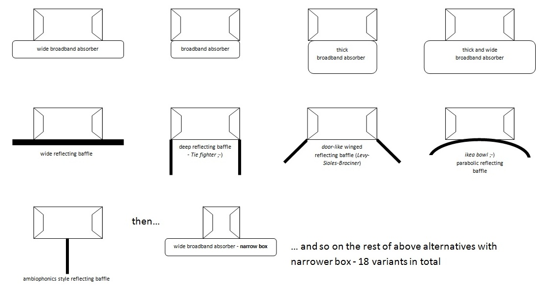

Does it really prevent direct sound? I don't think so because of diffraction. What you get is spectrally filtered direct sound. Best case, reflections add spaciousness and restore the spectral balance. The question remains, which polar response is desirable for a bipole center.
it's quite obvious for all:
Elias (...) surely a pillow is a low pass filter
can You post any frequency measurements of pillow effect - what part of the spectrum of direct sound is muted and how much?
