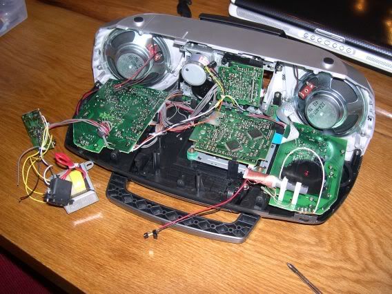

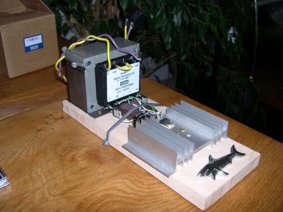

As promised I started to build PiTbull-Scaled-Down version for a good audiofriend.
This afternoon I will take the contraption to 2 other audiofriends...ohhhh...I am looking forward to the look on their faces when I start the Skeleton up.
at the moment I am listening to it without the 8V ...or is it V8 😎 power supply.

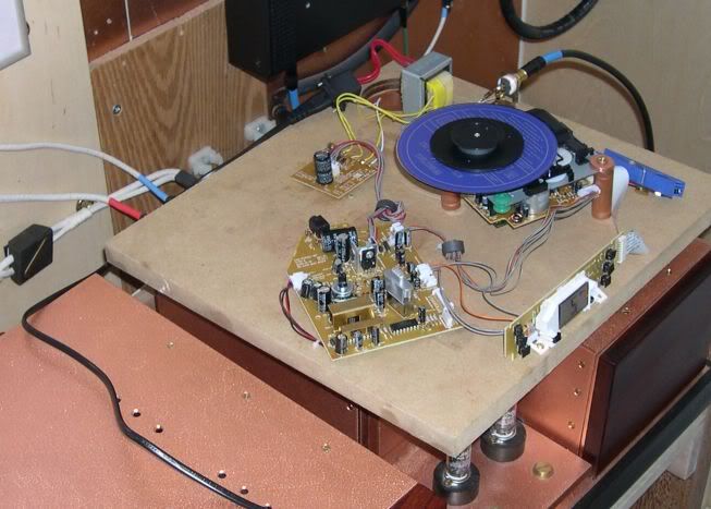

Its a day for coincidences - like you, today I am working on my next shigaclone! This will be a simpler one, basically the same as Peters "the CD transport".
It will be interesting to compare with my more modded one.....

Ok....
it's sitting on granite which in turn sits on damped springs,
reclocked,
using rf attenuators to knock the ttl signal down,
ero 1837 cap for c906,
ebony screw puck,
that's all I can think of right now! But I did many of the mods through the thread as it progressed.

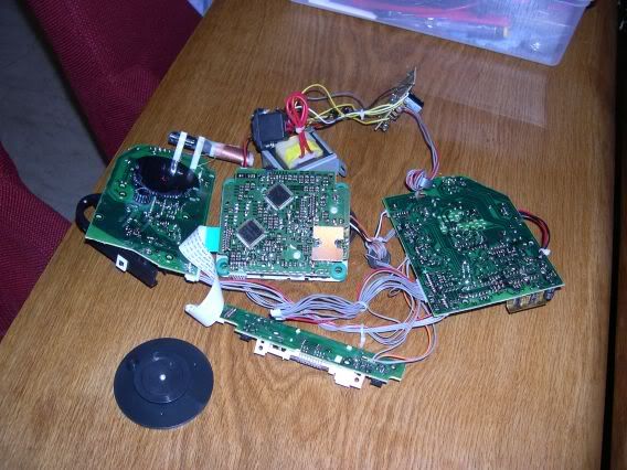

Hello all,
Yesterday I taken apart a new Boombox and is now playing, and this one is not better than my full modification Shigaclone at the moment.
This I have changed look at this PDF file so you know what I talking about: http://tim.cheapo.cc/images/CD%20player%20mods.pdf
R4 and R5 I removed and 2 smd caps 3 and 4
E5 removed and a 2 x 33uF Blackgate N super E-cap there for in place.
No jumper from 5A to 5B the print was intact.
Power supply:
1000uF FK Blackgate LM7808 1000uF FK Blackgate, about the last one I have no more Blackgate STD so I used the BG FK.
